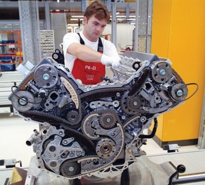

This shows an S4 engine, but the chains are almost (exactly?) identical on the RS4 engine.

4 chains or something? I've heard of them being replaced if the rattling gets too bad. Something like 2k in parts alone
