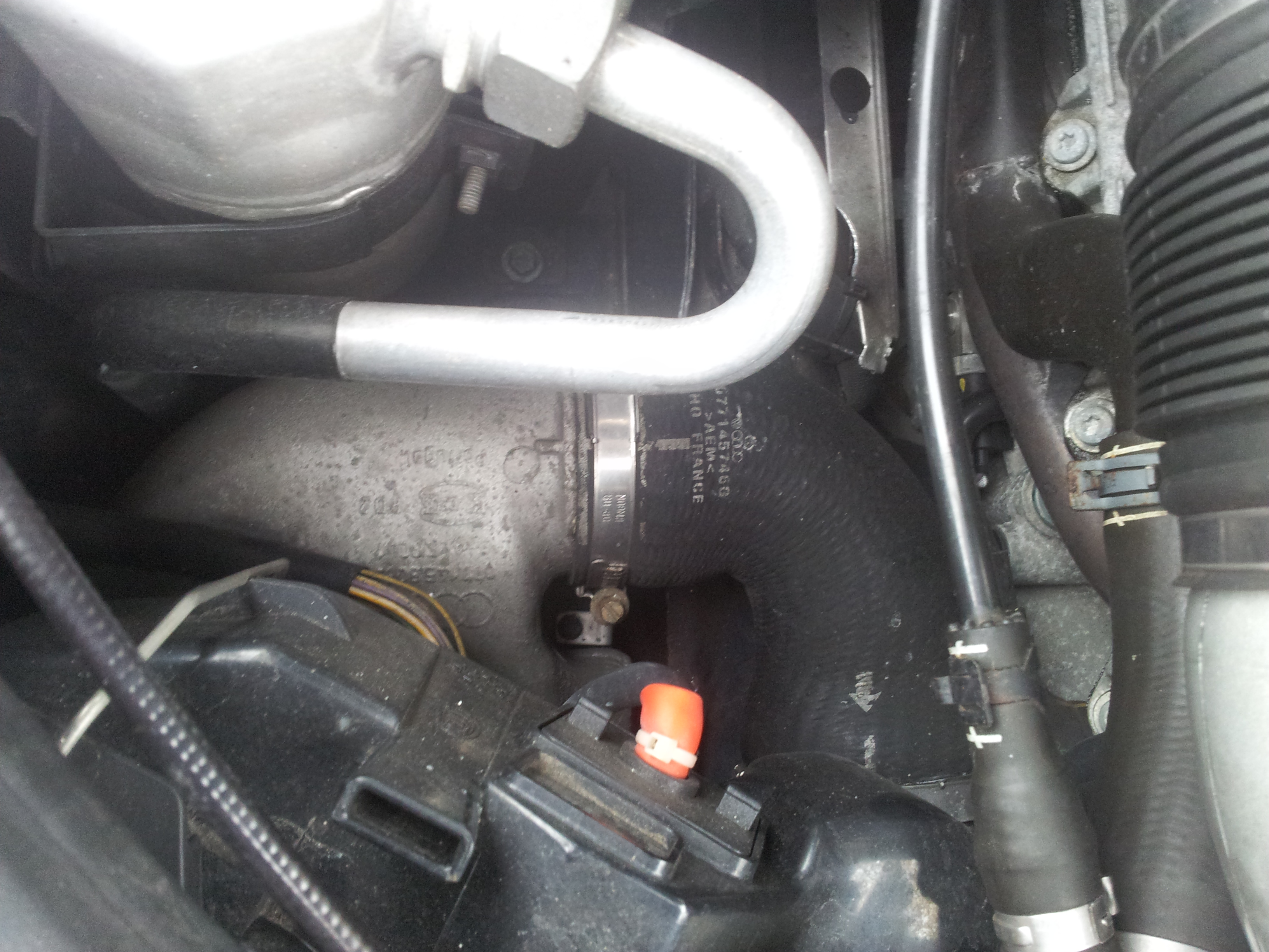

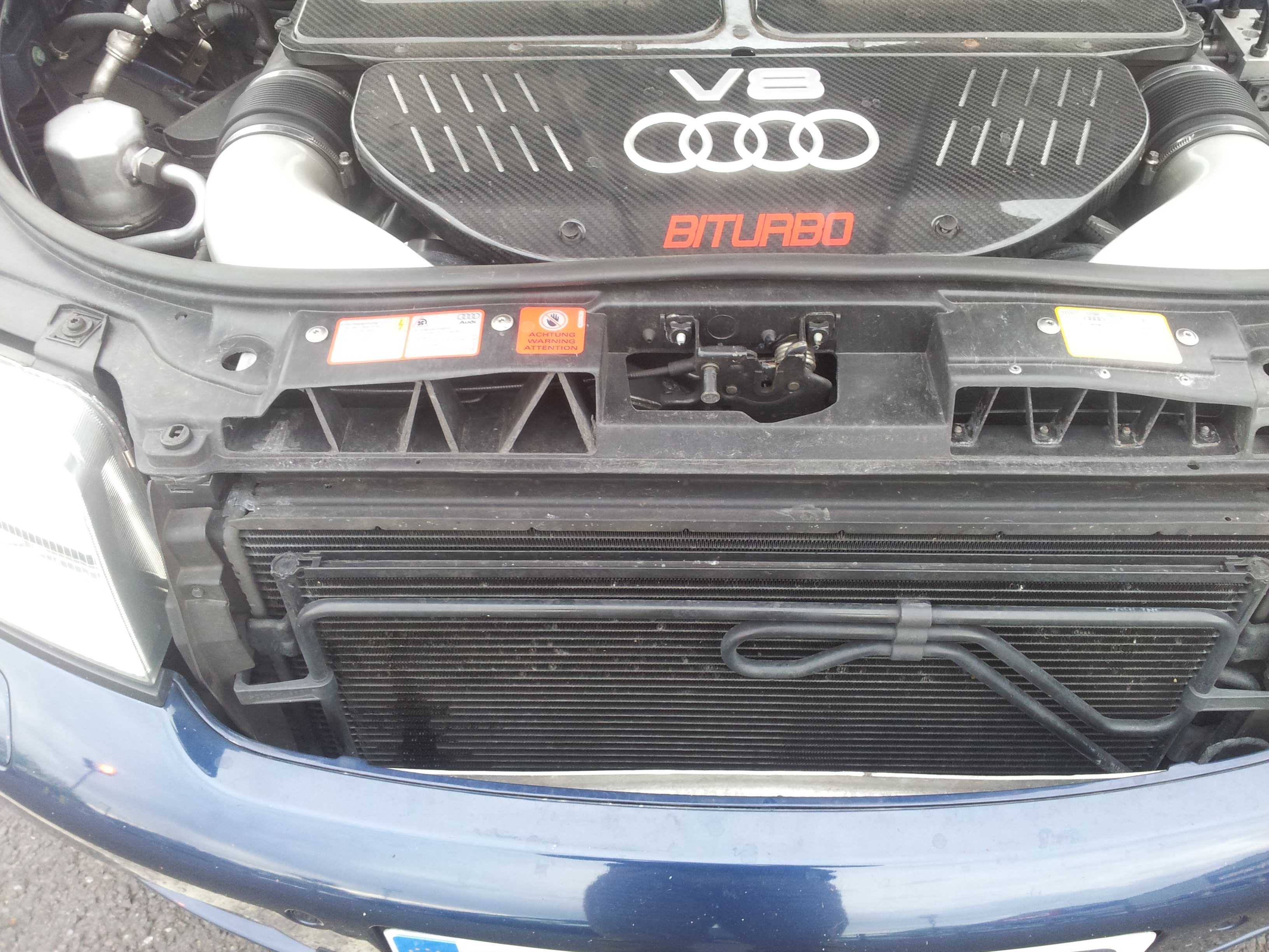

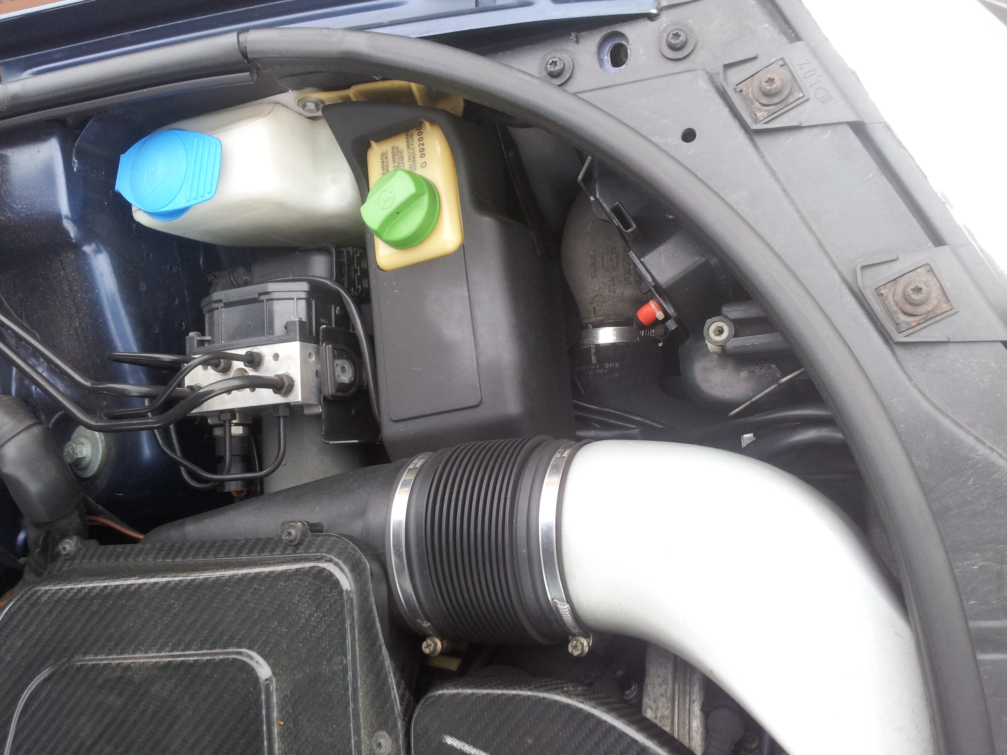

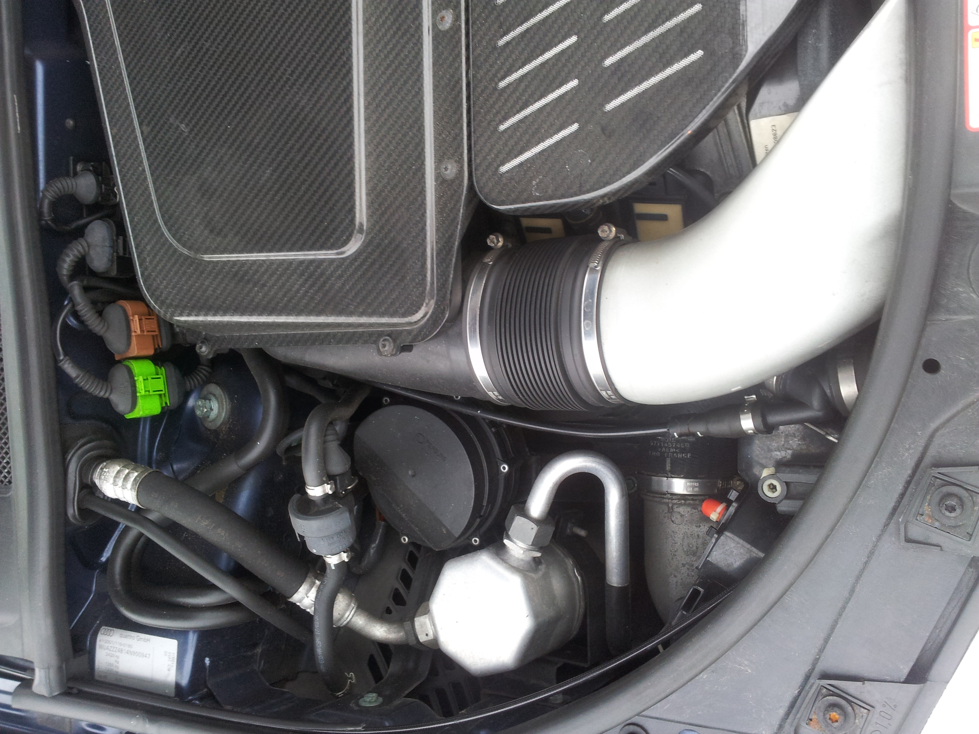

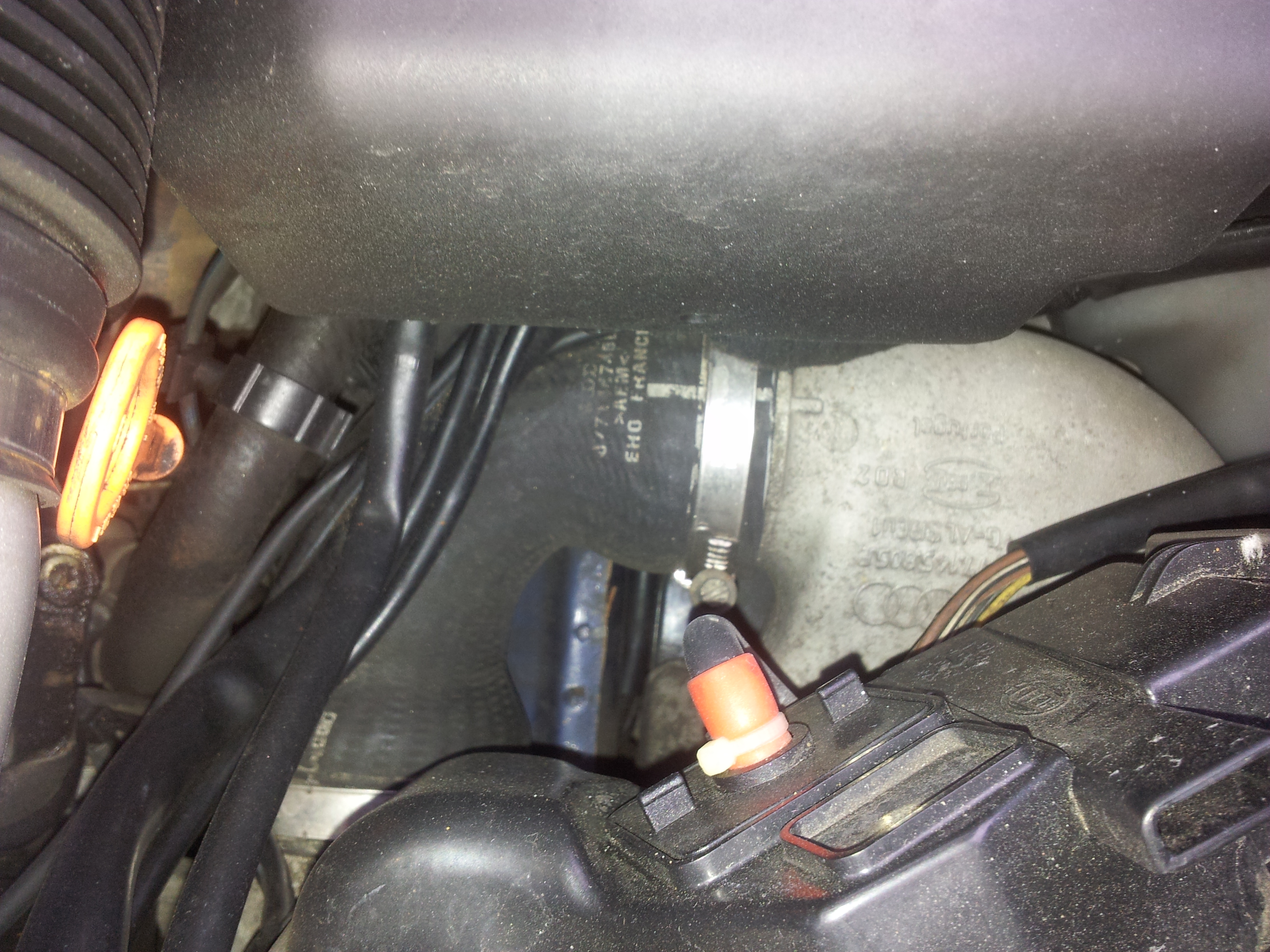

Right ok..enough is enough..i don't like the paucity of knowledge i possess about my engine bay..i have just been to halfords (yes i know) to buy a funnel and i can now hear a whoosh so i am sure a hose has come loose so i turn the engine off and pop the bonnet...now a jubilee clip i can cope with so i pretended to know what i was looking for and did some checks( like clarkson testing the Veyron tyres ) and grabbed things muttering " well that seems ok" and for the life of me i could not find a loose hose..could some awfully kind soul point out or annotate below and point out the main culprits and yes there is swiss cheese leaking... :audibash:

If you are referring to the last photo, that is your radiator not your intercooler. The intercoolers are behind the fog grills, I contacted Mark at Wagner Tuning and he is yet to get back to me. If you are doing the group buy it is worth going to Wagner direct rather then pay a middle man. You can contact Mark via SRS or the Wagner Facebook page. I'm not in on the group buy for the time being, so you guys feel free to carry on.

yep ..havent posted the intercooler pics yet...the reason for the last pic are to ask what is underneath the box if I press the 2 buttons with press on either side of the "biturbo" lettering. I havent yet but will get to learn the contents of that bay..

Could it be a bottom intercooler hose??? Pretty sure this is a usual suspect.

Post by bam_bam » Tue May 08, 2012 8:18 pm
The intercoolers have a top and a bottom connection (they're getting spit-roasted). I'm not sure you can see the bottom connection points without removing the engine tray and lifting the front-end to have a squiz. I could be wrong.

i just changed my hoses for the wagners hoses, the bottom ones were very soft, and i reckon not far from splitting. it's definately wortha look doc, and bam is right, the belly pan will have to come off.

Post by cfcdoc » Tue May 08, 2012 9:02 pm
swannny wrote:i just changed my hoses for the wagners hoses, the bottom ones were very soft, and i reckon not far from splitting. it's definately wortha look doc, and bam is right, the belly pan will have to come off.
Oh well, i dont have a ramp or jacks, looks like MRC it is...
