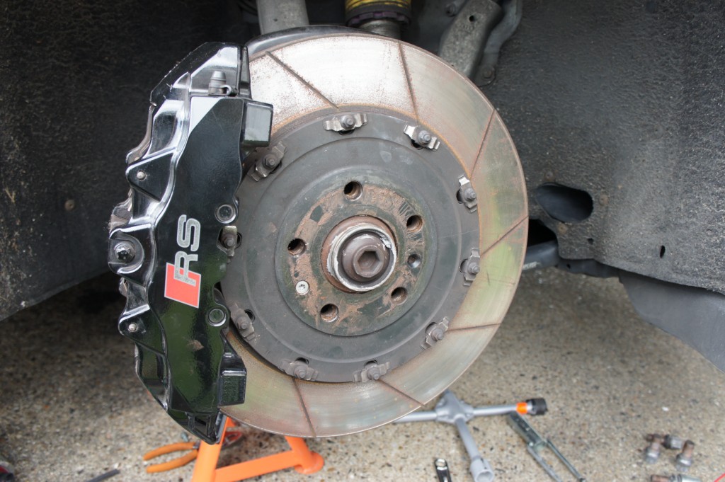

Im running Phaeton discs at the moment and they seem good. As above you need B7 bells. Heres mine on.

Re: Front brakes
Cant say what the part number is, I purchased these discs already set up with the bells and engineered grooves in. Many have done the conversion on here including the C5 RS6 crew. Using old bells is fine, make sure all the nuts are done up (not sure if you would need new bolts or not?). As above make sure you use new pads.api330 wrote:They are a lot worse so it was a poor job done with out a doubt, So i would have to use my old bells then and is that ok to do ?, Would you have a part number or the exact model I would need to order them (so i can have a look on ebay at prices) and if your saying your having no problems with yours and they work well then i may buy a set, Thanks for all the info i am getting it really does help, Tim
