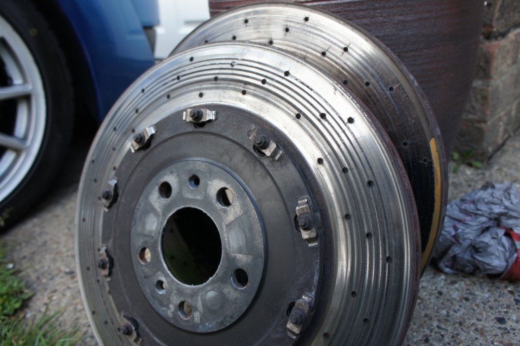

Poor design what makes you say that :lol:
