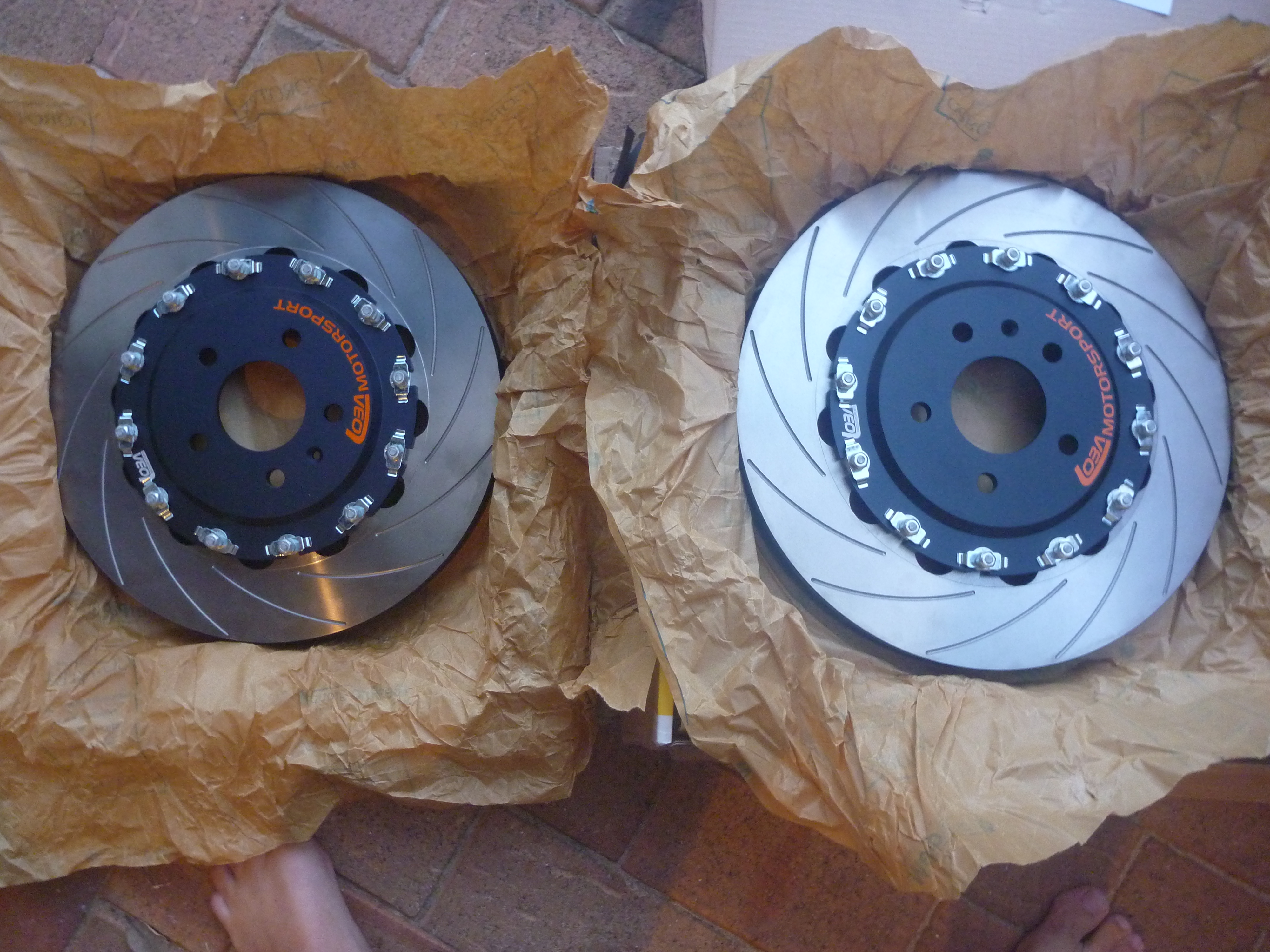

Great post Sonny,
And perfect timing as these were delivered today!!!!!!!!!
To be installed later in the week.
Greg

Post by Timster » Mon Apr 16, 2012 12:08 pm
Oooh, they do look very, very nice.
.... watch your toes..

Post by P_G » Mon Apr 16, 2012 2:47 pm
shinz wrote:Great post Sonny,
Greg
Those do look tasty. Do they do rears in the same pattern now? Supersi?

Post by adsgreen » Mon Apr 16, 2012 2:53 pm
They look absolutely great - definately my choice for replacements.
200nm - thats like 150lb/ft... thats way beyond fookin' tight!
Amazing it doesn't strip the bolt/thread!

Post by supersi » Mon Apr 16, 2012 3:09 pm
Greg
the issue is the rear callipers as it only allows a 22-21 mm thick disc from memory, so is very limiting there as AP racing don't do a rotor is that size, we can do a calliper upgrade and then discs but becomes costly, on the plus side the B7 rears callis would sell to the B5 boys to offset price.
