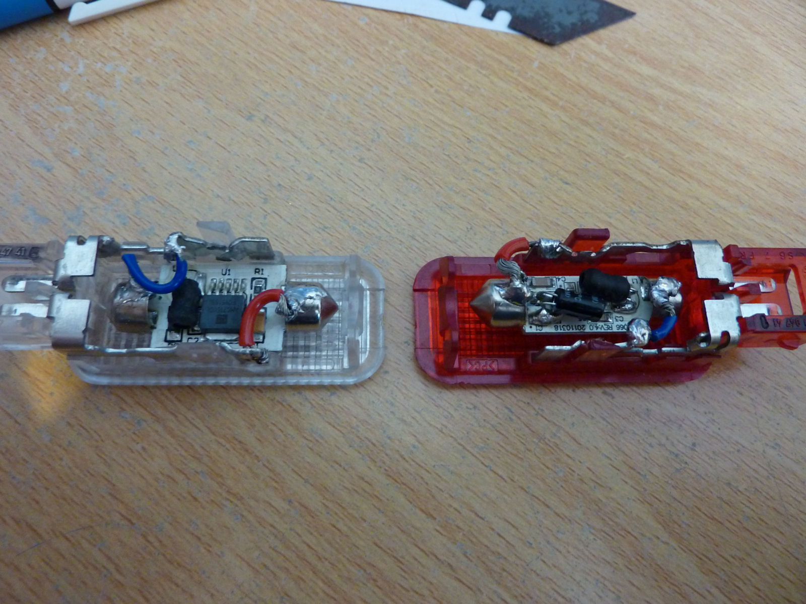

Bah, the mod urge couldn't be suppressed. After trying the modded 3LED glovebox light in the bottom of one of the doors tonight I have ordered another 4 6LED 37mm bulbs to do the bottom door lights and 4 3LED 37mm bulbs for the red door lights. After checking the bootlid one to see how pinky the red reflector/light goes when a strong enough LED is shining through it, I think with the 3LED ones and a couple of spacers between them and the lenses, I should get away with a fairly red, but bright light

Ok, have made up 1 of each door type for testing tonight. I am expecting the light through the red reflector to be quite pink and despite floating the bulb to raise the height from the lens without spacers that could possibly be seen from outside, still pretty sure they will be a no-go:
Since that photo was taken the floating one is secured with hot glue at either end (can't see it on the reflector side) so will be perfectly robust for door shutting.
For the 6LED whites in the bottom lights, you do have to shave the sides ever so gently to get a perfect wedged in fit. These are set a few mm above the lens just incase these do actually produce any heat. The floating one in the red light is about is at about 6-7mm above the lens but still don't think it will be enough. Tonight will confirm it and then I will only need to buy 1 new red light. Going to do all the bottom white ones, no brainer.

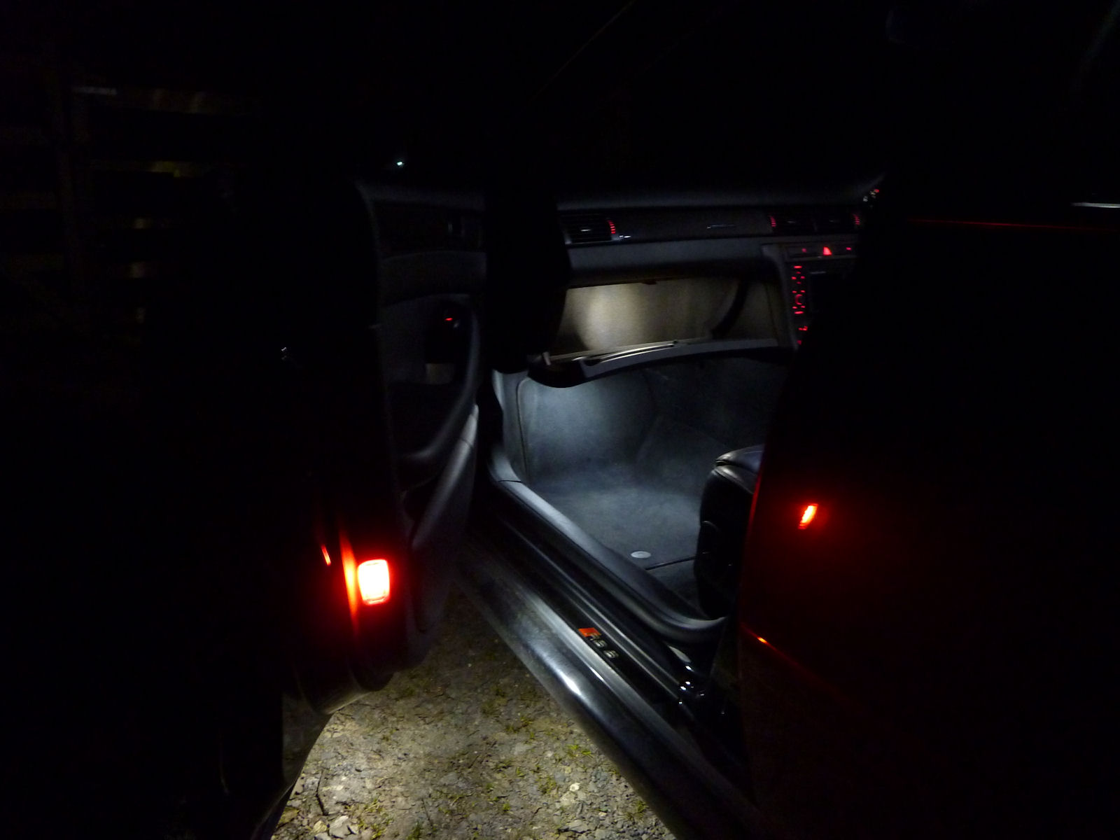

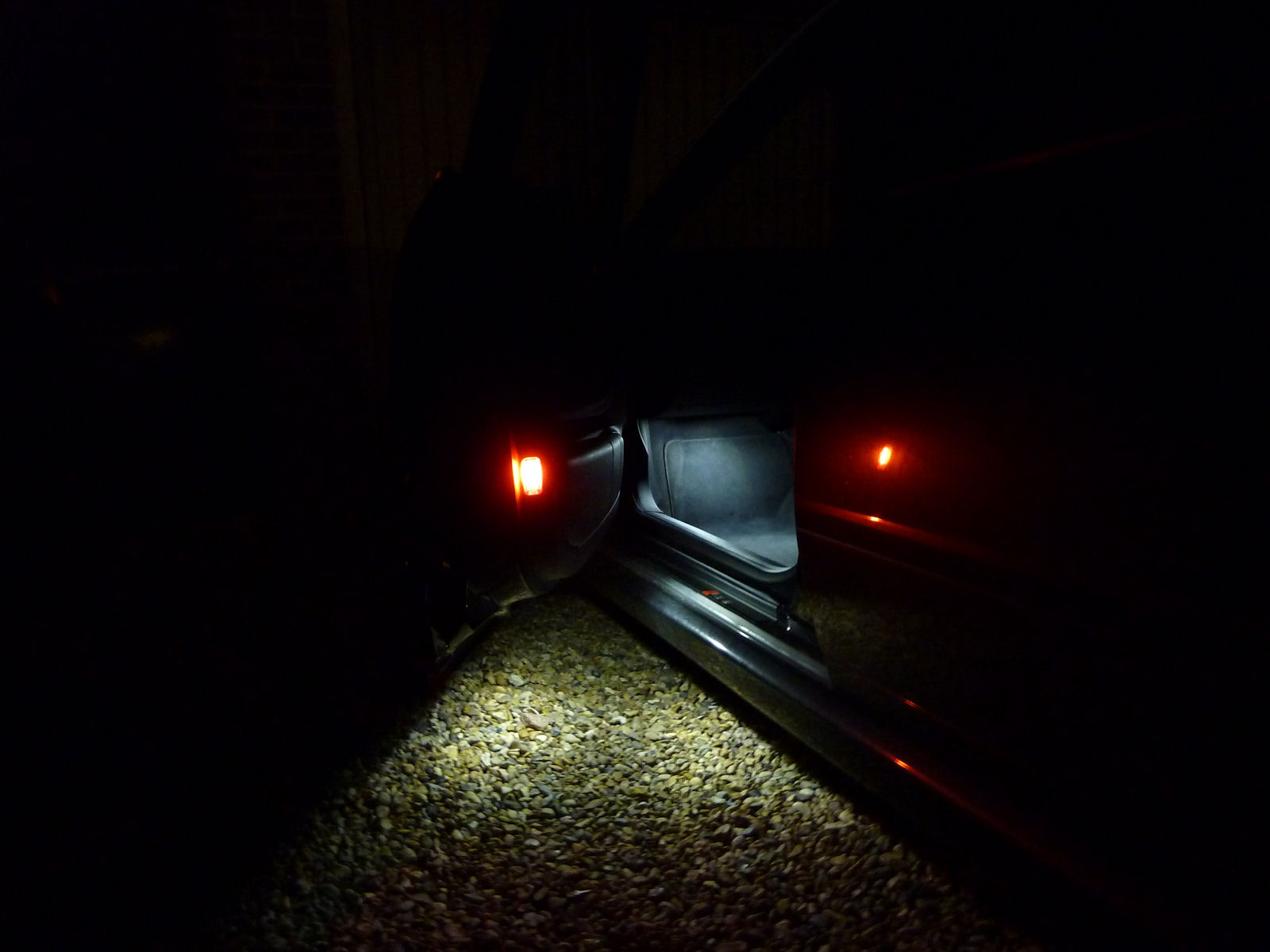

Ok, put the new pair in to the front passenger door so I have 2 comparison shots. Looks like the floating bulb has worked as the result is a fairly brighter light without being a much lighter shade. The pictures don't really reflect the increase in light from the red light but the reflection on the car does a bit. The footwell lights are identical shades, just the camera not capturing them properly.
Normal bulbs in driver door:
Modded white/red lights in passenger door:
Sod it, I already have the bulbs on the way so it's only another 6 to make up........

Re: LED Interior lights
That looks MUCH better, I like subtle little enhancements like these. I will be doing the same when I have the time.

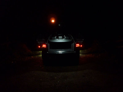

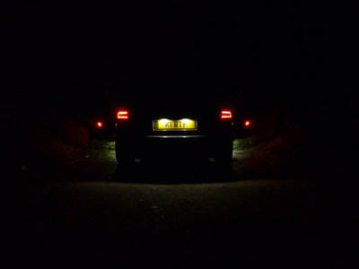

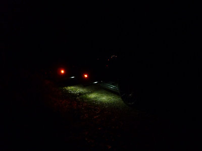

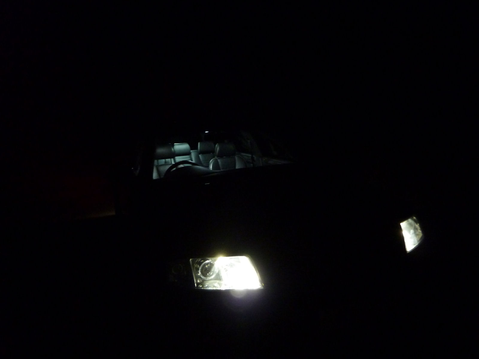

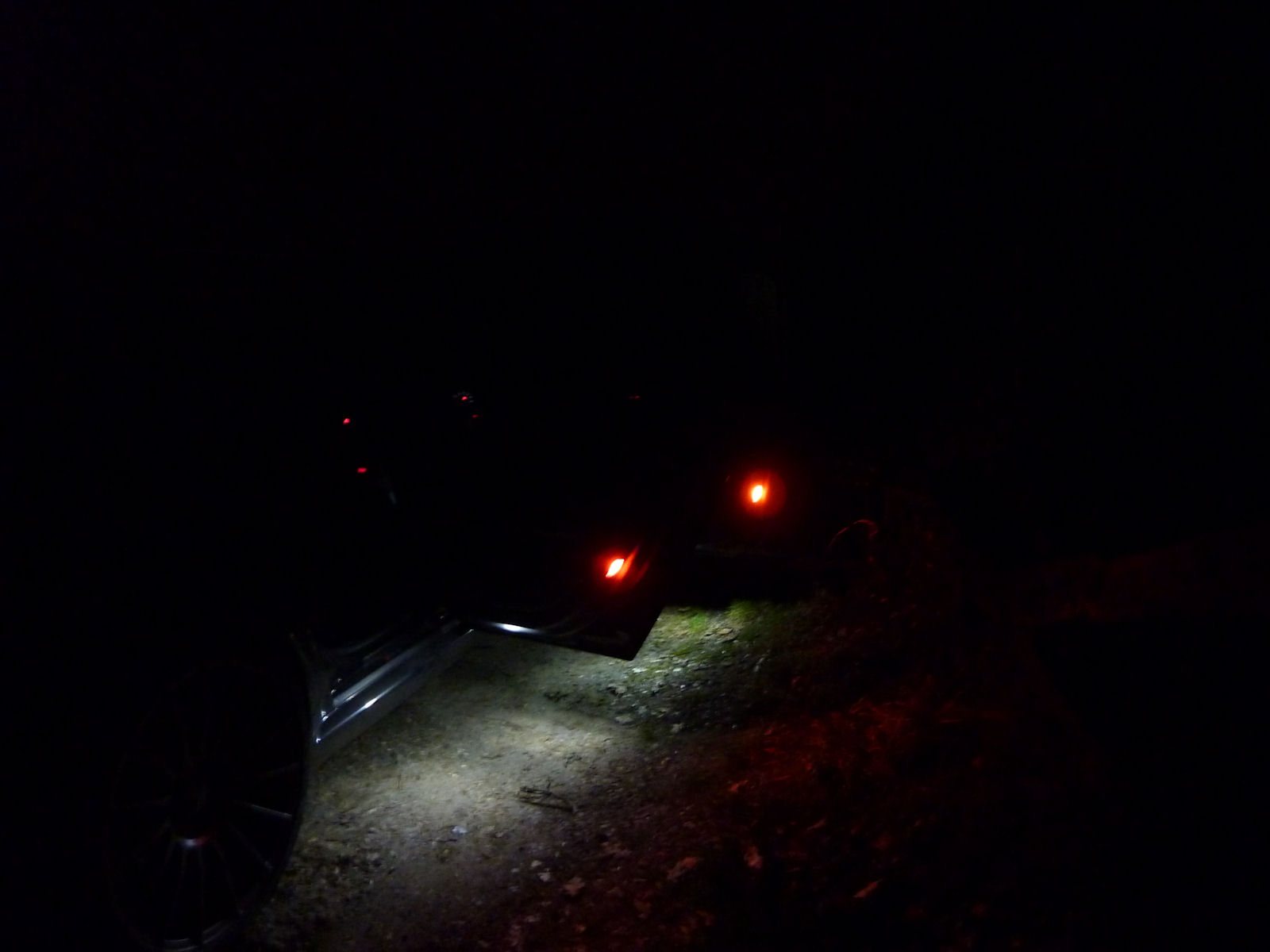

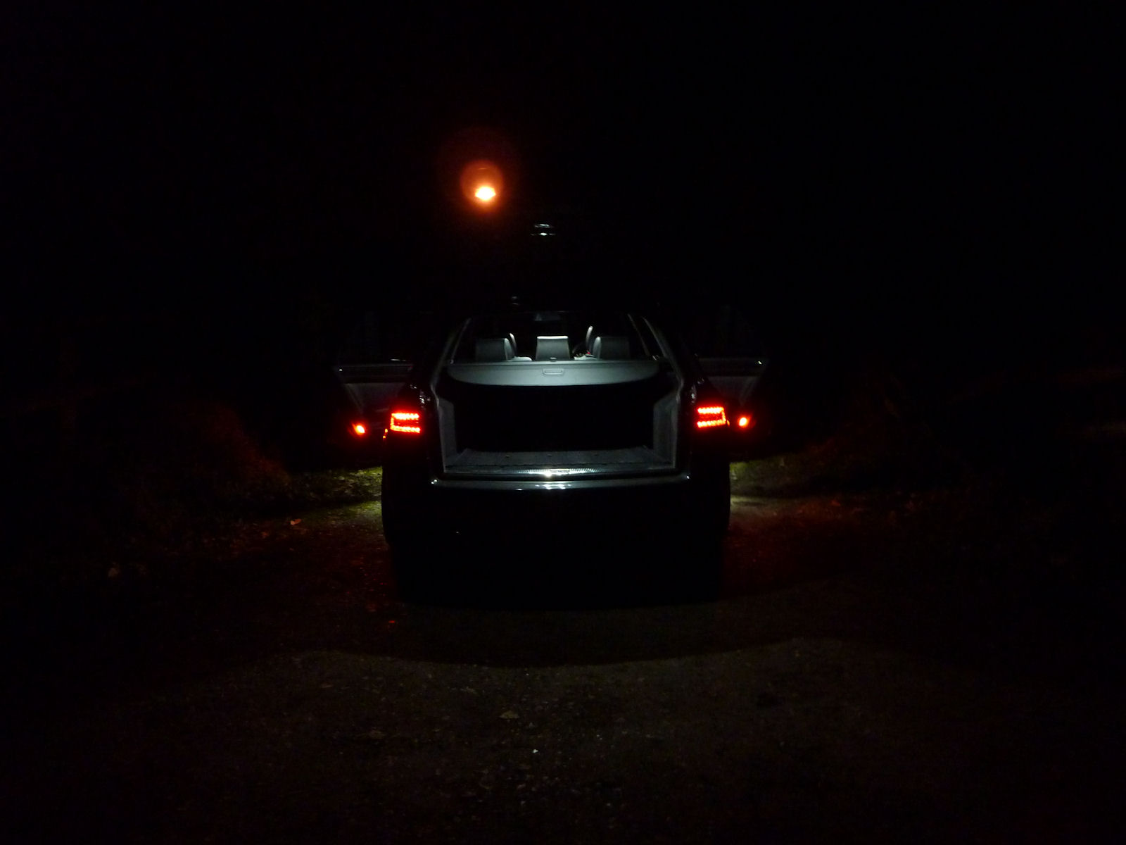

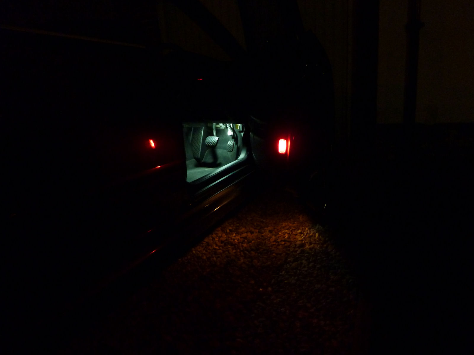

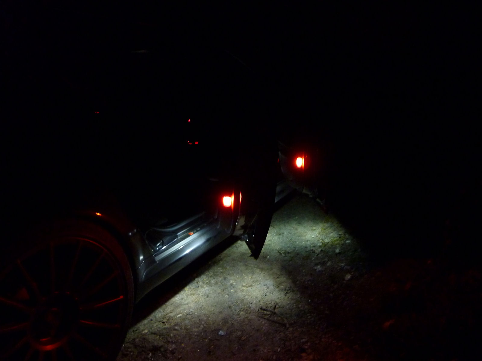

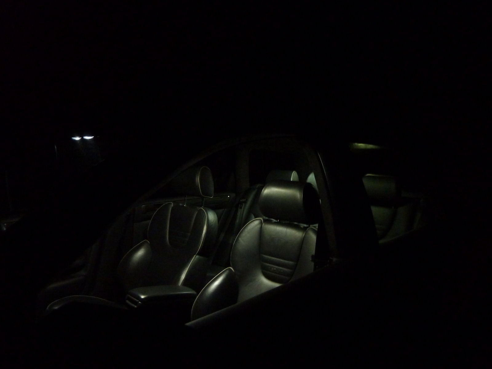

For those that care, this is how much I love you all/how sad I am. Just come back from trying to find somewhere totally pitch black to take what are final pics of the end results for the led mods (bar the reverse bulbs turning up tomorrow and then the fogs at some point).
Here you go, just have to ignore the various shades that the camera decides to do the lights in at the time...
