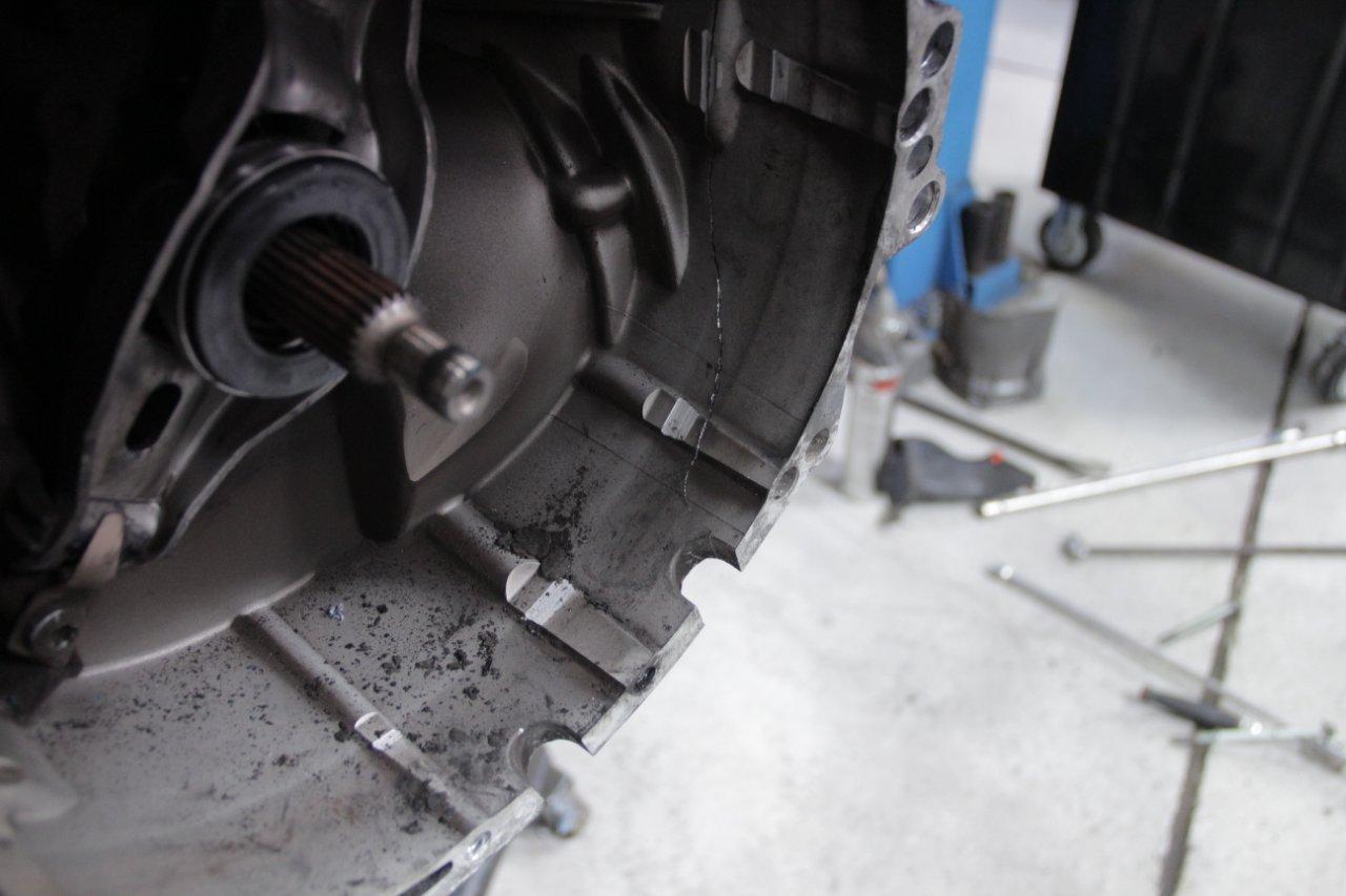

took the RS4 to the Audi dealership and they've come back with a cracked bell housing and will have to wait until they get the gearbox out to see what else is up!!!
I've had a look and a google search about this and it seems it might be the flywheel that has caused the crack and vibrations.

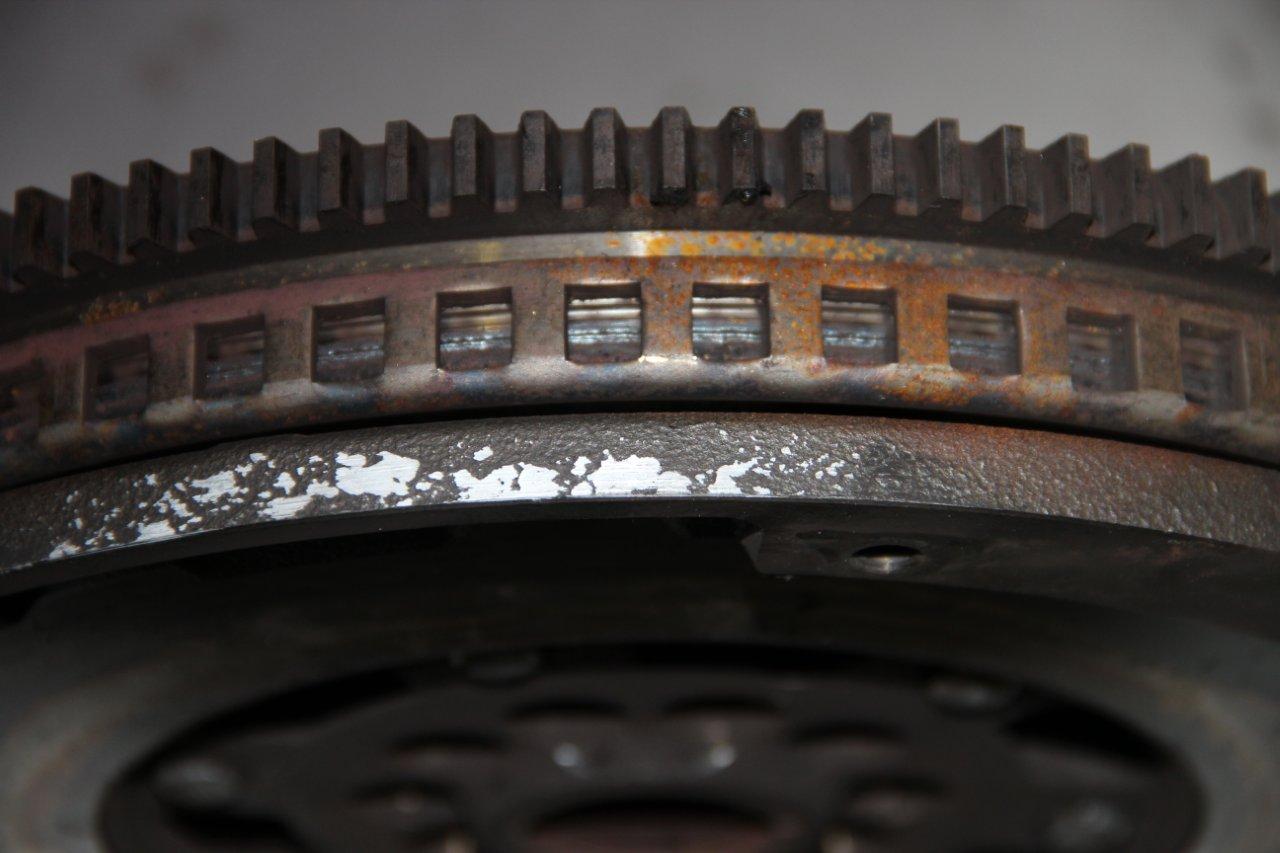

Have spoken with a technician and looked at the now removed gearbox. The bearings in the flywheel disintigrated causing the flywheel to smash into the beall housing and break it!
Has anyone ever had a similar problem and was it covered by warranty? The clutch was worn down but i hadnt notice any slippage, and the cluch plate had changed colour to a reddish colour, the technician said this is due to lots of full power launches... whilst i drive the rs4 heartedly i dont really do fast launches from standing. from the tone of the conversation, i get the feeling the warranty company might use this as an excuse for not paying...

This is not that uncommon.
The dual mass start to stretch the strap inside and then the outer section of FW cahtters on the bell housing - and will break it. It feels like a misfire but doesn't sound like a misfire.
The gap is too tight from FW to Bellhousing.

Went to take a look at the damage. the flywheel bearings disintigrated, causing the fly wheel to crack right round the bell housing and even remove a chunk of it.
Audi warrany will cover the damage, though i need to pay for excess and new clutch as it was worn right down and now seems a good time to change it. So 9 monthis in to buying a new warranty for 2k and wondering if it was worth it, i am now convinced it was a good choice.
