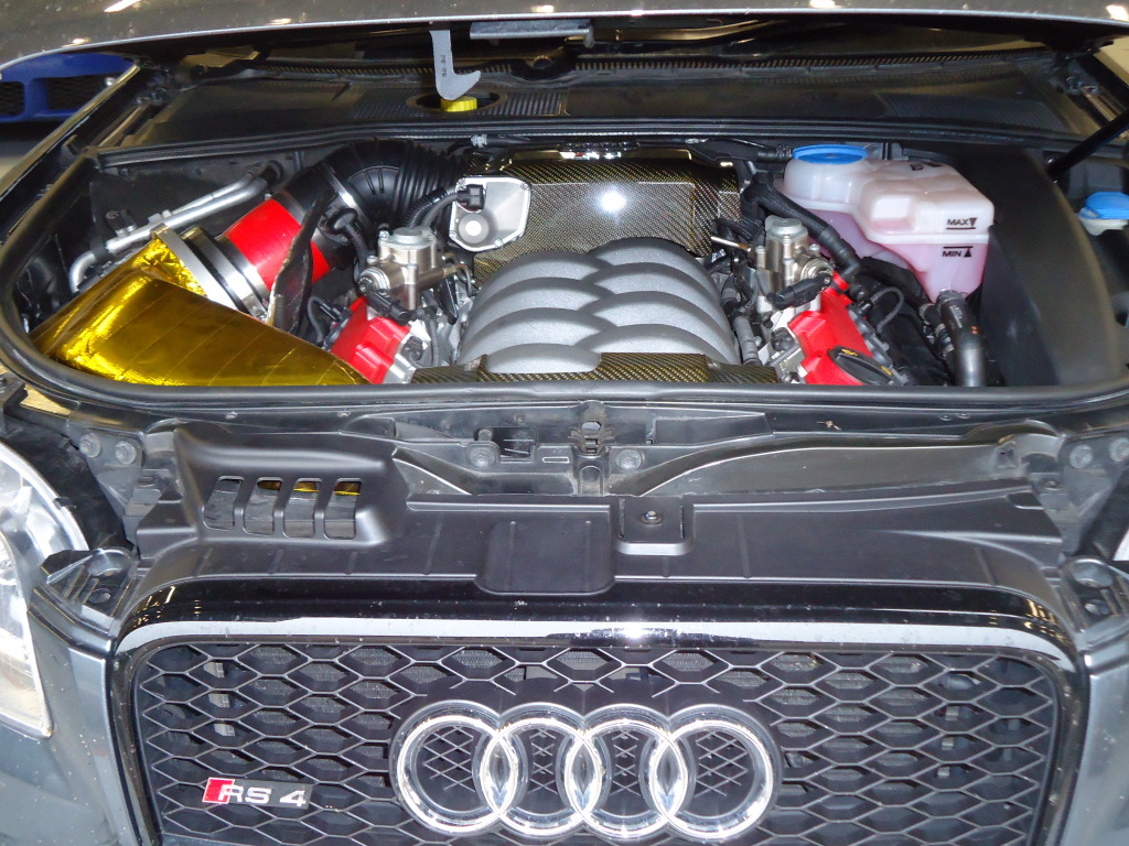

Warm air getting into the induction system is the biggest factor, the MAF senses this and retards the timing, anything from 20bhp can be lost. I took massive measures to preserve the cold air. So had fitted a CAF, heat shield and heat wrap for the system, and it cured about 70% of the warm air.

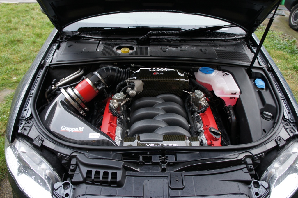

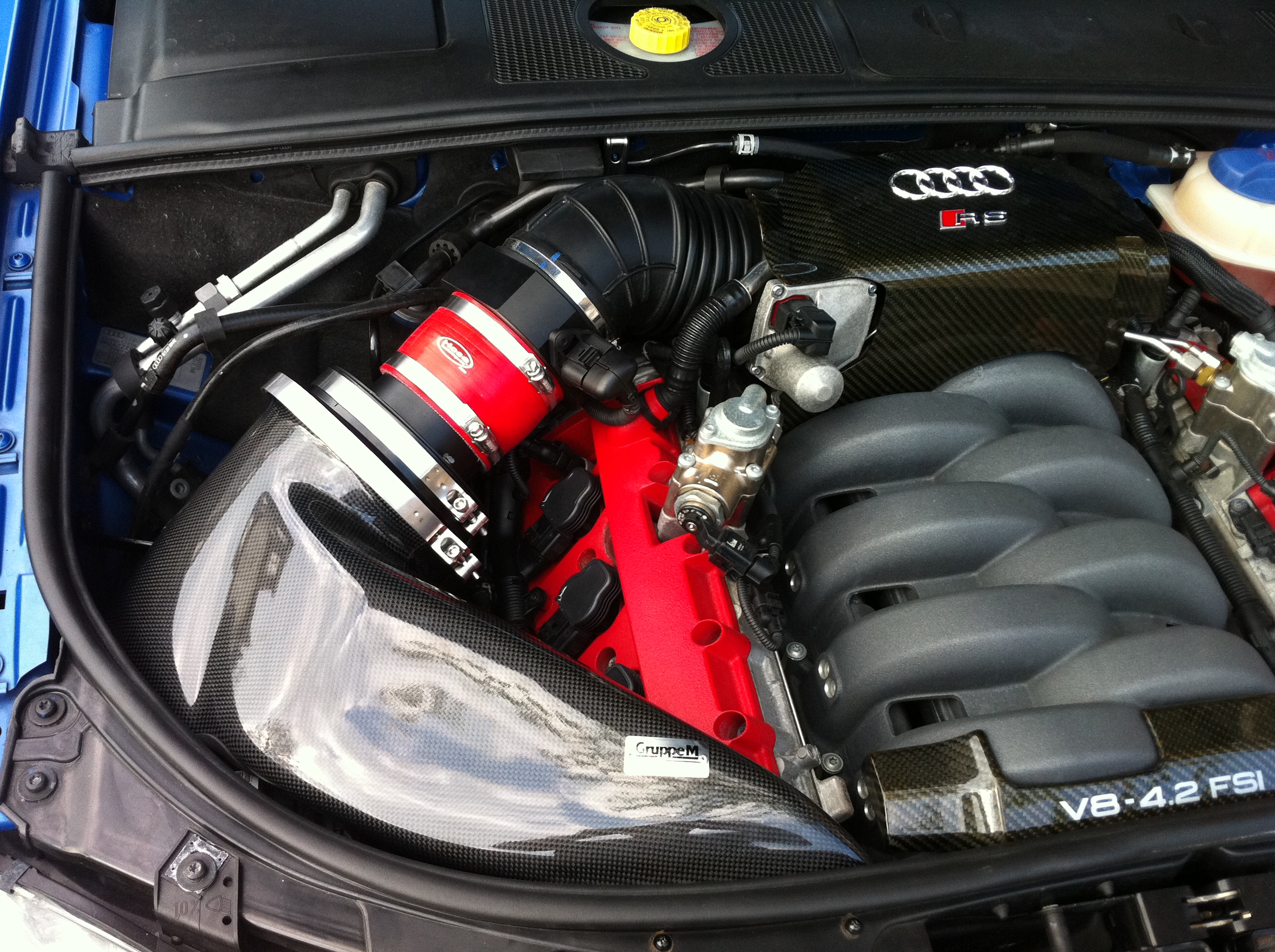

I think you both forgot to mention how amazing it looks :rocker:

ok if you must..

do you think a shield under the MAF body and oem intake tube would make any effect on readings, i was thinking about fitting one as its above the exhaust manifold, possibly wrap it like a turbo wrap?

Did you read the thread I did Rick about the heat management for the GruppeM? http://forum.rs246.com/viewtopic.php?f= ... eat+shield
