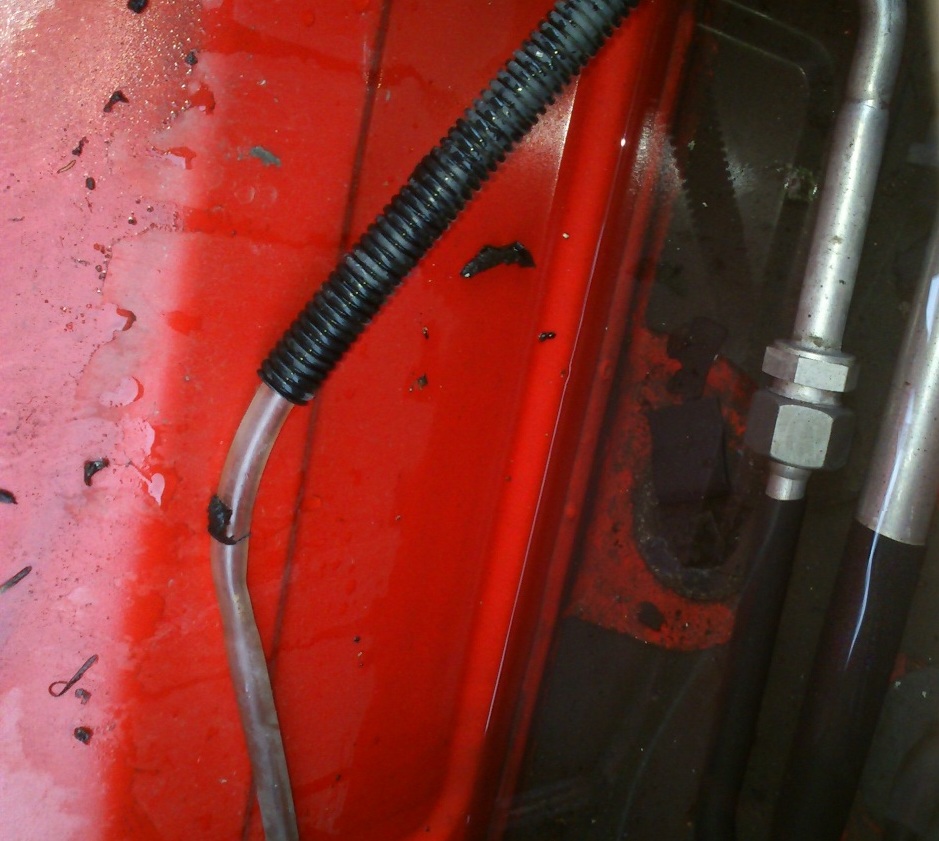

Post by SpeedJunky » Sun Dec 04, 2011 3:54 pm
Ok, you were correct, so many thanks....look at the state of my grommet under the battery...!!
Blocked Grommet....
3 or 4 inches of water under my servo....
Water under servo
After a nice clean though.... :)
Cleared.....
I know my pics only show the grommet under the battery, the one under the servo was a git to get to with my hands, so I got the missus to get her hands dirty for a change....she did a fine job!!
So many thanks for your assistance!!! I have taken out my rear seat and front passenger seat now, lifted the carpet, now an overnight drying out process with a fan heater from B&Q! :)
