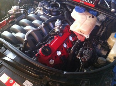

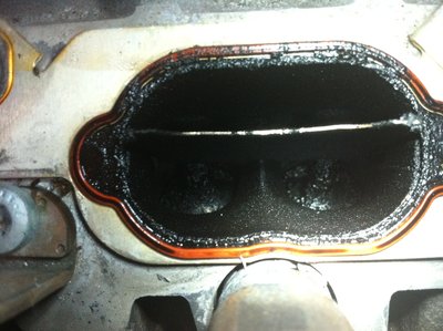

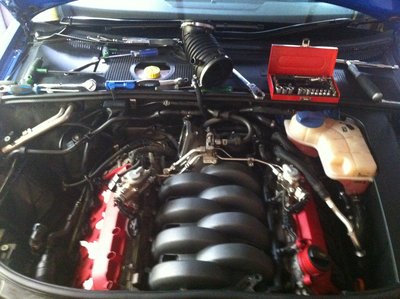

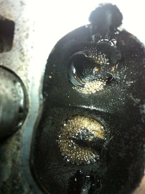

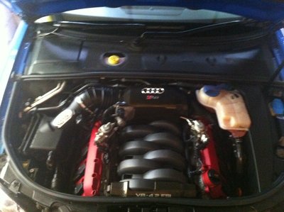

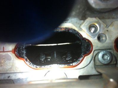

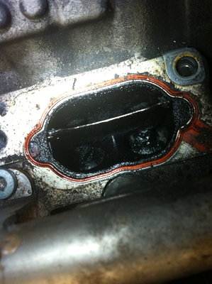

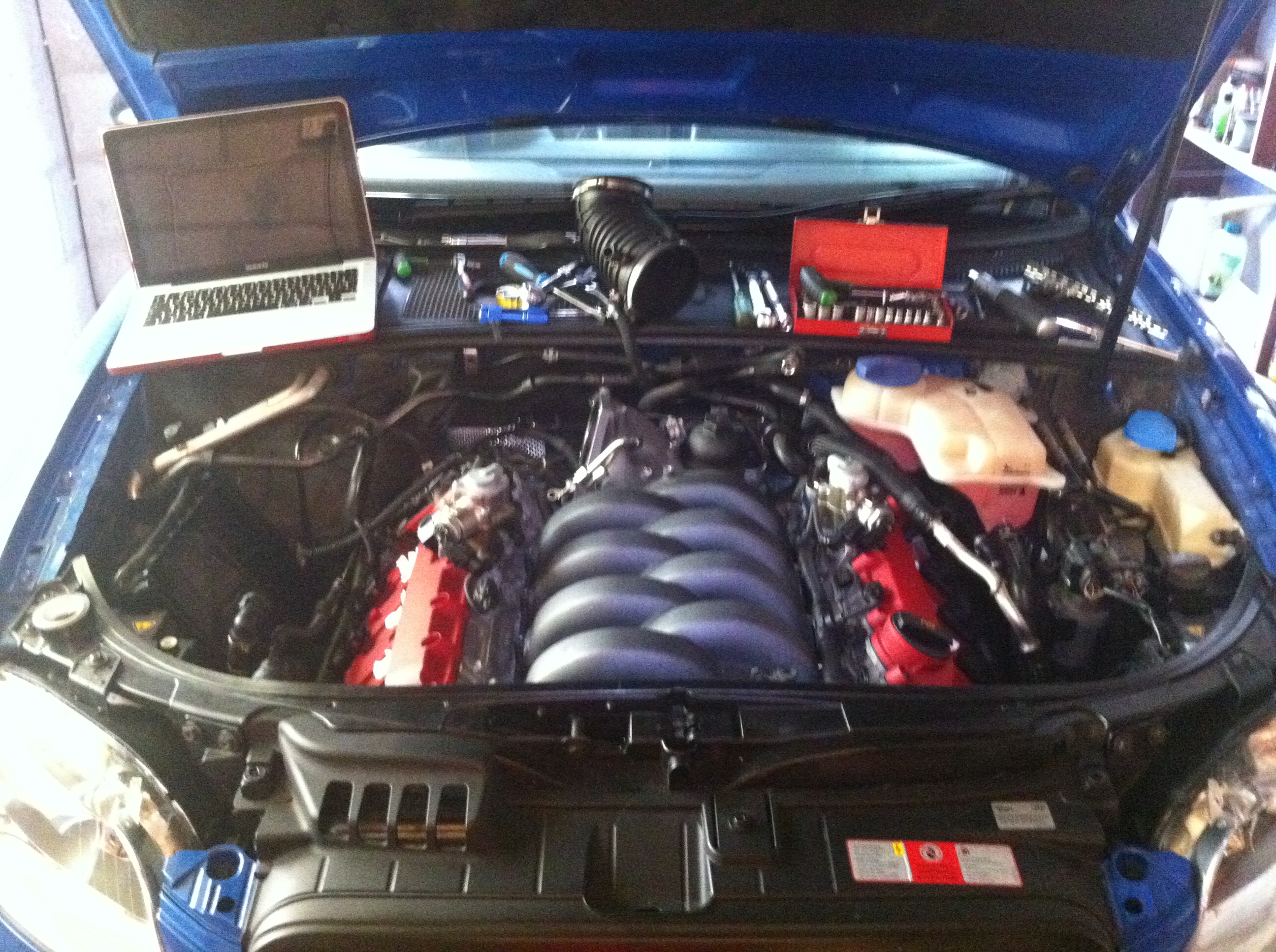

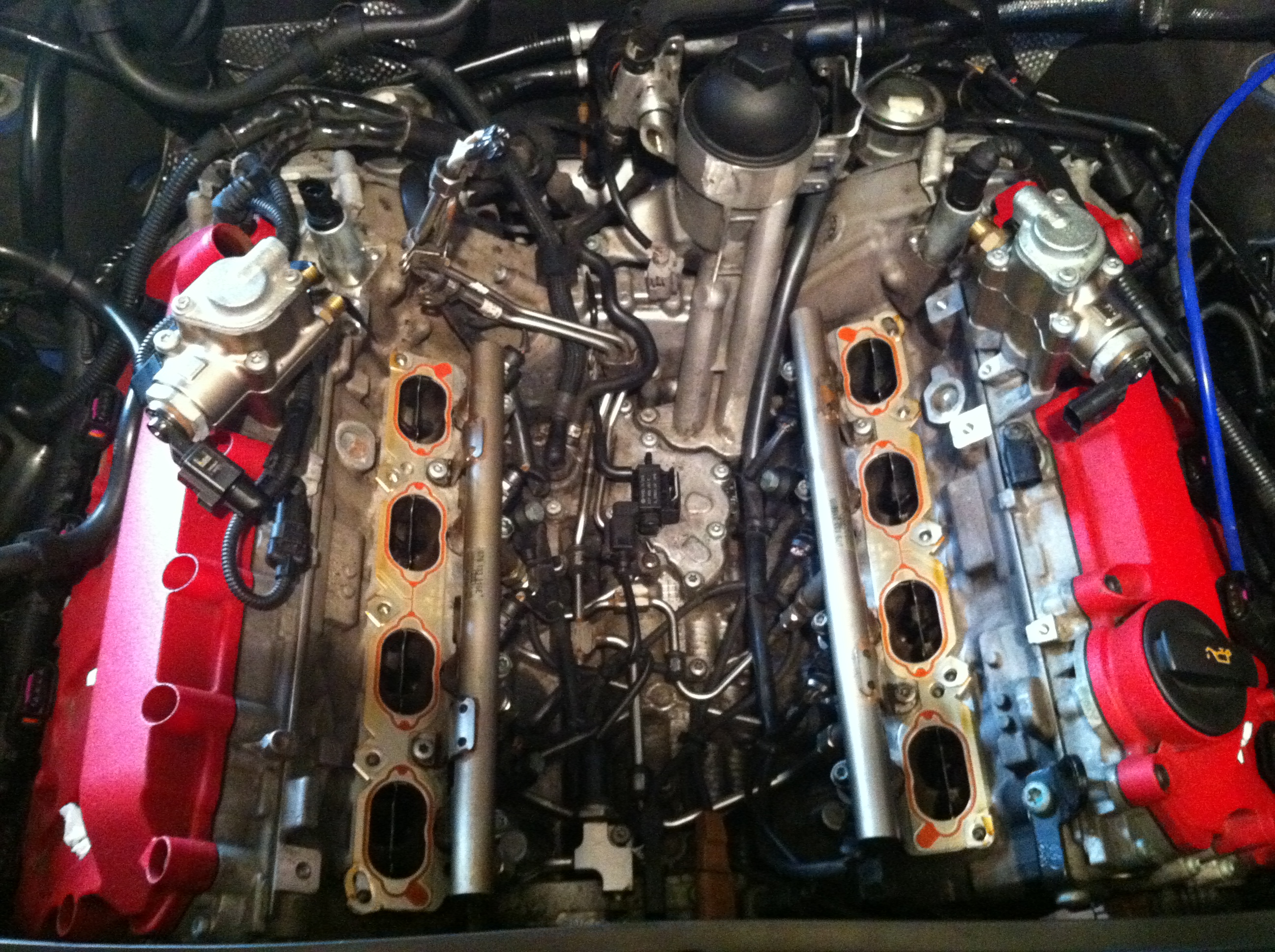

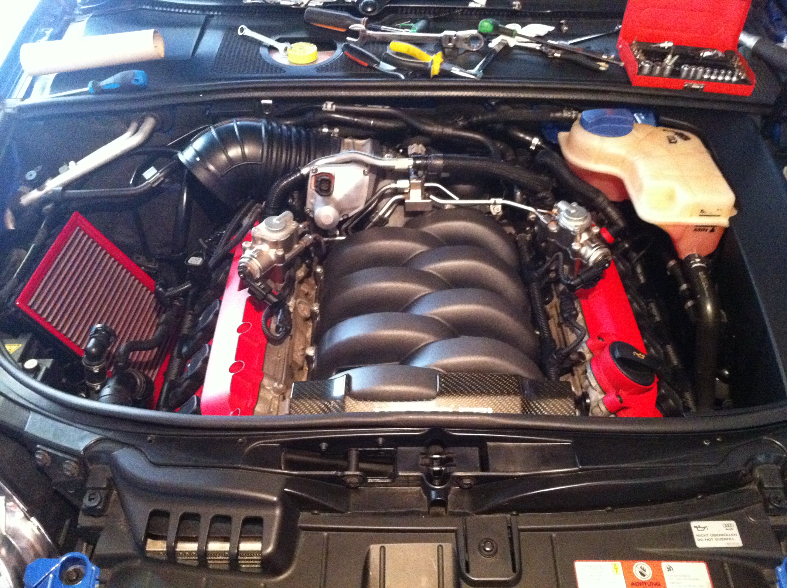

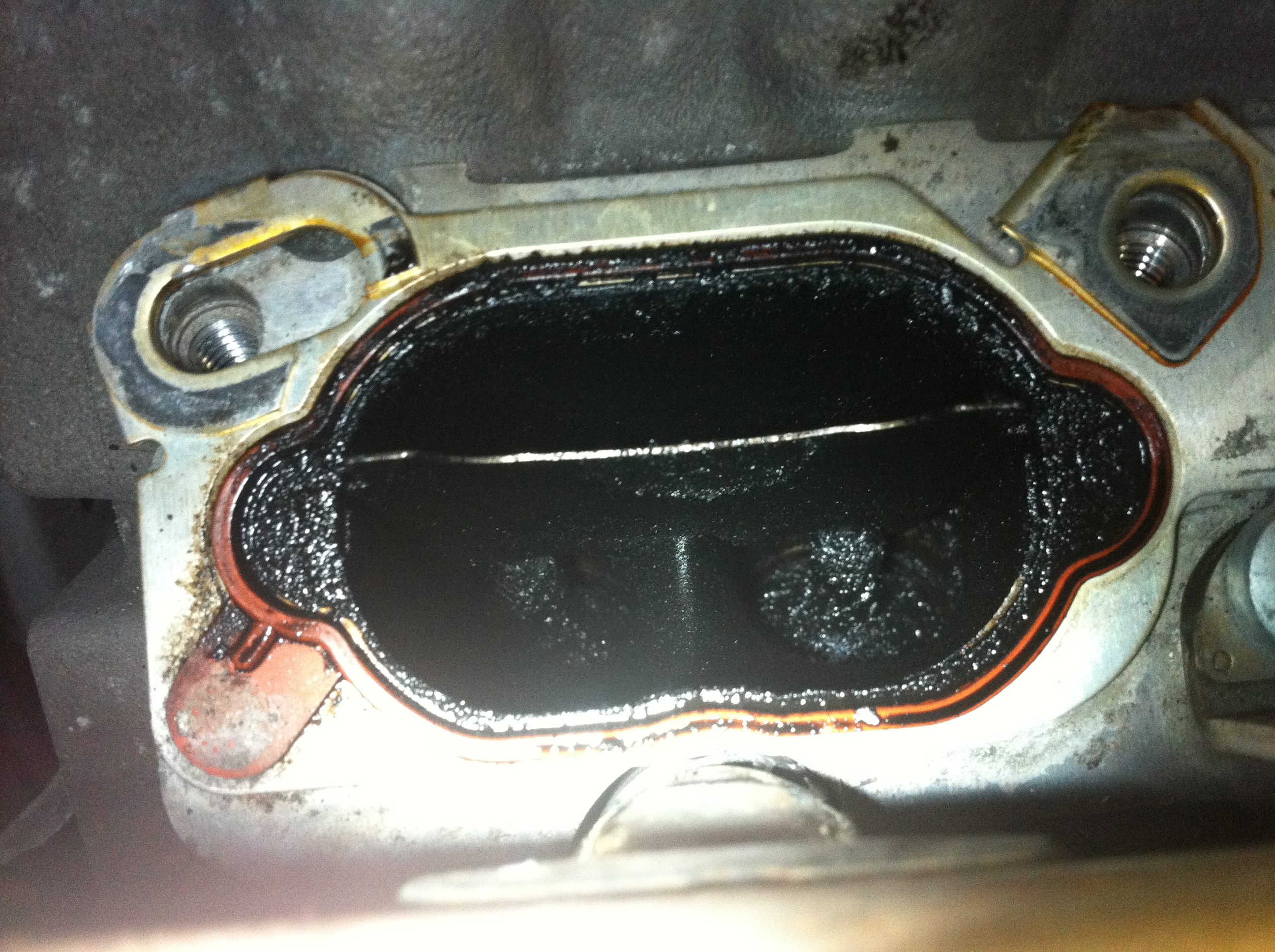

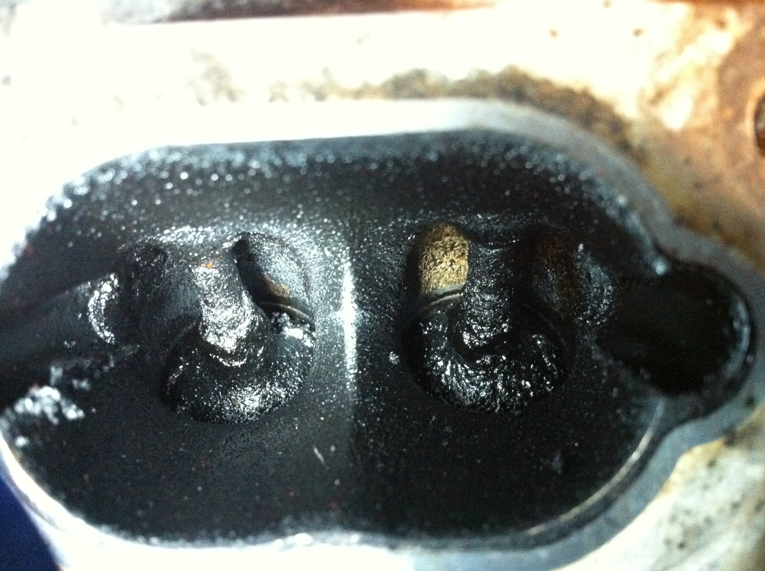

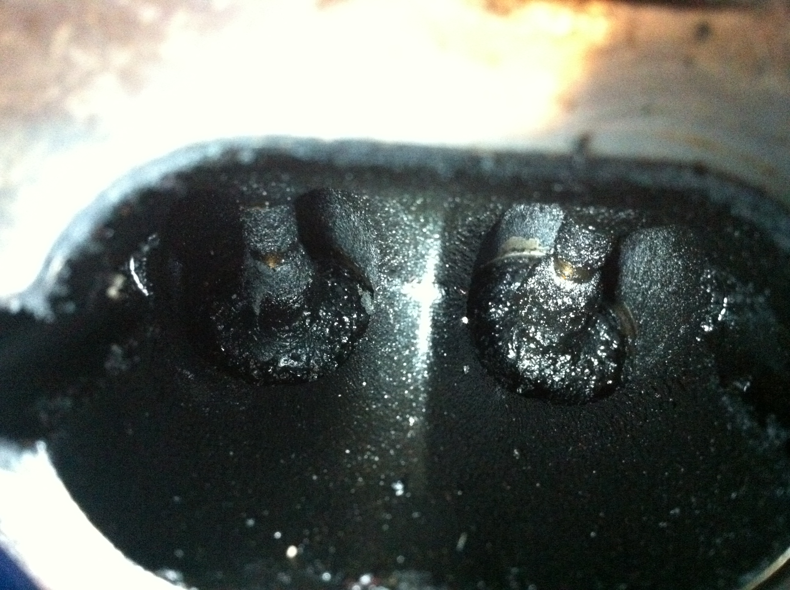

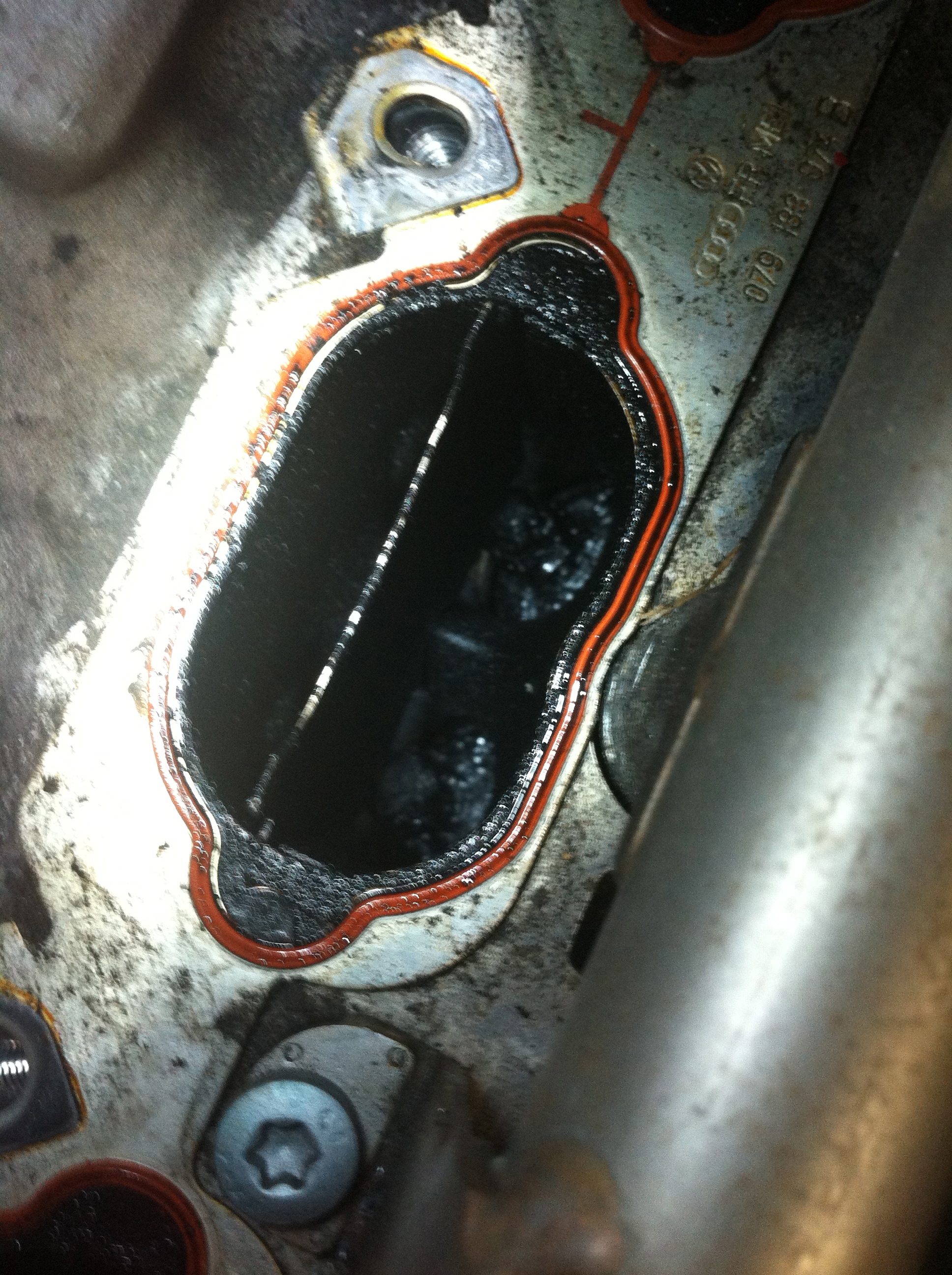

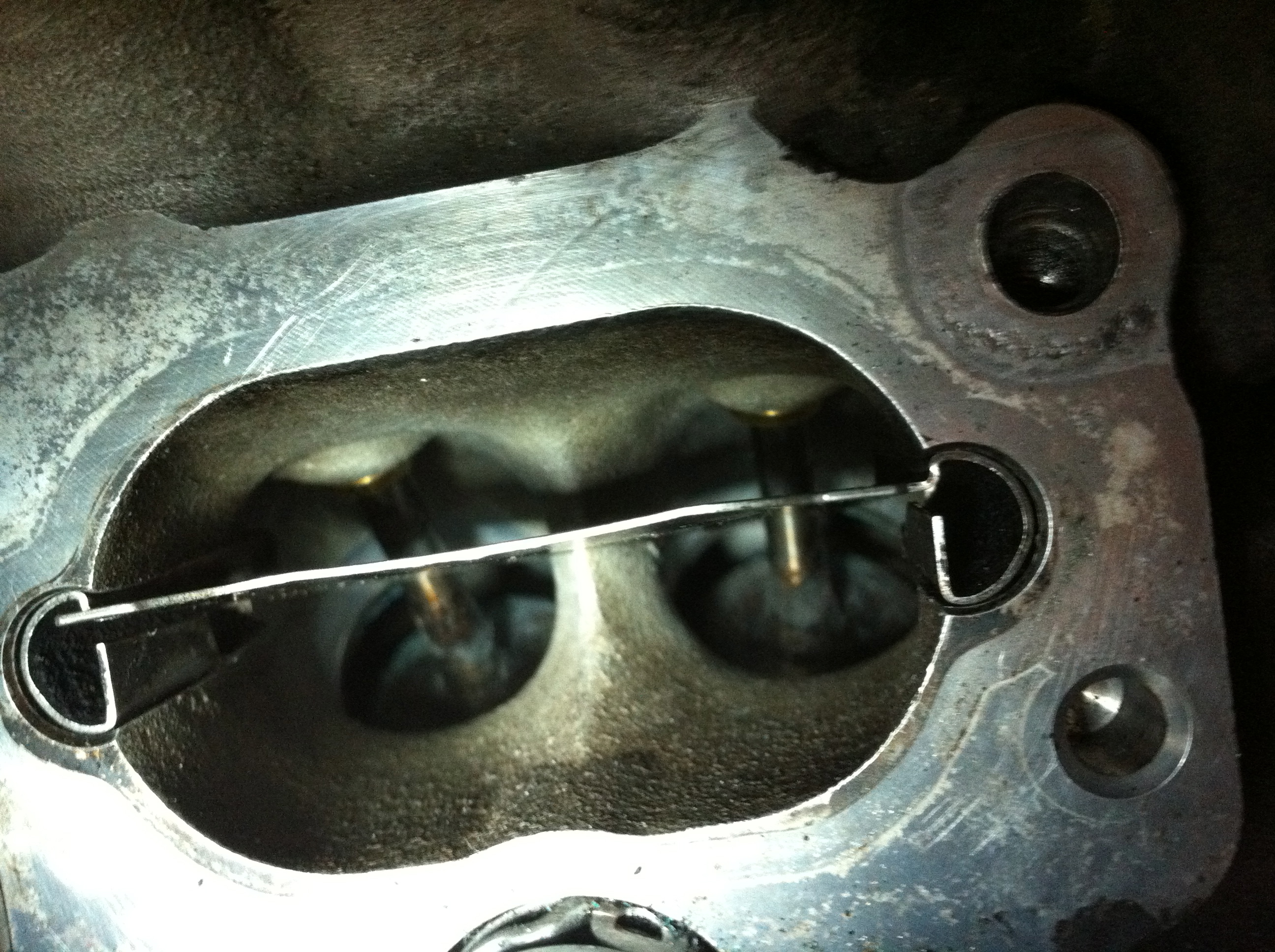

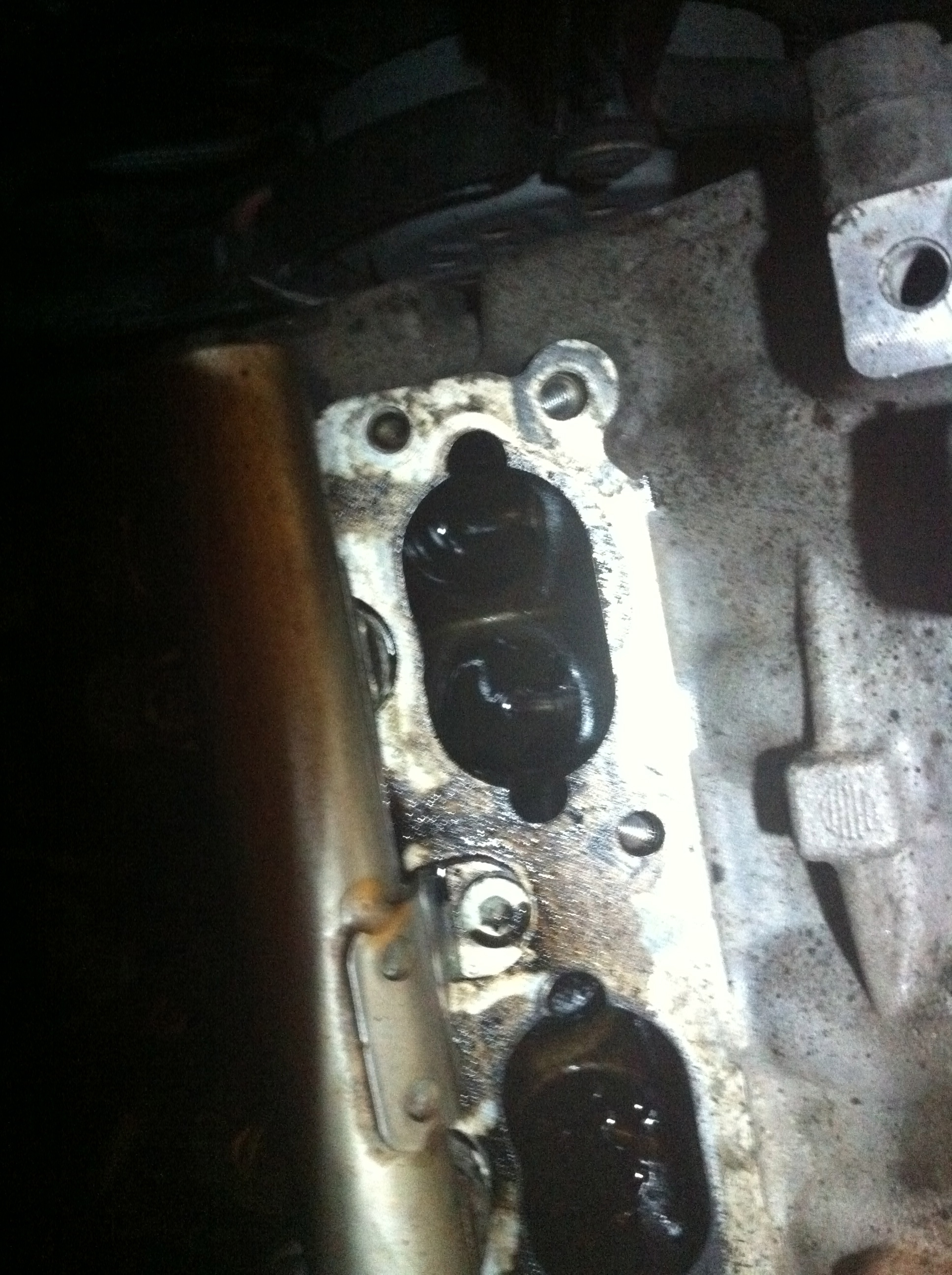

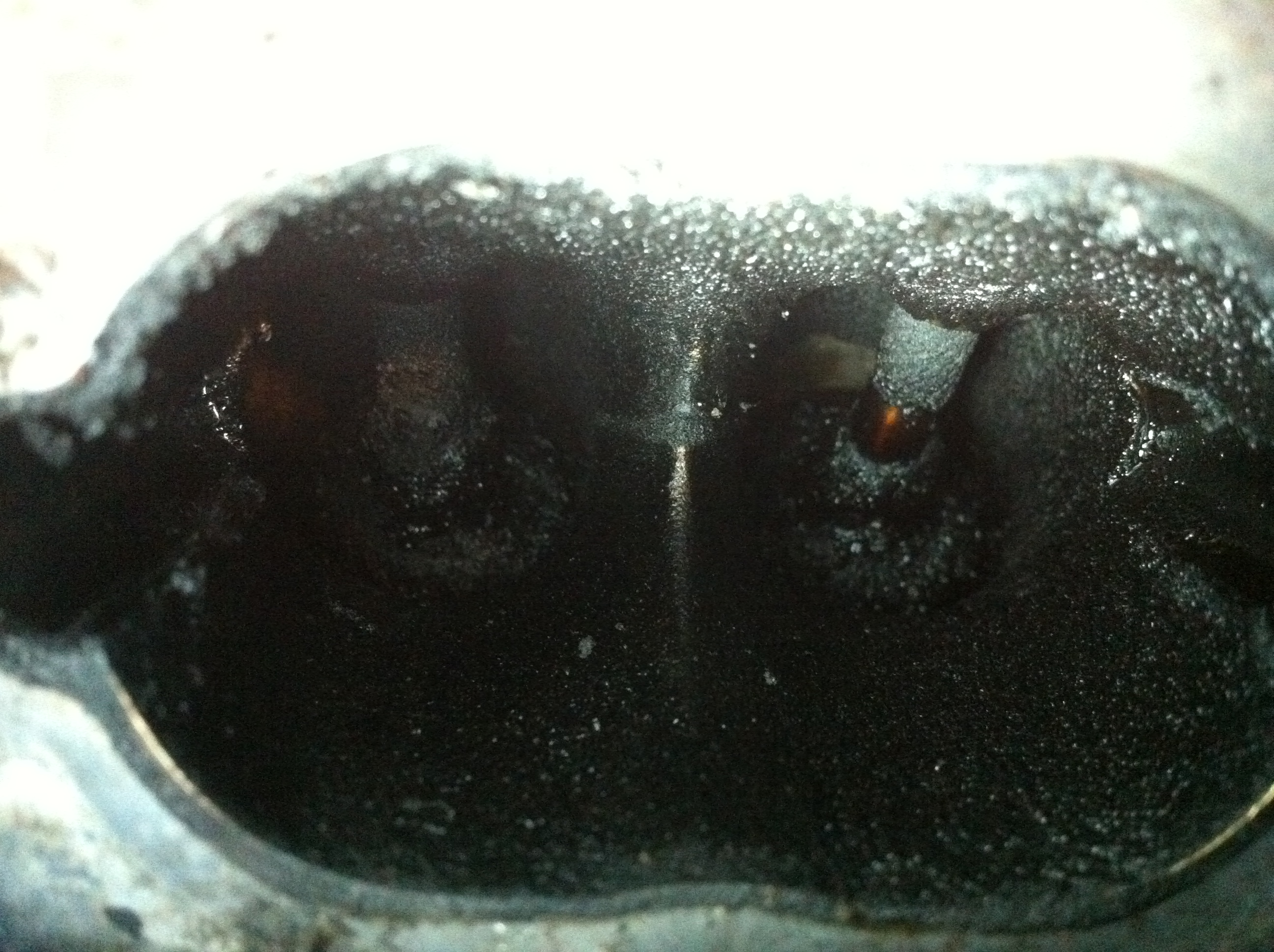

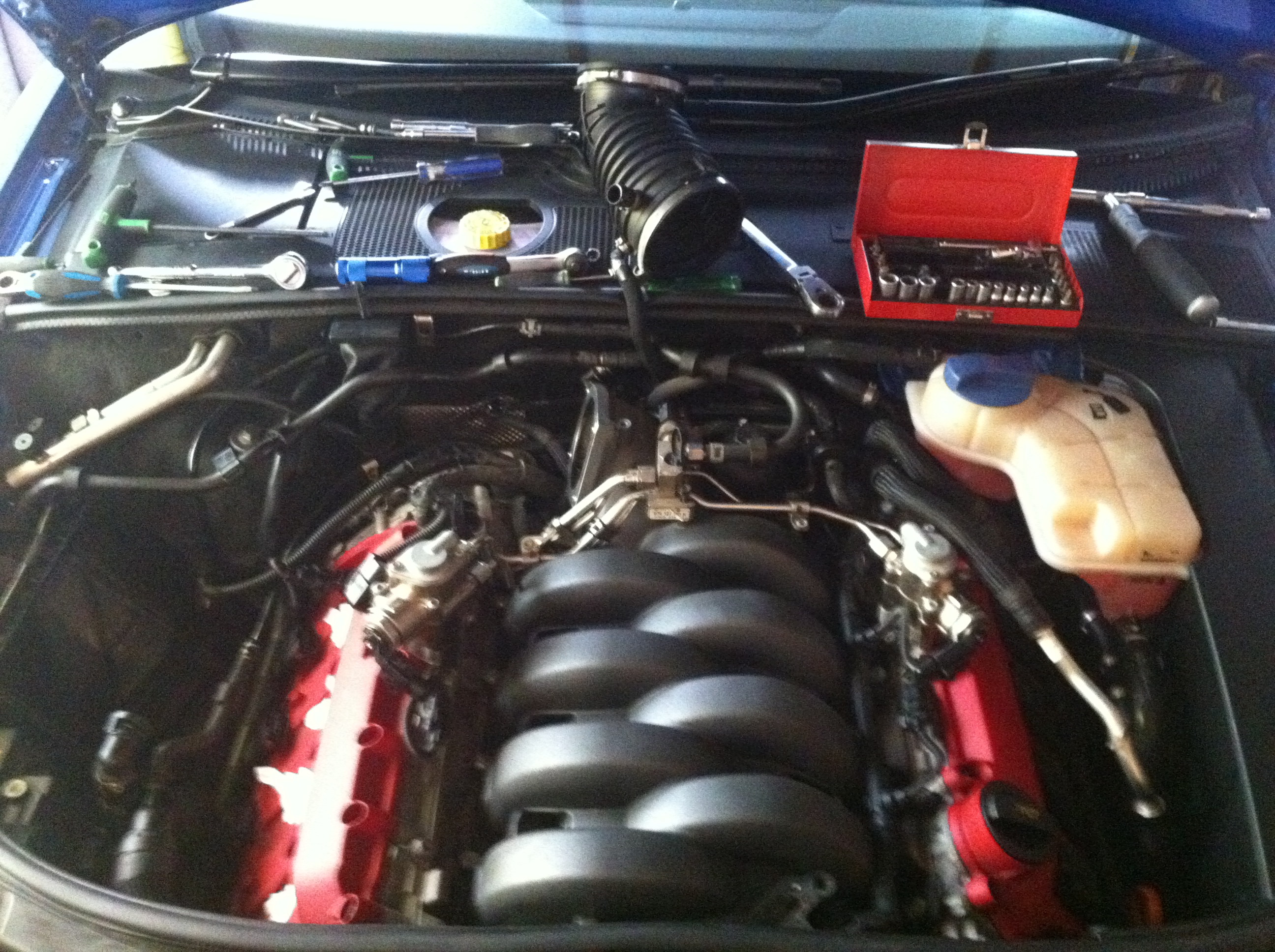

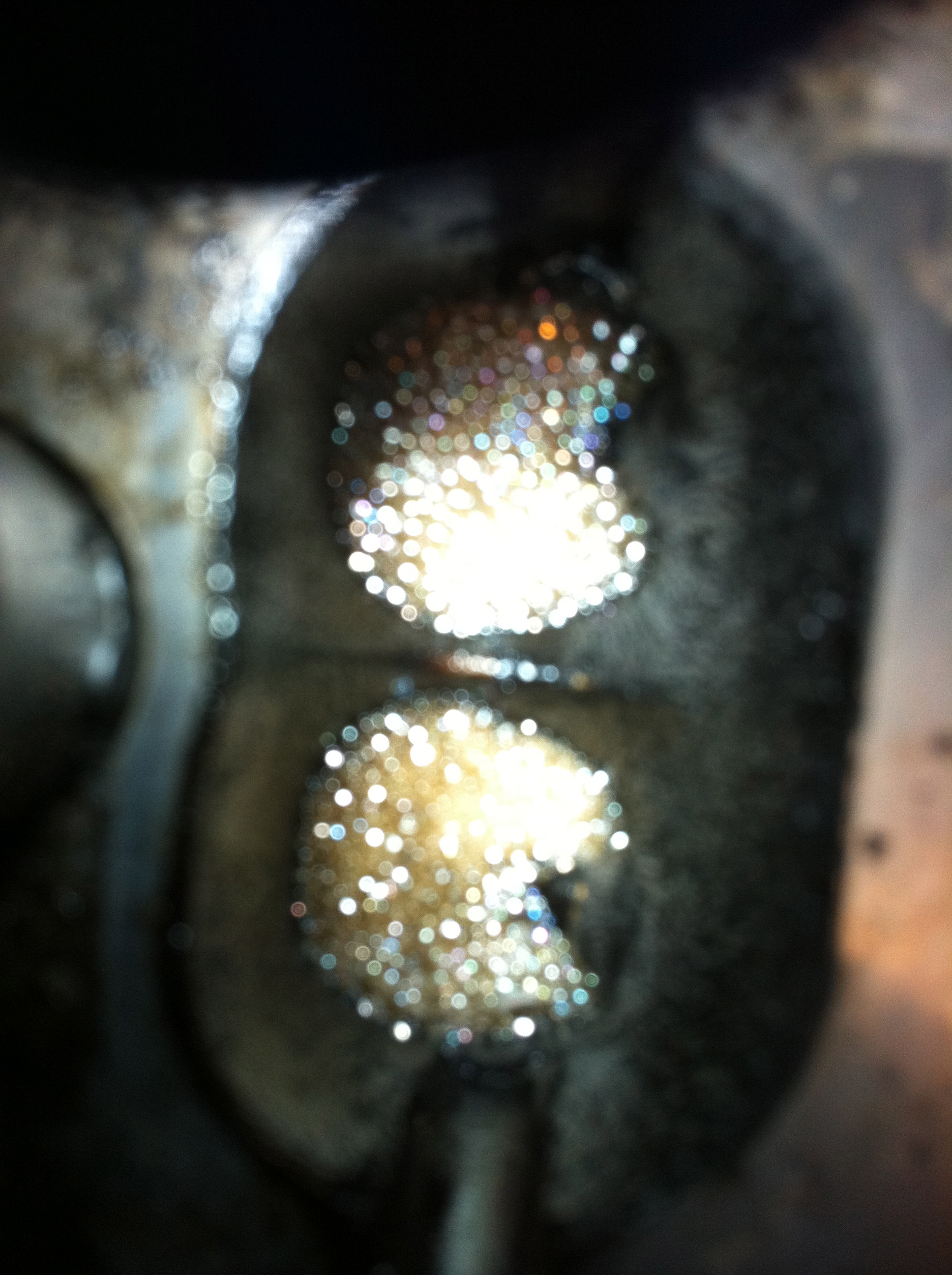

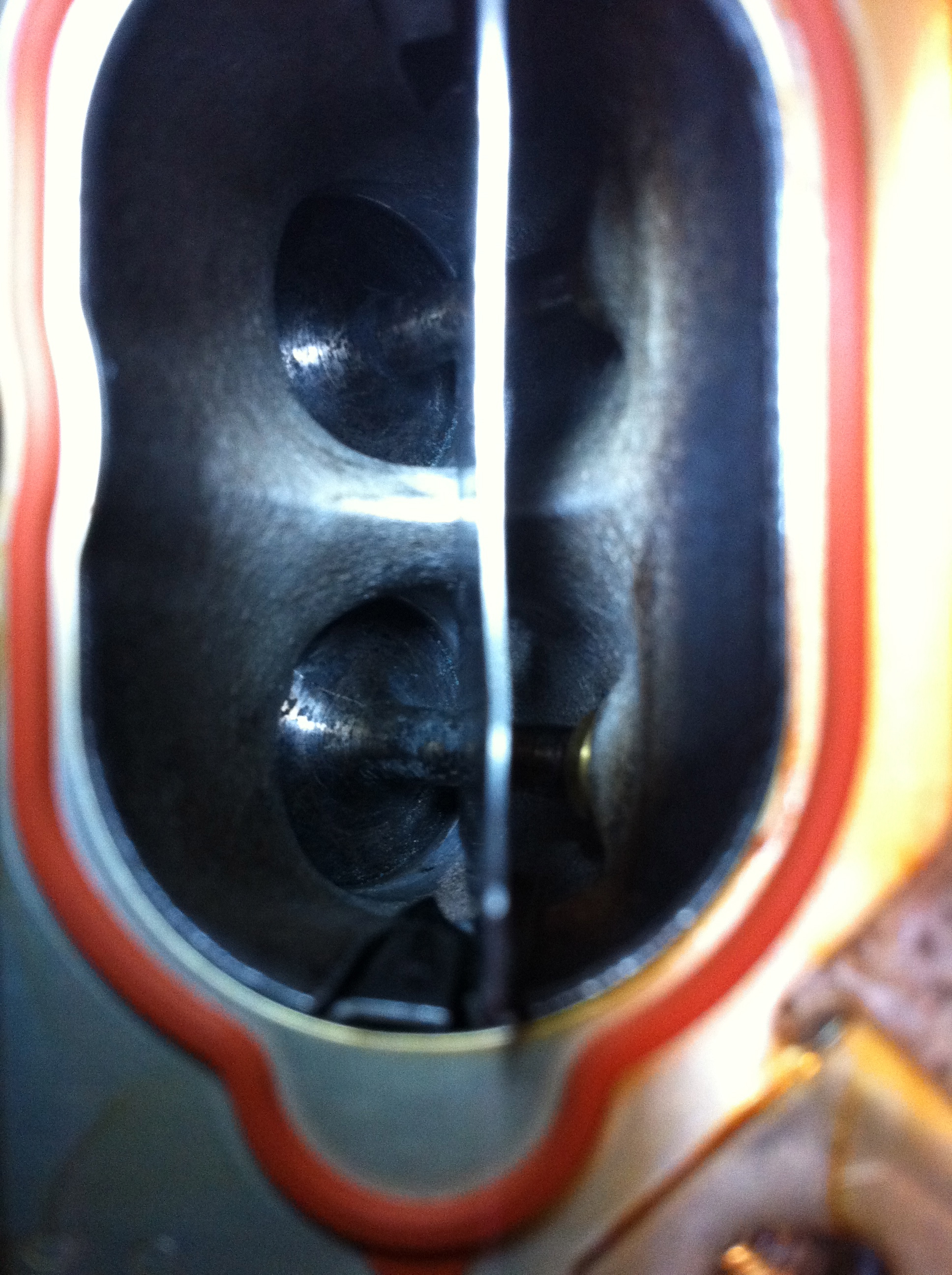

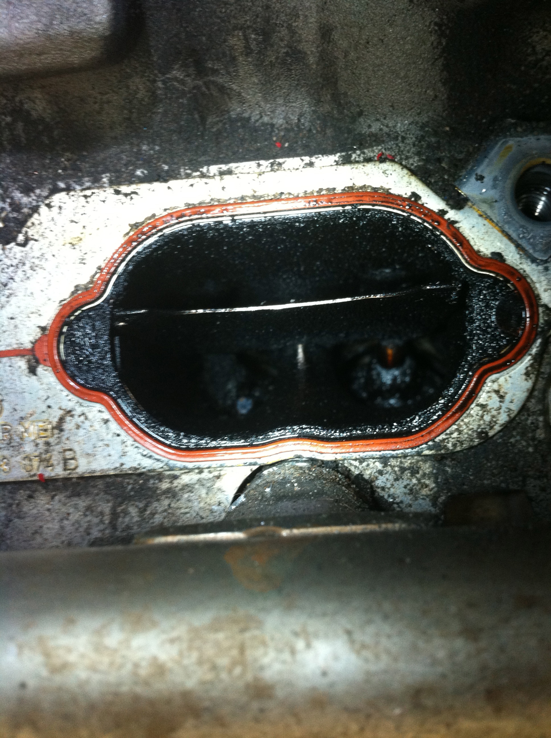

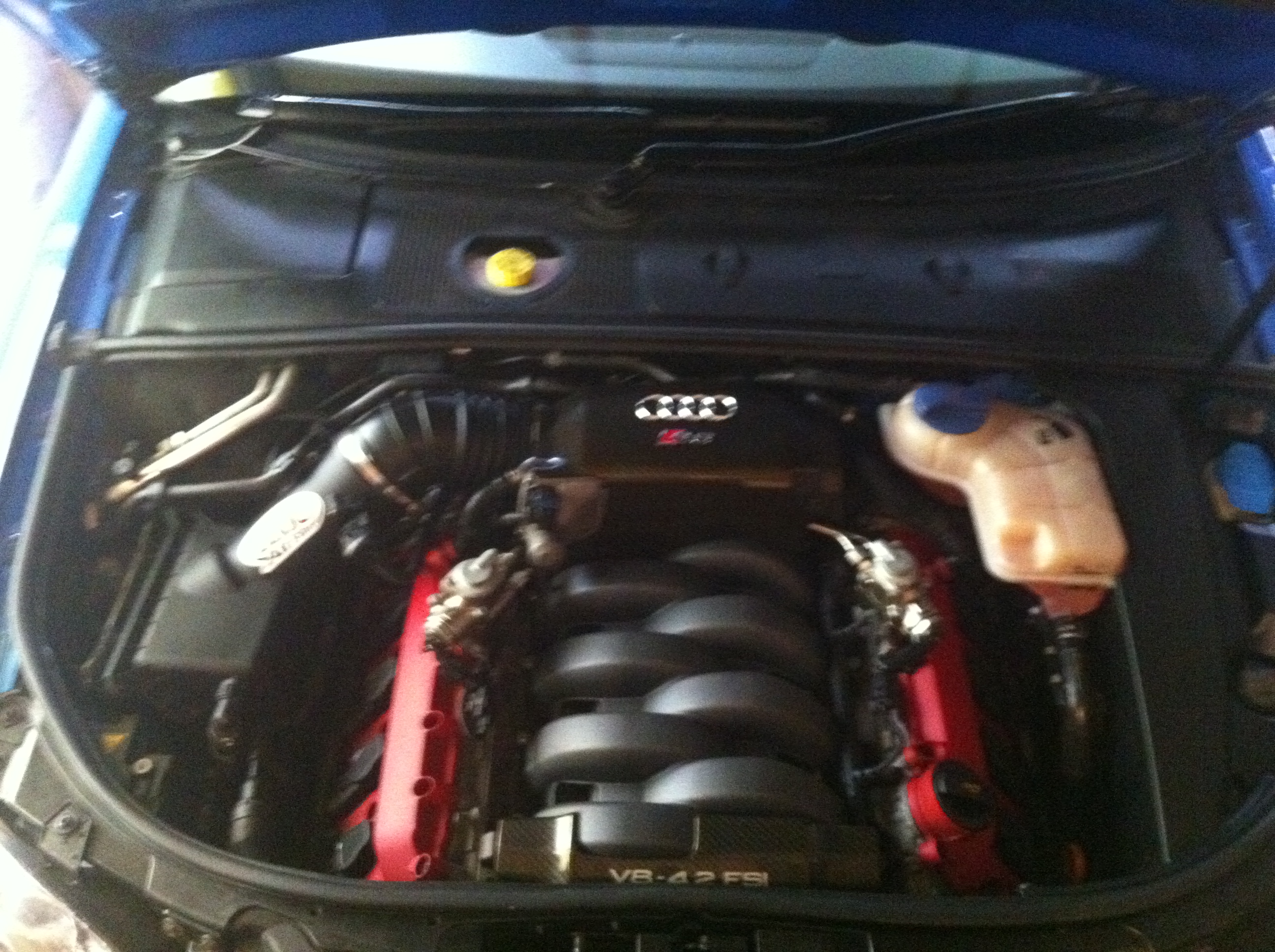

:lol: Decided to de-coke the RS4 here are some pics, car has done 51000 :audibash:[attachment=18]IMG_1512.JPG[/attachment
Car now running so much better, took it out for a spin loads more low down torque and when it hit 5500 rpm i started laughing, it goes nuts, i always knew it was down on power :biggrin3:
Dip 3 doing its stuff !!
All clean :)
Hard work but well worth it in the end.

Looking good. I plan on doing this in due course - mine's currently done 47k miles and has definitely lost its 5500rpm kick. Did the DIP3 dissolve the deposits on its own or did it need scrubbing as well - in which case what did you use to scrub it?
Also, what did you use to get the DIP3 out of the inlet tract to ensure nome of the DIP3 or deposits subsequently dropped into a cylinder?

Dave_M wrote:Looking good. I plan on doing this in due course - mine's currently done 47k miles and has definitely lost its 5500rpm kick. Did the DIP3 dissolve the deposits on its own or did it need scrubbing as well - in which case what did you use to scrub it?

Post by HEo2TEC » Sun Oct 09, 2011 11:04 pm
guffy wrote:Looks good to me.
How long did it take you?
It took a good two days :bash:

Post by HEo2TEC » Sun Oct 09, 2011 11:11 pm
P_G wrote:Good job, did you use DIP3 aerosol and then wipe or was it the petrol additive you used?
I used two cans DIP3 that i had spare, and two cans of whynns carb cleaner, and it took a hell of alot of elbow grease, you have to get the soft carbon off first and then the hard carbon!!

Post by HEo2TEC » Sun Oct 09, 2011 11:14 pm
Dave
The DIP 3 and carb cleaner helps alot to dissolve it but it does take alot of scrubbing and scraping :audibash:

Post by HEo2TEC » Sun Oct 09, 2011 11:30 pm
Dave
I used an old henry hover and reduced the pipe size to get into the inlet port but you must make sure the valves are shut before scrubing or chapping any carbon off, i made sure they were shut by spraying some DIP3 in and leaving it for a bit, as soon as i was confident it was not draining away i knew the valves were closed and then procceded to clean, its all this that takes the time as the last thing you want is bits of carbon flying around in the cylinders :audibash:

I'm considering having a go myself. I have a good range of tools, any specials required?
Come to think of it, a list of tools required would be even a better :)
