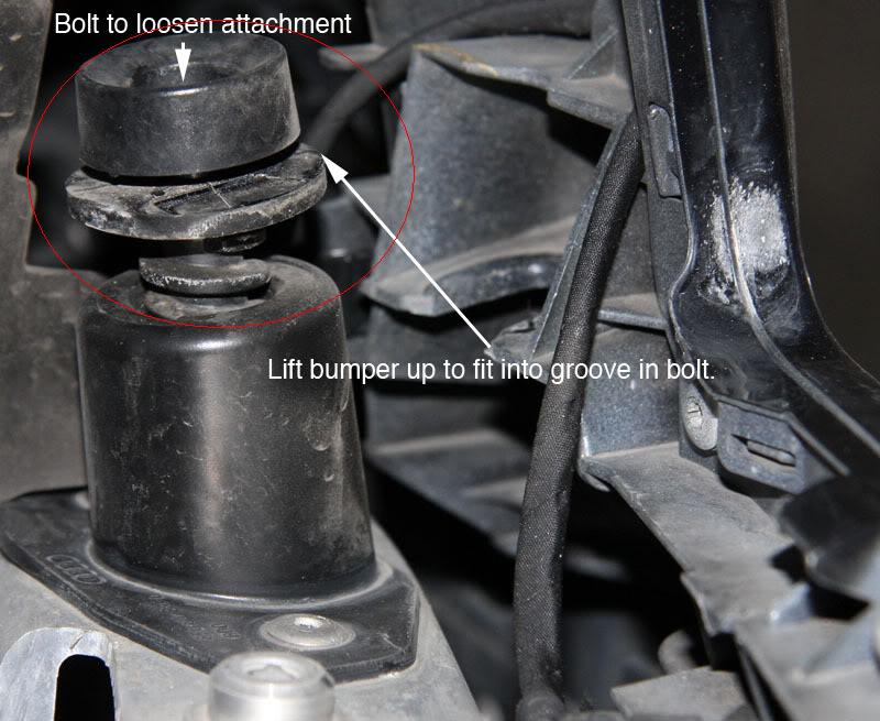

Hi Ads, thanks for this, just been out for a look and if I am not mistaken the top (threads sections) of both adjustment screws are missing, The bases are there and you can see the locating pins from the bumper body but they are attached to nothing. I know that Bolton audi had the bumper off last year but I can believe that they put it back on without these. The piece missing from mine is circled in the picture!!!!

thats gonna be an arse as I imagine you can only get complete adjustment parts to order and you'll need to take the bumper off to fit.

When I partially removed my bumper I found that some of the plastic on the stop screws has disintegrated, so I ordered a new pair. I can't find the receipt, but they weren't very expensive. The screw will come out completely from the top, so just replace old with new, or insert new as required. I managed to do it without taking the bumper off completely.
Re: Bonnet / Grill gap advice
Decided to go back to Audi and called cust service uk, next day got call back saying that they would cover cost of bumper removal, refit of screws etc. 400 quid at Audi body Shop! Happy boy!
