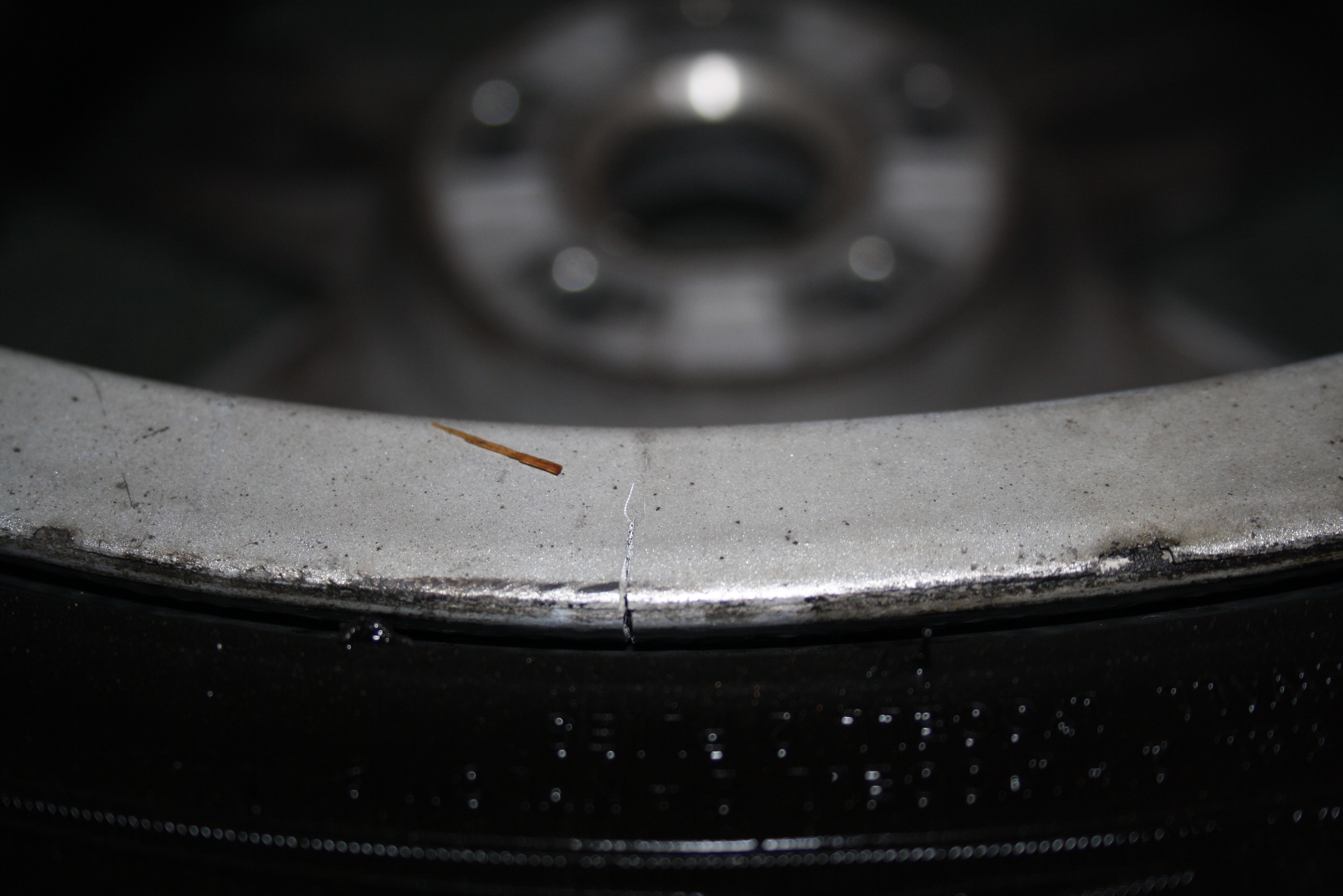

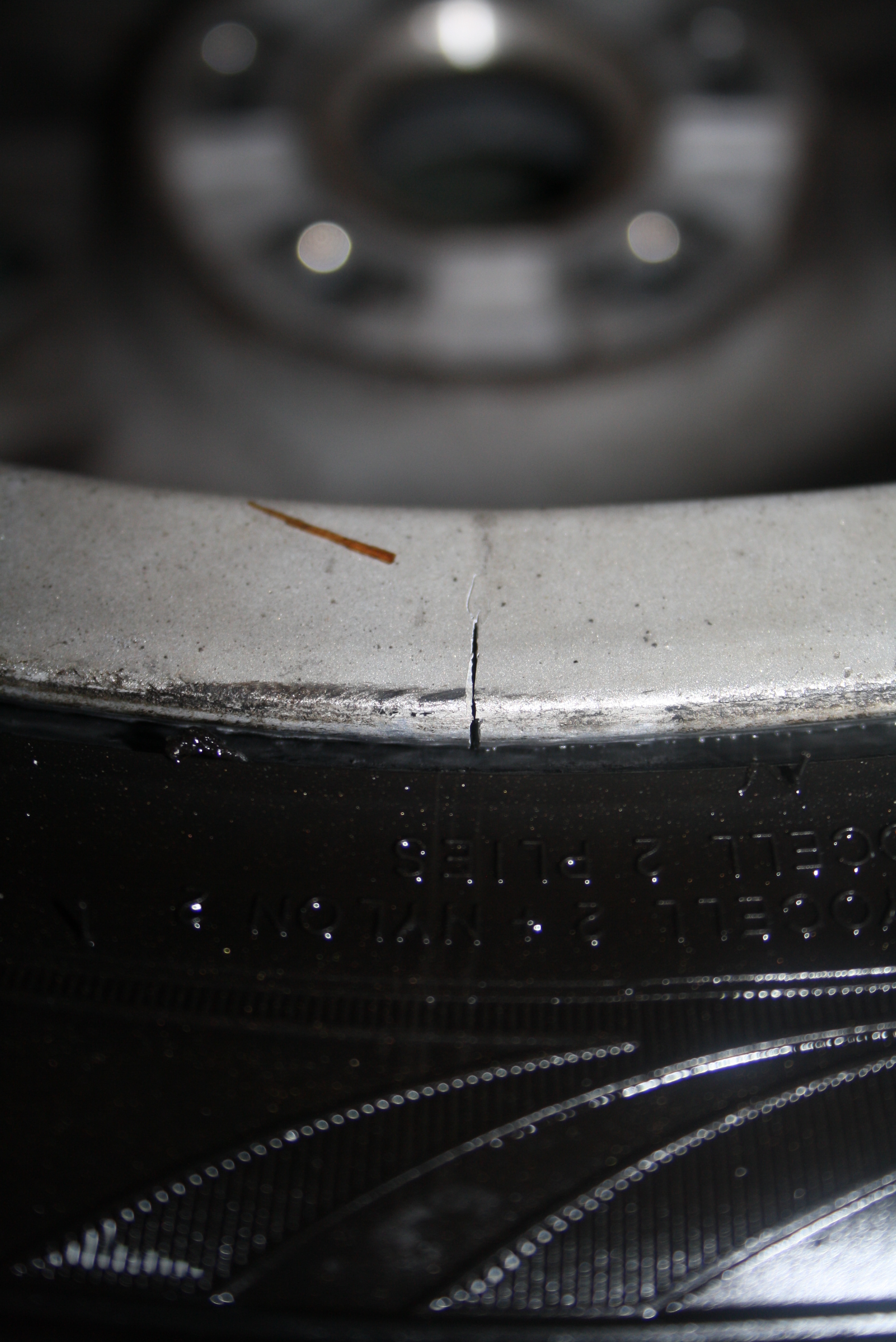

I went out to the car yesterday and found I had a flat front tyre ....... took the wheel off and replaced with spare - (which was also flat :bash: - but thats another story)
After a closer inspection of the flat I found this as attached. Now I have never had an alloy crack but I was a bit surprised at this - has anyone else seen or experienced something similar with an 18" Avus ??

Hmm,
Never seen that on an OEM wheel myself, would almost say has the wheel been bashed somewhere else due to the angle of the crack i.e. wider at the outside.
As an alternative to buying an OEM wheel, you could look at the WSPItaly replicas which are 'spare wheel compatible'. They are available from Performance Alloys but not advertised on their website. I bought some with the smaller offset to fill the arches better and they are cheaper than OEM and 2nd hand.
The S4 Avus III replica is called Boston, you can also get them from ProjectX who advertise on P'heads but they were more expensive than Performance Alloys.

The top one looks like someone has used a reciprocating saw to cut the tyre off and gone too far.

gottanS wrote:Hmm,
.....Yeah I'm pretty sure it must have been the work of a pot hole as they are pretty bad around my way - despite the F1 style avoidance techniques its impossible to miss them sometimes !!
I was just surprised to see it on the inside edge with no tyre damage either.
Thanks for the replacement advise to :thumbs:

xyber wrote:The top one looks like someone has used a reciprocating saw to cut the tyre off and gone too far.
Well I had all four tyre replaced two months ago and I trust the guy who did it and plus I watched him do it ...... so I would be surpised a) if it was done at all previously b) that my guy would have missed it this time round !!
It is a 'clean' cut though !!

Defintely a crack, not uniform enough to be anything else.
The inner part of the wheel is weaker than the outside so is more likely to suffer damage. Have you tried measuring the wheel to see if it distorted i.e. from crack across wheel through the centre and also at 90 degrees to this, if different then wheel is out of shape.

Post by DSB » Mon Sep 05, 2011 8:02 pm
nop not measured it yet, suppose that will confirm its be bashed on a pot hole.
