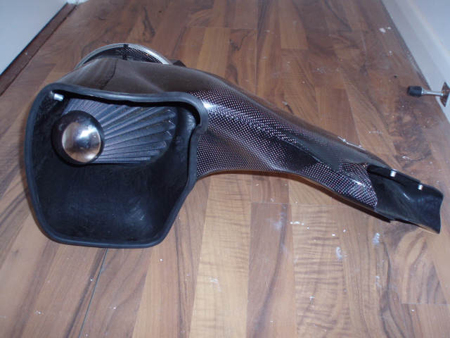

just a thought, but if you covered the oem induction system in tape would that not help with the cooler air going into the engine.
or is the amount of air in the gruppe m system larger, from all the pics iv seen ( not seen one in the flesh) the enterance to the gruppe m system apperes to be the same as the oem version.
please feel free to comment as the gruppe m are a lot of money

No the GruppeM has 2 intakes, the snorkel (only part that is same as oem)and the lower part. The power part is where you get the heat soak as its in "eye to eye" contact with the exhaust manifold.
The tape is just to stop the side walls of the induction system from heating up and causing the air being warmed up prior to entering the engine.

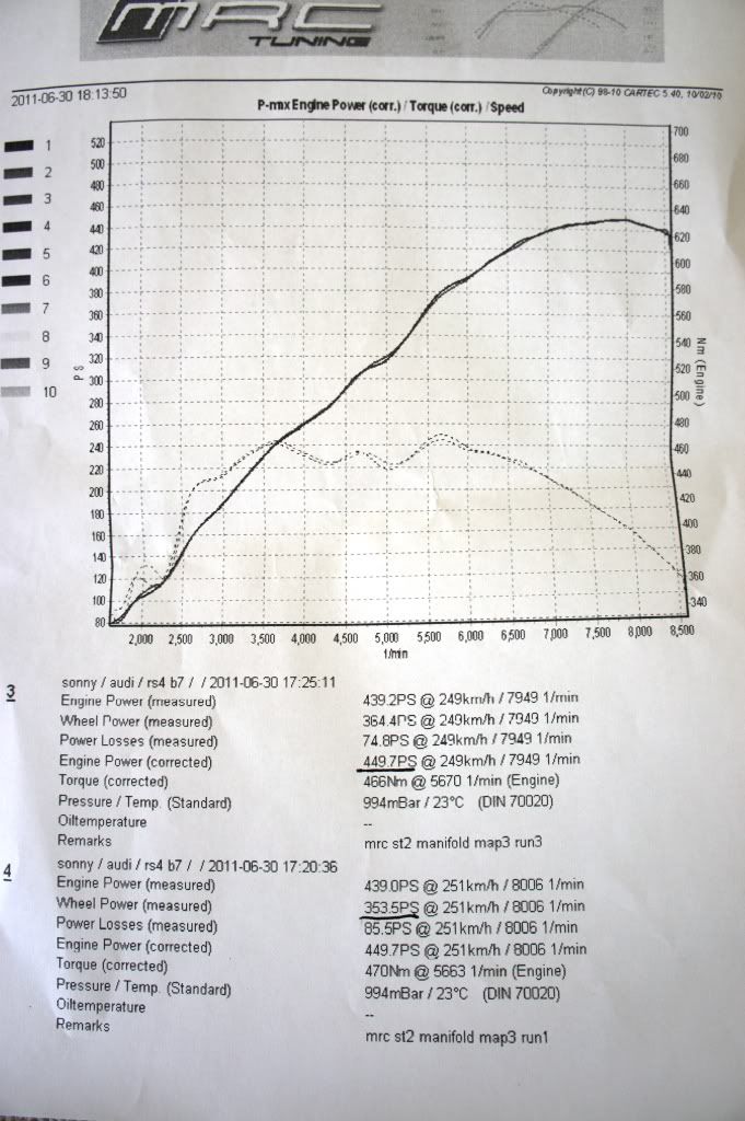

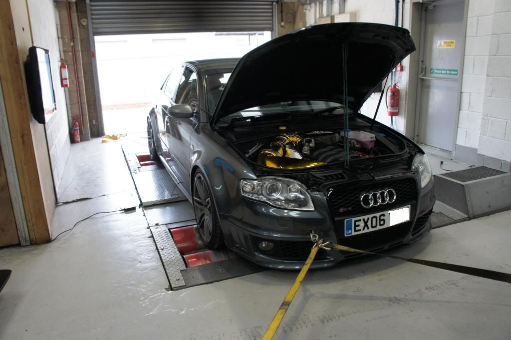

Update on the GruppeM cooling and heatshield.
I took the car upto MRC yesterday to have some more work done.
Mods include.

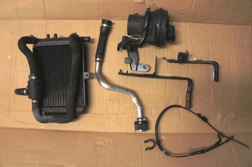

Delete Off-side Aux rad and fit cold air feed (Lower grill to GruppeM
Remove secondary air injection
Fit Phenolic spacers (heat proof spacers for manifold)
Fit a stage 2 inlet manifold
Upload tweaked custom remap and power runs.
The main aim of this exercise is to see what the GruppeM is capable off.
Last month the car made 423ps with a intake temp of 51c. Intake temp at end of run with new cooling mods was down to 32c. So a lot lot better then before. However, the intake temp is still hotter then an OEM air box (if same ambient air temp was recorded) think the GruppeM is around +7c hotter.
So the cold air feed, heat shield and manifold spacer worked. Pat on the back for me :wink:
The care pulled a respectable 450ps
The car, if running the OEM air box with the cold air feed bolted directly to it with a high flow filter will more than likley hit the 460 mark. I will "experiment" with the OEM air box and cold air feed at the next rolling road meet at MRC next month.
Summery, is the GruppeM worth it, if your after looks and a great sound then yes, if your after power, then no, however, unless a better sealed heat shield can be developed then it will be a killer. This info is based on the dyno figures from yesterday.
I will be keeping the GruppeM on as I need to trial it at a few track events.
Two hours later and still fine tuning the map to run well with the stage two manifold. Minhea sending maps from France to Doug via MSN messenger. :thumbs:
Aux rad and secondary air injection unit.
