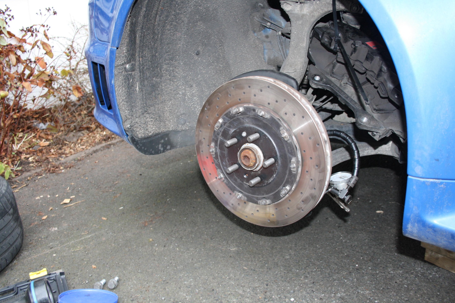

I had them fitted last week with new pads by a local Vw Audi specialist . But on driving I was getting a Judder
at any speeds over 35 mph, it got a lot worse over 50. The steering was shaking on breaking.
The discs were badly warped.

although the front discs on the B7 are semi floating. I was quite hesitant on getting them done as people had told me it cant be done.

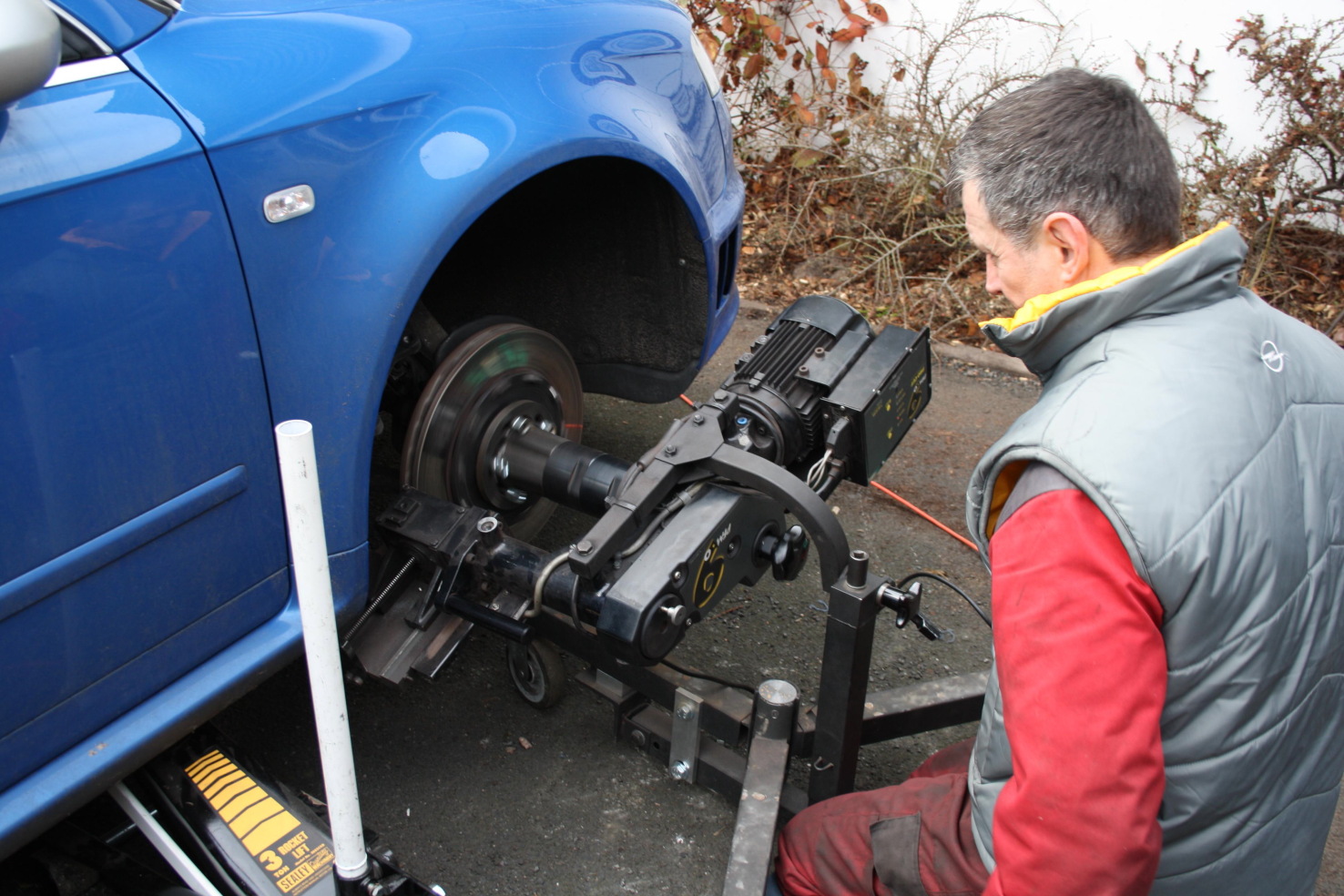

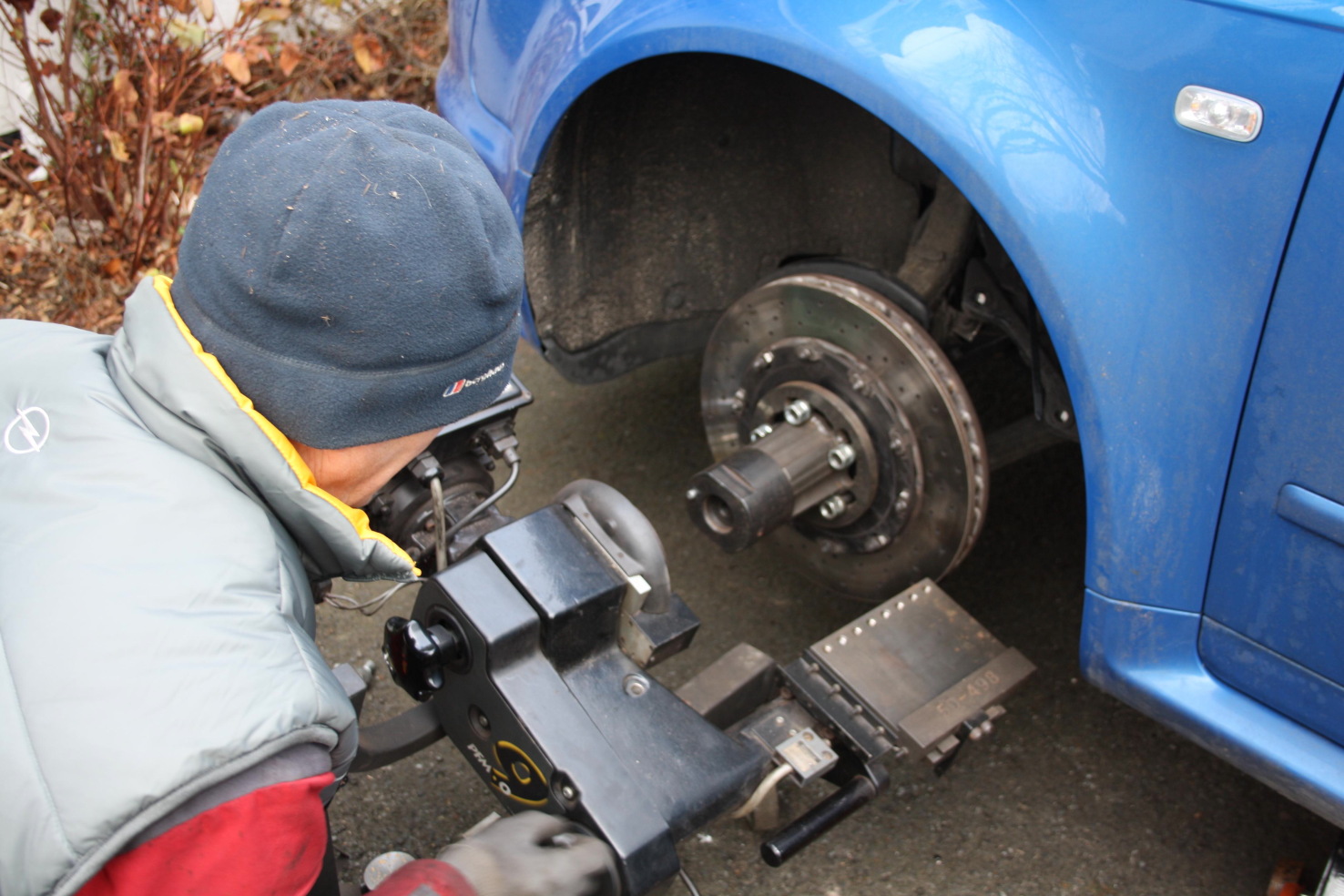

He began by jacking the car up and removing the Caliper and cable tieing it to the suspension. The machine then does its work.
Upon completion 2.5 hours later we went for a test drive, and the car drives absolutely perfect, no judder or anything at all.

I see he restrained the rotor hat with a harness to stop it floatin around but how did he reface (smooth) the disc and stop the lathe ghosting the crossdrilled holes on to the disc?

I'm not to technical but he just ran the blade form the outside in and then back out again, he used a new blade and modified it this morning specially for the car.

When you get the chance can you see if the disc face looks grooved or smooth On hub lathe's do have a tendency whilst skimming to groove the disc and usually require smoothing down (refacing) afterward.

We have a similar "pro-cut" machine and cant quite understand how he's stopped the floating part of the bell from moving?

Procut told me that discs with floating bobbins should not be done. Interesting that it worked though.
