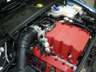

Many of us on here have had good results from a full sports exhaust system including 200/100cell cats, High flow filter, Ported manifold and a good custom remap, individuals on here have seen anywhere from 435 to 451ps (myself 441ps) from MRC Tunning.
Supersprint Italy was doing test with a new high flow header on a customer RS4, but the 2 prototype was loosing power possible due to back pressure, I did look into this myself at one point.

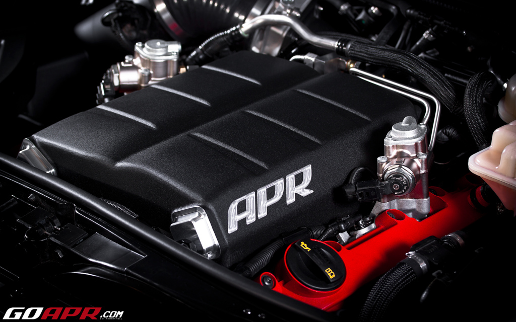

Regarding the Superchargers, 500ps would be realistic? As they say a twin screw will normally add around 60ps.
A few chargers to get your taste buds going
