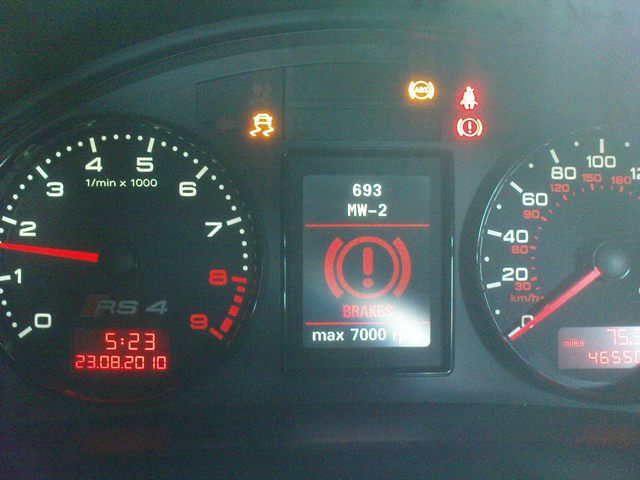

Here's a picture of the warning displays I got with my camera phone when it happened yesterday, although in this instance the engine ran OK and the EPC light wasn't on.

Post by drcarrera » Fri Sep 17, 2010 2:27 pm
2manytoys wrote:I had my Traction Control and ABS light come on and the fault was the MAF Sensor!!!
Have a gold star! Car's been in this week, and it has a faulty MAF sensor!
Apparently also has a throttle valve problem and some switch or something is faulty as well (can't remember exactly what!).
Just glad they found something wrong, as intermittent faults can be tricky.
Warranty expires in two weeks as well, so lucky this happened when it did! :shock:
