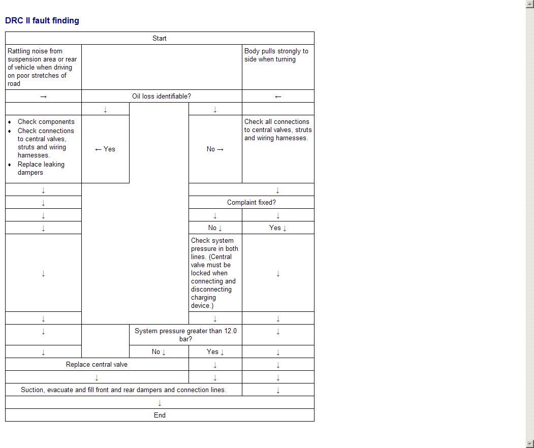

ArthurPE
Posts: 3755
Location: USA
Post by ArthurPE » Tue Jul 20, 2010 7:16 pm
here's the troubleshooting flowchart, 12 bar...

Post by rs4v8 » Sun Jul 25, 2010 3:41 am
Replace leaking dampers eh Arthur? Thought that didn't happen? :biggrin2:

ArthurPE
Posts: 3755
Location: USA
Post by ArthurPE » Sun Jul 25, 2010 3:52 am
rs4v8 wrote:Replace leaking dampers eh Arthur? Thought that didn't happen? :biggrin2:
never said that...said that it was below 1%, order of magnitude below ;)
