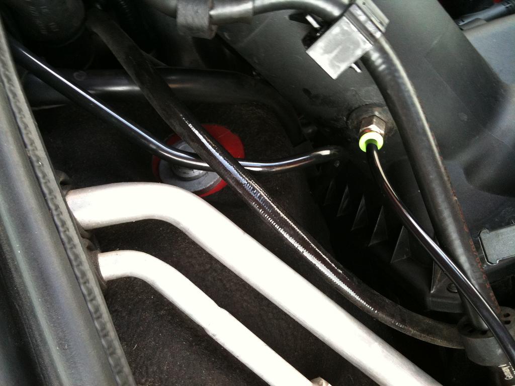

So I finally got around to it.
I have fitted water injection and an oil cooler spray. Oil cooler spray operates manually only from the 'RS4' button. The WI is armed via the 'Pursuit Mode' button and activated via a WOT switch - crude but effective.
The car has NOT been mapped but MRC will get her soon to fine tune the WI. I am currently running quite a small WI Nozzle - D02. I tried D03 but the car felt a little lumpy. I think a remap will work well with this size nozzle.
First impressions:
Oil Cooler Spray: Is only really effective if the oil temps are above about 102degC. It does nothing immediately but the oil temp recovers very quickly and within a few mins it does drop off to 97/98 degC.
WI: On the D02 nozzle I can accelerate from idle in 6th without any spluttering. She pulls stronger the high the revs go and car feels a little quicker. The big difference is that the oil temp also remains low and the inlet manifold never really gets above warm - even after a spirited drive.
I'll only know if there is a real performance differance once MRC have her on the RR but if nothing else I will have helped reliability. WI reduces burn temps by approx 300degC...!
All my components are Devils own kit.

Great work - this would have been the next step for me had i kept the car. Is the WI going into the inlet manifold? if so it will be interesting to see if any associated 'cleaning' takes place.

The WI injects immediately before the MAF and the plan to get MRC to clean the valves, remap and see what the valves are doing in a year or so...
