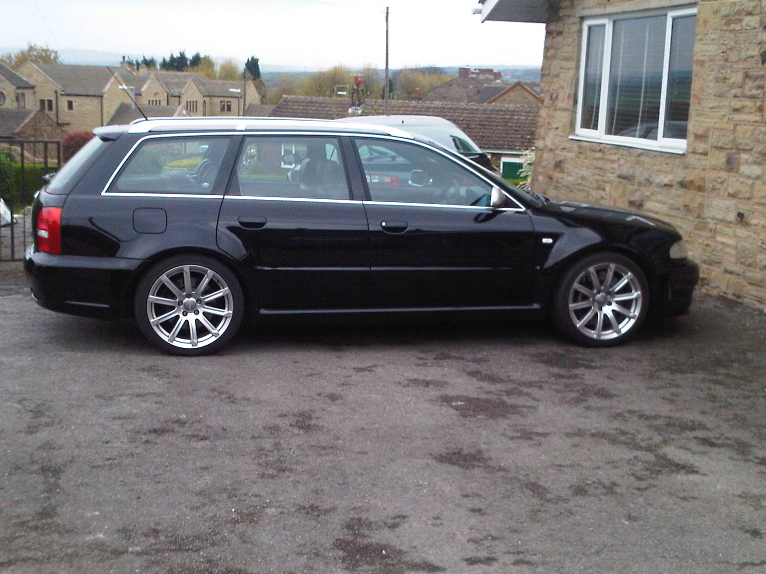

Think you could be right..........car as it standsposterboyj wrote:don't do it! OEM looks perfect
http://i206.photobucket.com/albums/bb12 ... 1278416748
