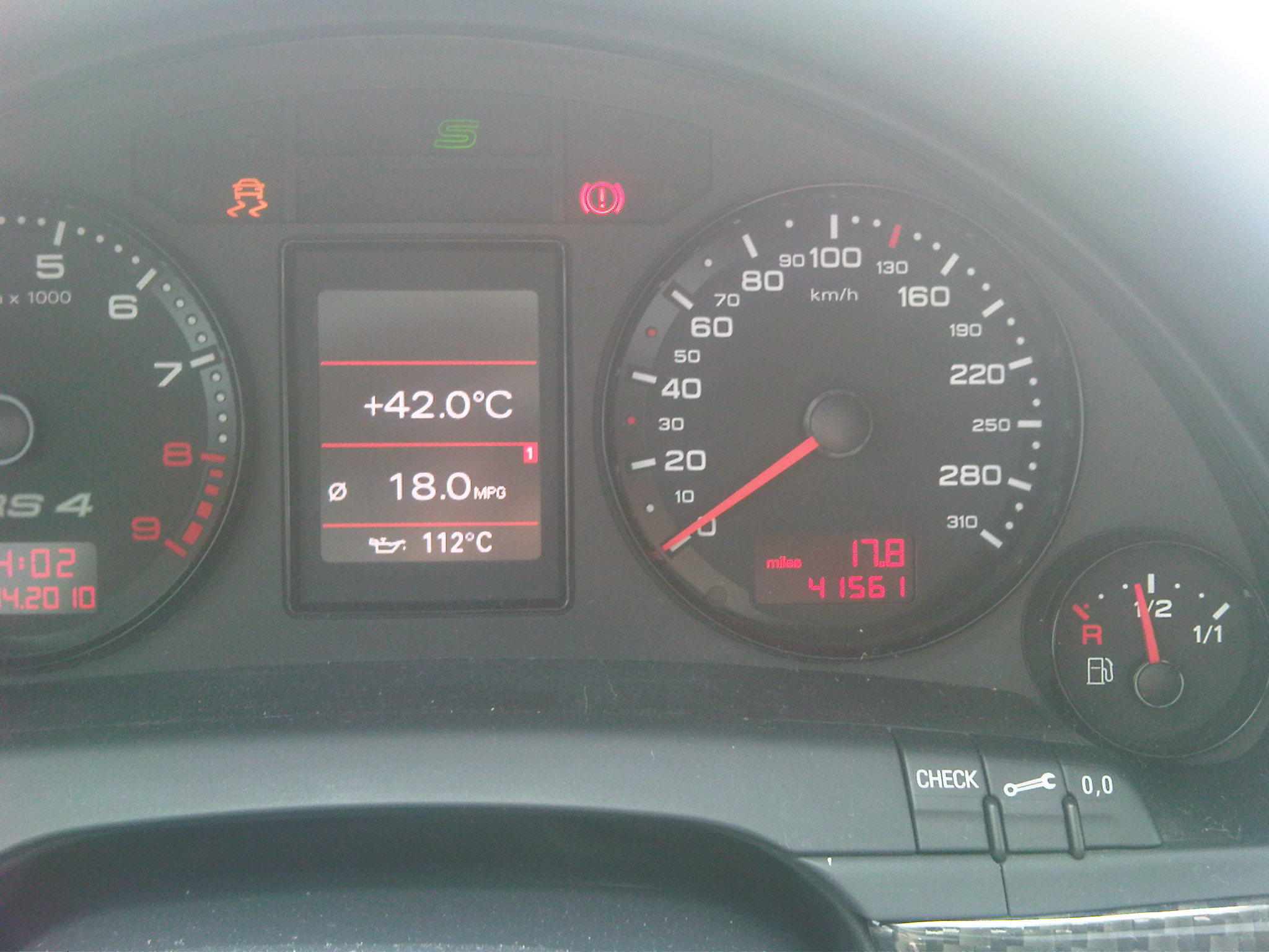

I have come back from doing 7 runs:-
8.5
9.0
8.4
8.6
8.6
8.7
9.0
well, i tell a lie, i did 8 test, the first one was around 16.5 secs, but, i didnt record that, i realised after the test i was in 4th!!
I am confident that my operation of the start / stop button was as consistant as I could muster.

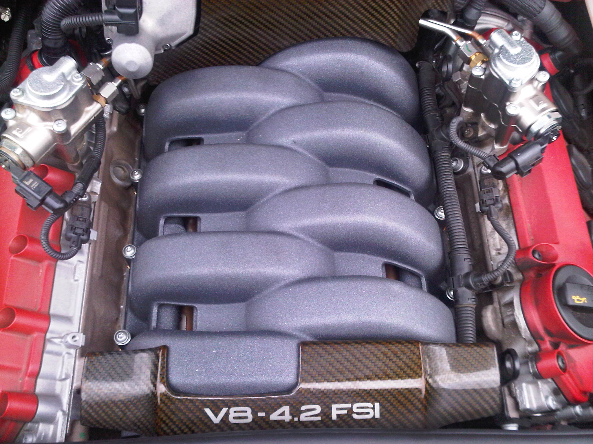

For the record my car is an 08 Saloon, with 41,561 miles on the clock, with a shade under a half tank of 98ron Dubai fuel (rumour has it its not as good as optimax), driver only and no junk of any sort in the car
The oil Temp was 112c half way through the tests.
The outside temp was shown on the display as 42.0 C and (not surprisingly) it was dry and sunny. All stability aids were de-active and in sports mode.
The car is currently on 275/30/R19 Goodyear F1's.
I have owned the car from 6,000 miles, serviced every 15,000 kilometers (as per Audi UAE schedule). Modifications are de-cat and MRC panel filter.
Due to minor compression loss Audi replaced the 'short' engine at 27,000 miles. 'short engine' being the bottom end including pistons etc, intake manifold, valves etc are original, and uncleaned.
I forgot to mention, I am happy with the performance of my vehicle. bearing in mind the tmperatures here, and poorer quality fuel, a few fractions of a second 8-8.3 to 8.5-9 to me are acceptable (and un-noticable).
Hope this data helps.

I agree, when first looking at it, it seems highP_G wrote:It may be boring to you Oscawhite but it helps.
Average is 8.68 which given the temperature is phenomenal. Given I can have a difference of 0.3 second average between 0 degree C and 13 degrees C I can't imagine how much the engine is retarded with 42 degree C temperatures.
but when you factor the temp in, it actually looks good...108f!!!
from 70f to 108f is a 6% difference in HP, probably more when timing is factored in..>25 HP
using basic estimates that equates to a 0.3 sec difference...puting his times at <8.4...right where they should be...
