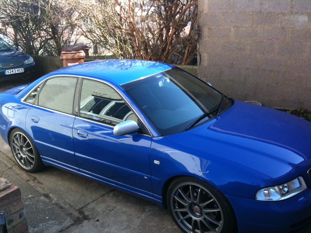

Hi,
I bought a S4 yesterday but it needs a little (!!!) TLC
There is a whining only on load coming from either the diff or gearbox (or front diff also?)
There are 19" wheels on the car with three brands of tyres
i was wondering if this would contribute to the diff or transmission whine.
Would swapping the wheels around help me diagnose the problem i.e two individual tyres on back, matching ones on front?
Is there a way to measure the circumference of the wheels?
Also there is a lowering spring kit on the car which is too low and rides terrible!!!!
I was told they are H&R upgrades and are Black in colour can anyone tell me what make they might be i.e sport, Race etc.
I'm after a sprint/sport/OEM maybe Kit if anyone can recommend for everyday driving on B Roads

Cheers for the advice,
I'm fairly certain that the centre diff is the culprit! The whine starts to be audible about 30-40mph and comes roughly from the centre of the car.
I swapped the tyres around hoping that the noise would be transfered to the rear of the car due to un equal tyres but without success.
Am i right thinking the diff is an internal part of the gear box or not? If so i'm Going to buy a 2nd hand gearbox.
You're probably right about the shocks i didn't see any obvious leaks yesterday however its a good guess that the standard shocks are knackered as the car doesn't settle after a bump on the road.
