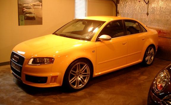

ArthurPE
Posts: 3755
Location: USA
RE: Re: RE: Re: RE: if you do your own oil changes....
Post by ArthurPE » Sun Feb 21, 2010 10:23 pm
phase II today
washed mine (it was waxed a couple of weeks ago)
checked my oil level, right at the top of the x-hatch
washed AND waxed the good lady Jamie's :D
before/after/the Mini
