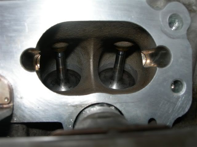

Post by ArthurPE » Fri Feb 19, 2010 12:09 am
ok, let me catch my breath....
between my last post and this one...
I removed the manifold
took pics
reinstalled
whew!
26k miles, never cleaned
:D

the engine will take the same amount of air with or without obstruction - Nonsense.
you would have more DP across the valve, but all that needs to happen to offset that is to crack the throttle - Nonsense.
Debris on the valves will reduce airflow and can ultimately cause valve seating problems. I find it hard to believe that Audi allowed for this at design stage, and certainly wouldn't have used such an engine as the basis for dynamometer tests.
The density of the air in the cylinder when the inlet valves close will be lower if there is less clearance at the inlet ports.
The purpose of the 'nonsense' comments are to illustrate the fact that your statements make no sense.
