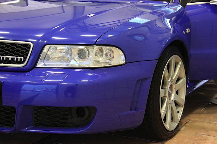

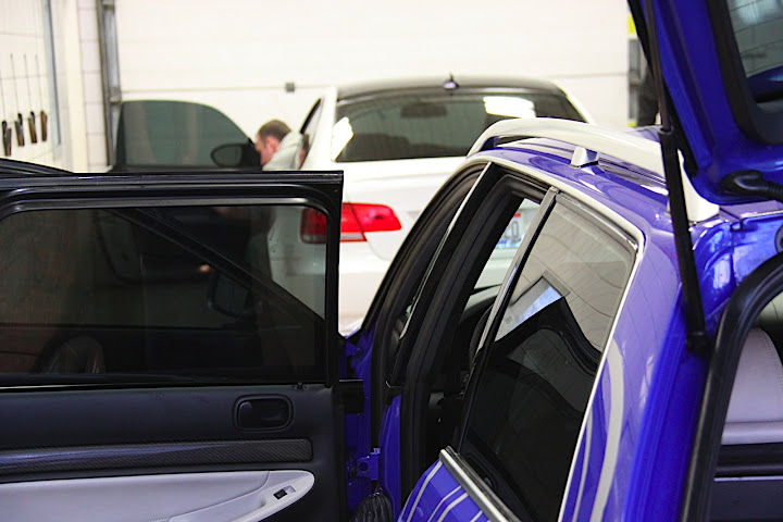

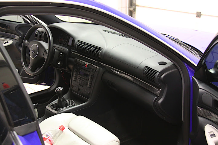

Some pics... just because :)

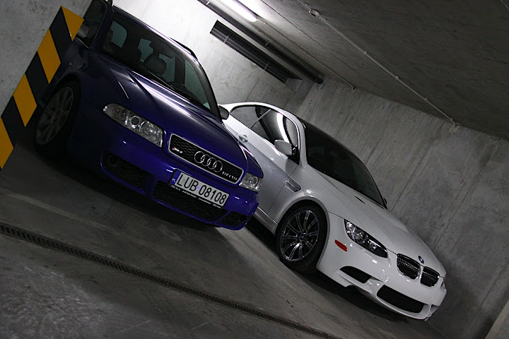

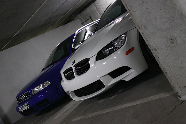

And with my friend's E92:
