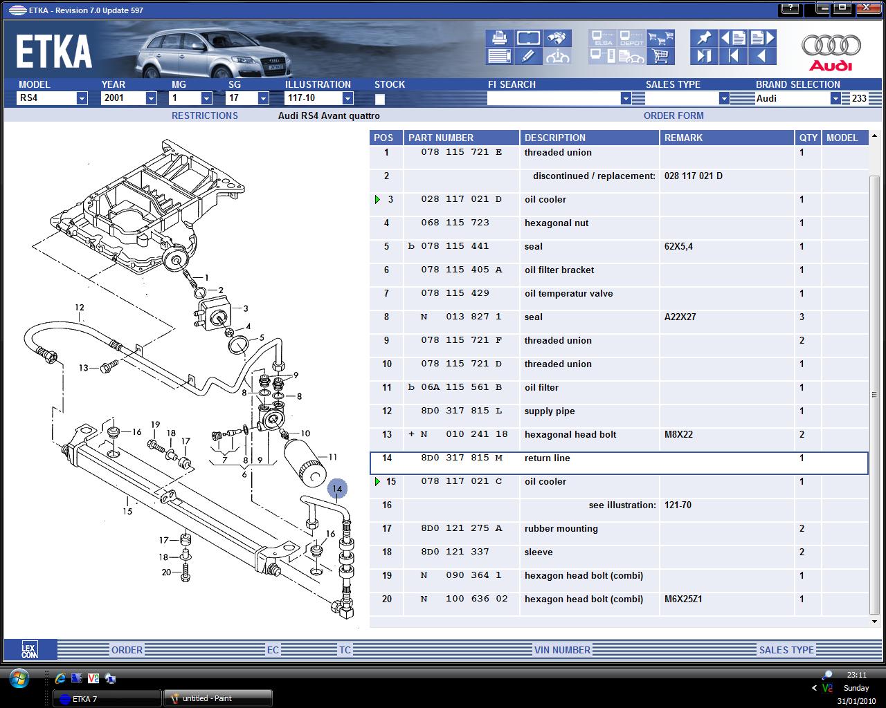

Over the last couple of weeks I could smell a feint whiff of oil in the cabin. I don't drive the car that often during the week and as it's been wet and cold I thought nothing of investigating until today… originally planned the day to replace the front pads!
Doh! - wish I had checked sooner, the whole undertray was covered in oil and nearside arch and wheel was splattered and cacked as well! – Oil wasn’t registering even on the dipstick – thankfully I haven’t driven far since I first smelt the problem.
Many frustrations later (too cold to be doing this kind of job outside) I discovered the cause of the leak. - The oil cooler return line appears to have either corroded or had a stone chip damage the line near where the plastic fog light cover is on the near side.
When I eventually cleaned off the mess I traced the smallest of pin prick holes that when under pressure was spraying like a geyser!
It was hard enough removing the bumper to do a temporary repair, quite proud of myself though I managed to clean the rust and gunk off the line and using an off cut of rubber pipe and some heavy duty jubilee clips I made a sort of pressure bandage that appears to have done the trick or at least stemmed the flow to not render the car useless. – Filled her up with only a litre so wasn’t as empty as had initially thought.
This looks like a complete b1tch of a job to replace, so has anyone suffered similar and gone an aftermarket route or got any tips to share for replacement?
In the attached from ETKA diagram it’s part 14 but it looks like it’s the wrong way round the bent end connects to the cooler and that’s where the hole is.
Any help gratefully received.

Been there, done that. It actually turns out to be quite popular problem with RS4s.
No idea if you can get anything aftermarket. I went with OEM replacement. Had to wait like a month to get it as they don't stock it anywhere as it is RS4 B5 exclusive part (that's what I was told).
VERY expensive for what it is. But it is a pleasure not to have oil stains in your garage floor, oil smell in the car or engine totally covered in oil when you notice it a bit late after some highway runs...

I did both on my RS4 as a precaution as the pipes looked old and worn, the parts where expensive but I did the work myself on a friends ramp and it was quite easy really. I left the oil cooler in place but took the bumper off. The main problem you will encounter is that there is a very high chance that the steel nuts on the pipes will have welded themselves onto the alumimnium oil cooler. If you use brute foirce chances are you will strip the soft aluminim threads. Instead I used a air hack saw and cut the nut until you could see the thread emerging and then spilt the nut open cleaned the thres and the new pipes bolted striaght on with no leaking.It is impotant to be very careful as otherwse you will damage the oil cooler threads and need a new one which IIRC costs 480 plus VAT. When you cut the nut id you do it very slowly you will see the threads appearing before you cut them it will make sence when you do it but difficult to explane! An easy job for any half decent garage no need for a specialist in my opinion, if it all goes tits up I know a good alumininium welder who may be able to put new thread on your oil cooler!

I replaced the threads on the oil cooler with AN10 threaded ally male weld on ends, (cut the old ones off) the diameter of the hole is bigger. Then replace both hoses with goodridge or lined rubber 5/8 pipe.
That gives a better flow, a good fix and isnt much different cost than one audi pipe. will not corrode again.

I fully agree it's only a temp measure to get me about but I still need to use a car and as my R32 is still work in progress in the garage It's make the best of the situation... I like the idea of welding dash 10 fittings into the cooler too. Anyone know if the OEM fixings are dash 8 AN 8 ? - I just happen to have to aeromotive fittings and pipe that I could make use of.
