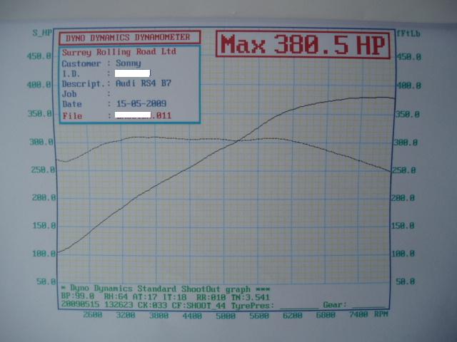

Im still running the original 2006 SW, and pulled 380.4 on the Rollers (APS Generic map only mod at the time). surly mine being an old car with 28k miles on the clock would or should show a lower performance out put. Just goes to show how sensitive these engines are.

sonny wrote:Im still running the original 2006 SW, and pulled 380.4 on the Rollers (APS Generic map only mod at the time). surly mine being an old car with 28k miles on the clock would or should show a lower performance out put. Just goes to show how sensitive these engines are.
first, using correction factors to determine crank HP is black magic :D
but I'm guessing wheel HP was 320-330 range or so, which is what I would expect...your car is fine, and probably has deposits similar to the ones posted (unless there was another fault in the engine)
do some 3rd gear, 3000-8000 rpm runs using the OBC
if ~8 sec, you are in good shape, actually better becuase a stock car runs ~8.4

Power was est flywheel figures, Surrey Rolling Road
