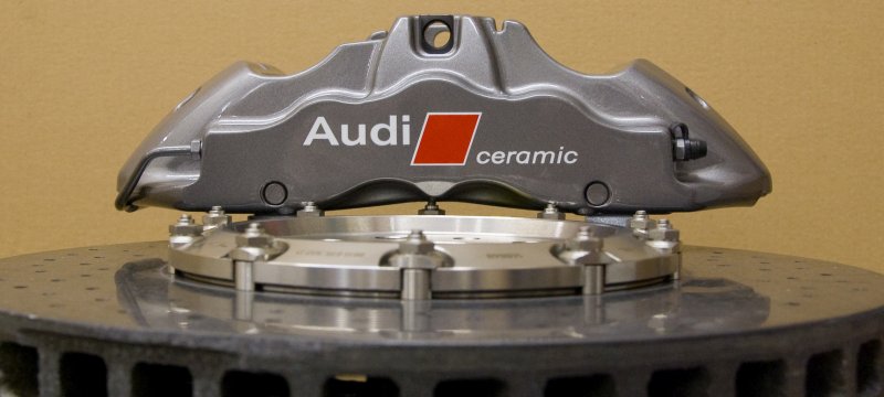

Hello,
I've been lurking here for some time and have received good information. I thought those with the ceramic brakes can answer my question. I got my hands on an OEM RS4 Ceramic Brake Package (cailpers & rotors). When installing, the rotors don't fit. They will actually go in too far and will touch the struts. Am I missing a part? It seems a hub spacer can correct this problem, but are they available for an RS4? Thanks in advance.

Thanks for the reply Sonny. I believe I have all the parts save two. I tried to order the Instruction CD-ROM from the dealer but they cannot order European parts (I'm in the US). I'm just not sure about one part: 4E0 012 251 B - tommy bar (an extra long alloy wheel assist spigot - replaces the standard plastic one). I don't know what this is and I'm fairly sure I don't have it. Does anybody know what I need to install these rotors? Thanks.

Thanks for the info on the tommy bar. Do you know why the rotors will not fit? Can you source the CD-ROM and ship to the US? Thanks.

stock suspension?
I don't mean to be flippant, but are you mounting them the correct direction (inside/outside)?
RS4 Ceramic Brakes-Rotors don't fit
Hello Arthur. I have the Stasis Motorsport suspension (highly recomend). I have confidence in the shop installing the brakes. My family has been using them for over 20 years. It should be fairly obvious which side of the rotor faces outwards because of the hats. I'll have more info when I receive the Instruction CD-ROM.
Re: RS4 Ceramic Brakes-Rotors don't fit
my guess, the suspension is different dimensions than oem, hence the interferencepaku wrote:Hello Arthur. I have the Stasis Motorsport suspension (highly recomend). I have confidence in the shop installing the brakes. My family has been using them for over 20 years. It should be fairly obvious which side of the rotor faces outwards because of the hats. I'll have more info when I receive the Instruction CD-ROM.
anybody on here with the ceramic rotors and aftermarket suspension?
I ask about the facing direction because I once installed an e46 M3 clutch disc backwards (I know, I'm a dummy

Good suggestion Arthur. I'll have to check with the technician and see what he thinks. I'm ordering the Instruction CD-ROM and hopefully that will give more insight as to which part(s) I need for a correct install.
