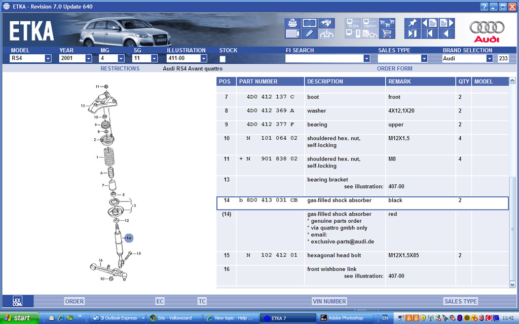

But seriously mate, ETKA says GmbH shocks are red so have a look

I have 1BD and my shocks are orangey red or at least they once were looking at the two very corroded fronts in my garage- does this mean they are GMBH?neckarsulm wrote:No don't call him, text him![]()
Re: RE: Re: RE: Help - Advise required re potential RS4 purc

Std RS4 shocks and GmbH ones are the same colour but a different part number. If you have Quattro GmbH your rear anti-roll bar will be 17mm not 15mm and marked Eibach, the springs are marked Eibach RS4 Sport HD.

ETKA says black=stock GmbH =red but it could be wrong, pic below
