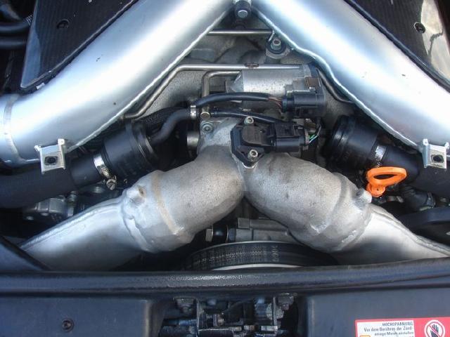

Post by LOWR1D3R » Mon Nov 16, 2009 8:23 pm
Plugs are now replaced with new ones.
There´s a second possible cause for this failure.
Broken joint. See pic.
Lil bit of welding tomorrow. :twisted:
jimbo1234567
Posts: 1411
Joined: Sun Jun 24, 2007 12:02 pm
Location: in the kitchen
Post by jimbo1234567 » Mon Nov 16, 2009 9:56 pm
get them all welded up. no more boost leaks mate.
davey
Posts: 225
Joined: Tue Nov 04, 2008 8:50 pm
Post by davey » Mon Nov 16, 2009 10:03 pm
jimbo1234567 wrote:get them all welded up. no more boost leaks mate.
my weld had a pin hole size leak in it :cry:
jimbo1234567
Posts: 1411
Post by jimbo1234567 » Mon Nov 16, 2009 10:13 pm
yes i got the cam cover brackets done at the same time and they had some pin hole sized leaks so i mixed up some araldite and put it on the welds then heated it up with a heatgun so the araldite went thin and flowed. as i was holding it at the same time i could control where the glue went. :nogarors4:
davs4
Posts: 635
Joined: Sat Jun 26, 2004 6:55 pm
Location: Oxfordish
Post by davs4 » Mon Nov 16, 2009 10:44 pm
Aviation spec silicoset I use.
