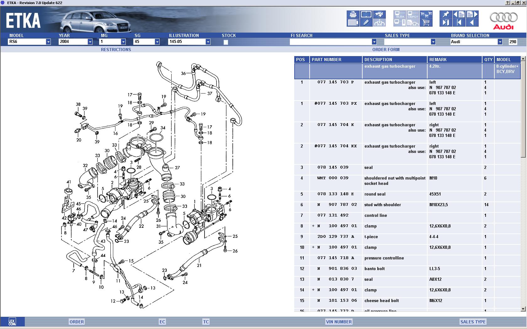

I have the etka sketch Attatching now. Car is fine after it has gathered boost, tested again my only issue is just below 2000RPM to around 3800RPM. Wastegate duty cycle is @ almost 100% trying to gather up the boost so I think N75 is ok. Leak in the piping is on the right hand side of the car/ left seems fine as you say it's behind the engine between the air intake and the turbo. IMO Audi should know their cars better in SA, with all the research i've done I think i'm starting to know more about these engines than they do
