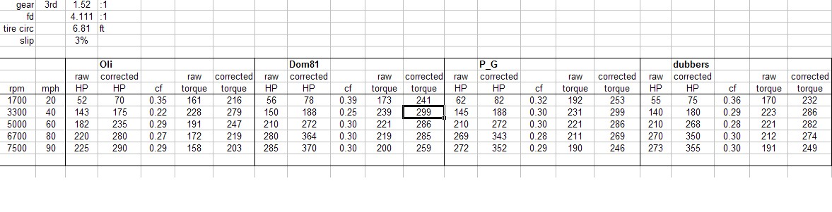

Dom81 wrote:
ArthurPE wrote: all 4 graphs make ~ the same RAW power at 40 mph (145 or so, the lowest being dubs at 140)), the cf's are different for the cars at this speed
Oli 0.22
Dom 0.25
P_G 0.30
dubber 0.29
You lost me at this point - can you put into (very) simple words please!
the wheel HP measured (actually it measures torque and calculates HP) by the dyno was the same (within 2HP from the average) for all 4 cars...but they each had a different correction factor for some reason...
so using the average wheel HP of ~145...if you use P_G's cf that equals ~188 at the crank...if you use Oli's that equals 177, >6% difference...for the same measured power....

Arthur,
comparisons at 40 MPH on a 3rd Gear pull are useless. RPM and airflow is low at this point in the curve. The throttle body is only open 50% at this point. Where you will see differences is in the "boost" that occurs between 4500 and 5500 rpm, when the short intake runner is switched in and (in some cases) the intake power flap is opened. In dubs case I believe he'll find a massive timing pull, either an intake restriction or obstructed flow at the valves. Something was not right with this engine when it when the throttle body opened.

40 mph in 3rd at at the engines peak output...~100% torque...
in fact for the 4 dyno charts I analyzed, it was peak torque...
HP is not a force, it's a measure of the rate of application of force...torque is a force and the instantaneous output of the engine...
although airflow DP is ~ velocity (actually v^2), the main points of pressure drop in an engine are the filter, and more so the throttle, hence the vaccum going to 0 when it's opened...other drops are minor...
and regardless, the engine will inhale ~ the same volume (for a given engine), it will just lose a bit more in pumping losses...
how can I upload an xls spreadsheet?
