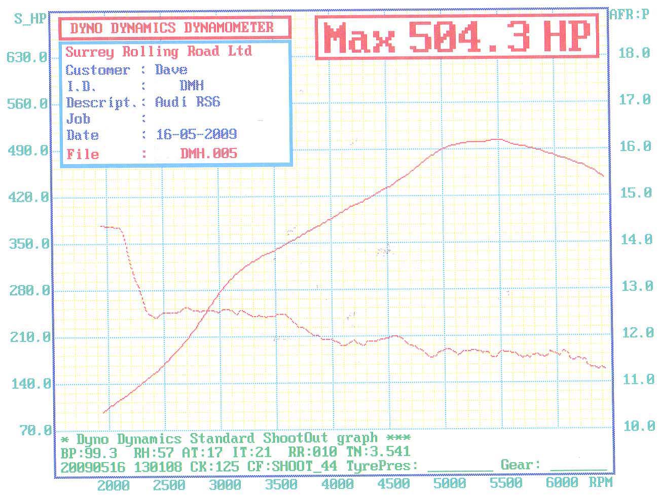

Got to Surrey Rolling Road today and crashed the end of a BMW forum meet. As you can imagine with the updated results below, I wasn't popular!
504.3 BHP, 517 lbf. Torque (700Nm)
Feels great to have broken that 'illusive 500'. Charlie sprayed some water on the intercoolers for the last run, did the trick!
I'll post up the printout later, thanks again to Lucas and the boys at MRC!

Printouts

I love the torque curve, nice and FLAT, yours is a really good one Dave. At least our maps don't need decats to get the BHP we claim
RE: Printouts
S2tuner, How come the BHP and torque drop off after 5500?
I thought the RS6 turbos flowed a lot more volume over the K04's on the RS4, yet that peaks at the redline?
Can the value be adjusted on your custom map?
RE: Printouts
golfather, RS6s always make peak power around 5500, after that boost starts tailing off because of the turbos being too small for the 4.2l engine. On an RS4 it's different because there's a smaller engine to feed with the turbos, and you can get loads of power until the redline.
If you get a full exhaust with decats, you can get a bit more power higher up, but the RS6 engine itself is made in such a way that high RPMs flow isn't great great, so you'll rarely see peak power at 6000 RPM IMHO and IME.
HTH,
Mihnea
