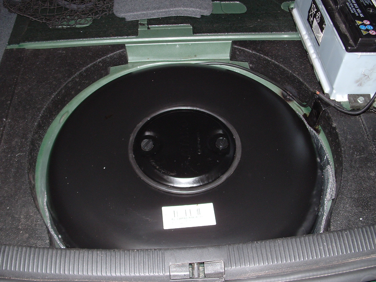

The valves are safe, the system dual fuels when the engine load increases so it won't lean off the mix, the system always starts on petrol so keeping the injectors lubricated, the valve seats are already designed to run unleaded so are not going to be affected. The motor sounds smoother on lpg and there is no injector noise.
My Range Rover has done over 50k on lpg with not signs of detriment , its a cleaner more efficient burn produces less deposits, this keeps the oil cleaner and so helps with engine life.
The tank is 60ltr actual 70ltr total (you only normally get around 55 to 60ltr into these tanks). On the last 4 fills the car took 54lts or about 12 gallons this is giving a little over 200 - 210 miles so average is approx 17ish, not bad then factor 42ppl - 50ppl and its the same running cost as 34mpg.
Temp location of battery RNSE will free up the space for the final move.

Looks very neat. I can see the battery, and I guess there's a small bag of bits (Jack etc) to lose somewhere. Only real downside is that I guess you lose the "flat back" in the Avant due to the battery.
