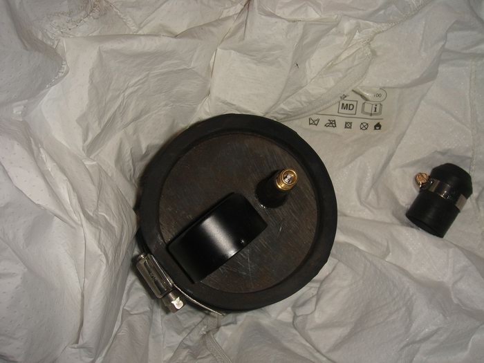

i got one off the bay last year. all you need to do is disconnect the pcv valve on the y pipe and block it off. crack the oil filler cap and make a fitting which goes in place of the accordian and has a airline connection and pressure gauge on it . noneed to block off the exhaust. il dig out a photo later

here you go

the little thing on the right is the pcv valve take off on the y pipe blank. when pressure testing you should go to 10 psi max as the intake pipes aren reall designed to withstand pressure. a little suction pump to check the dv diaphrams arent split is a good idea too

RE: Re: RE: Pressure testing DIY
Thanks for your help and for providing the link and pictures.
As you say a simple piece of kit to make. I'm surprised that you only test up to the throttle body, i would have thought that the numerous small pipes to the rear of the inlet manifold could be prone to leaks?
How does this test pressurise the crankcase? without the exhaust plugged it will pass over any open valves and out to atmosphere.
I guess to test all the small pipes it would simply mean blocking the exhaust and pressurising the complete engine which is how i do my ur.

the inlet and ex valves have an over lap which stops the pressure going straight through. the crankcase gets a small amount of air in past the piston rings. you release the filler cap so it doesnt get pressureised. if it did it would blow a seal

Re: RE: Re: RE: Pressure testing DIY
I understand fully about overlap and the fact that it is small on a turbo charged engine to prevent wastage of boost.jimbo1234567 wrote:the inlet and ex valves have an over lap which stops the pressure going straight through. the crankcase gets a small amount of air in past the piston rings. you release the filler cap so it doesnt get pressureised. if it did it would blow a seal
But to have this at the same time on all cylinders would be impossible without the removal of all cams to ensure all the valves are closed.
