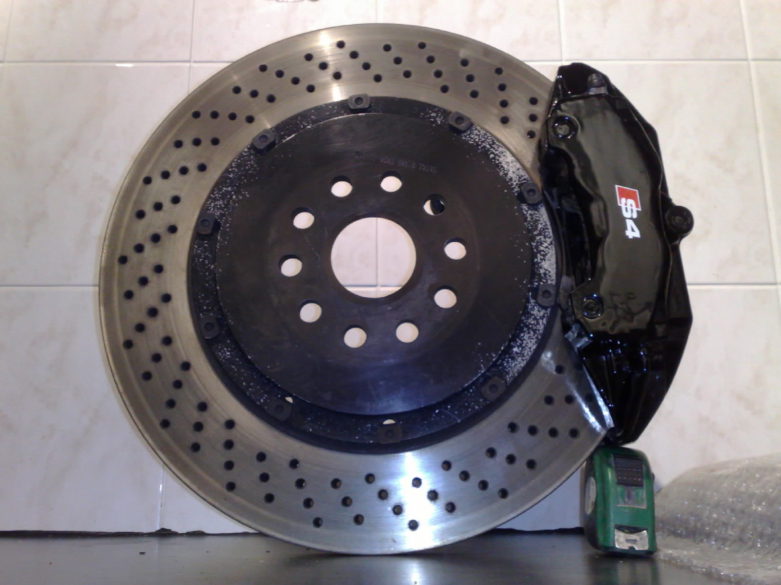

Post by rosshyslop » Thu Nov 13, 2008 8:21 pm
Yes the B6 brakes will fit under the standard S4 wheels etc. Had them on my car but upgrading now to brembo 4pots and 380mm discs. PM me if your interested in them.

RS4 B5 brakes will fit onto the S4, BUT you will need to have 18 in wheels :D

offset is your biggest issue, the RS4 calipers need a good amount of clearance and normally run on ET20 wheels,
I tried 10mm and 15mm on standard B5 ET43 wheels and they were too close. it depends on wheel style as there is masses of room inside.
they bolt straight on but you need to address the hose length, TBH anyone not going up to braided when doing brakes is wasting money IMO.
The B7 RS4 upgrades are listed in details on the RS4 B5 page (pricey though) these are the guys you will source cheap B5 RS4 parts from.
I got a full set of B5 front and rears with very good front discs and brand new rear ones for £300 (inc all hoses). Sold the front for £250 to a chap in Spain. shop around, there are some bargains out there!
There are some VW Phaeton/Toureg 360mm disc options to keep costs down, these all fit the B5 RS4 front calipers
not sure what the S4 runs with regards to disc size but I would say RS4 is the way forward for anyone looking for a cheap uprade.
I am now running ET24 B7 option wheels (19mm inside stock) which then creates arch issues, which I thought I had dealt with but the guy who rolled and pulled my arches didn't take into account of tyres. it has KWV3 coilovers so is pretty solid and rubbing isn't an issues but it looks a little on the chunky side

The RS4 parts will not fit under 17" rims.
If you want to keep your 17" S4 rims the biggest you can goto is the 345mm B6S4 parts
