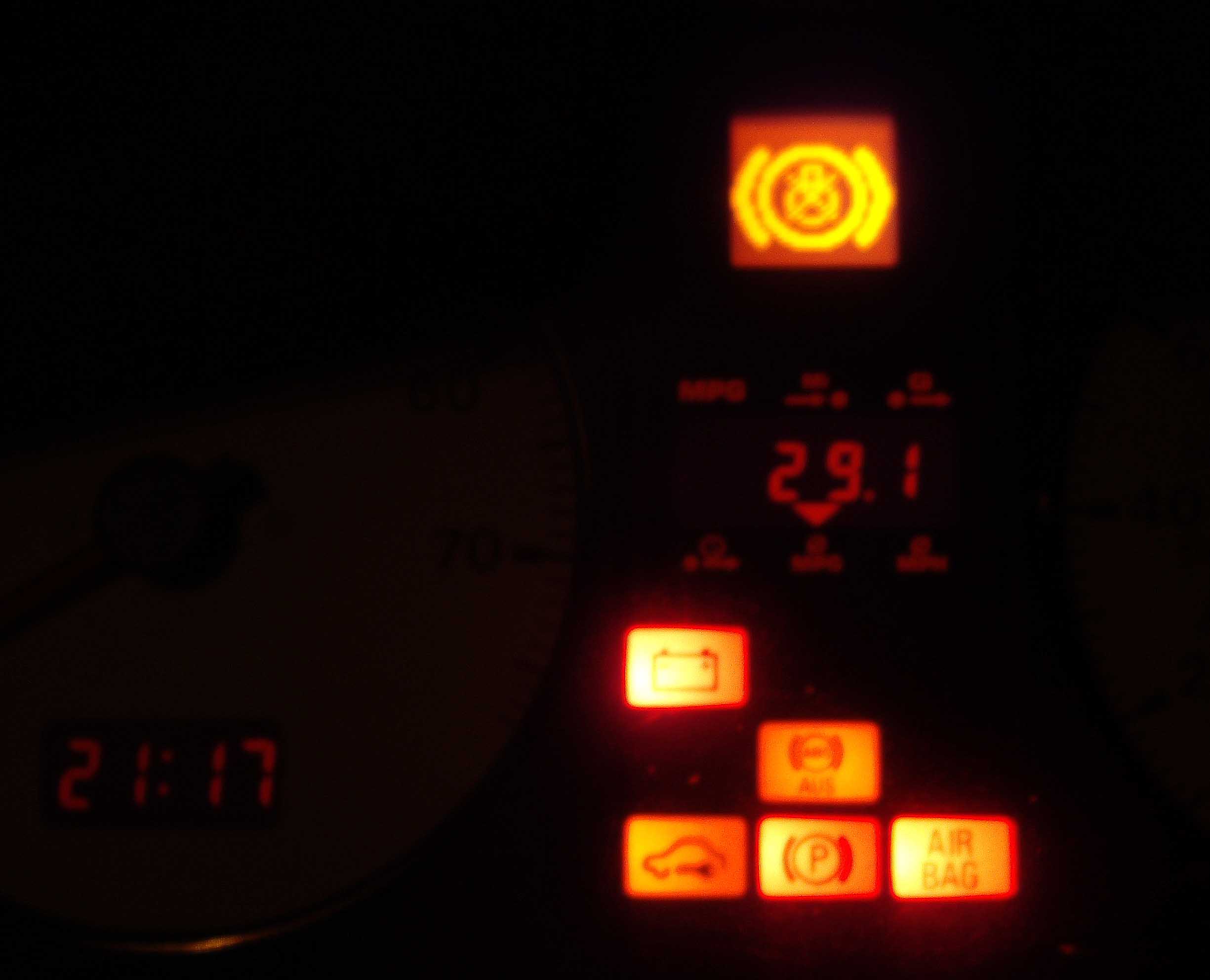

Can anyone please tell me if I'm getting the right amount of check lights on ignition?
This is what I see......
Simon

whats the lower left?i dont have it!

Vasaudigreece wrote:whats the lower left?i dont have it!
Hi Vasillis,
Lower left light is for the OEM immobiliser, ie the black ring around the main ignition where your key goes. If it's lit up all the time it means you've blown your immobiliser. You car will then start for a second or two before shutting off. Easiy done (and expensive) when jump starting the car.

ahhhh thats why...
i dont have a factory immobiliser,i have better though.But still nice to know!
