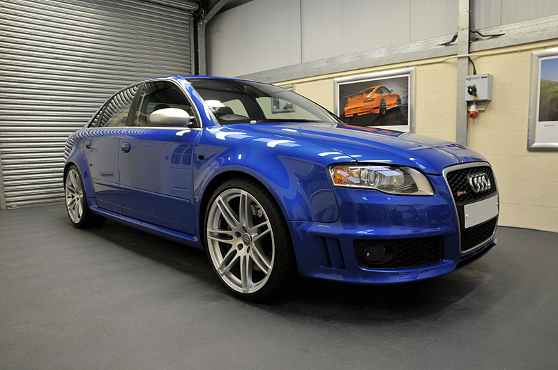

Post by S4GFO » Fri Jul 18, 2008 8:32 pm
I have the 20" S5 wheels on my RS4 saloon, they are the correct offset ET29 but the centre hole size is 66.6mm rather than 57.1mm so spigot rings are required and you also need 8mm spacers at the front to clear the brake callipers.

Post by Virdee Autos » Fri Jul 18, 2008 8:38 pm
Is it me or they don't curve as much towards the middle of the wheel(?)
Looks great anyhow!

Post by P_G » Fri Jul 18, 2008 10:45 pm
IIRC you are right, they are not as concave. Did toy with upping the wheel size on mine, however I'll go the lowering of car route to fill the arches, save spiggots and spacers and increased component stress levels.
