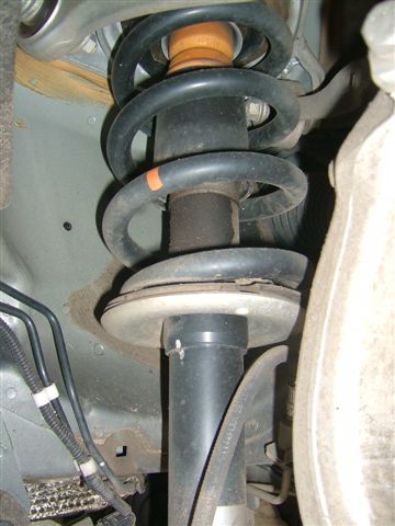

Had front wheel off at weekend - I think this means that I've joined this not so elusive club. Haven't noticed any knocking yet. Booked car in for a service on 17th July so plan to leave getting it checked until then unless anybody has good reason to suggest other wise.
