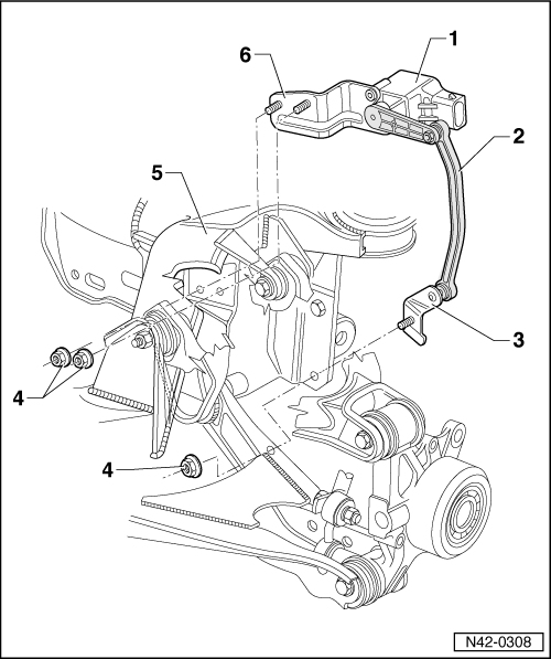

If anyone has a pic of the rear sensor (nearside) pic (preferably with the wheel on the ground). It's visible from under the left exhaust tip.

Best I can offer are these pics. I will take a proper pic and upload soon. It is linked to the rear of the rear nearside, lower suspension arm. You will see a metal link connected to a black servo like arm. IIRC it's just behind the rear left silencer.

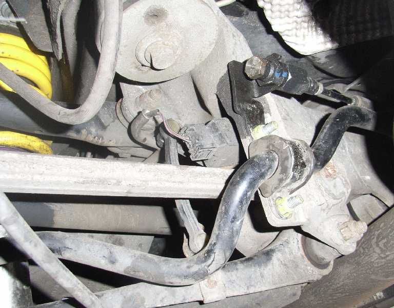

Post by bigh » Wed Nov 07, 2007 3:50 pm
I think this is right?

Post by GardinerG » Wed Nov 07, 2007 4:03 pm
Yep, that's the one! Cheers Howard. Mine is quite a bit up on that. I will have to take a pic and post it. It proves the point that when stock the black bar is almost horizontal. You don't have VAG-COM do you?

Post by bigh » Wed Nov 07, 2007 4:13 pm
Forgot to mention the car is on a slight downward facing driveway, will that effect the angle of the balck bar? If so i can move the car and take another piccy

Post by GardinerG » Thu Nov 08, 2007 1:43 pm
Hmmm, well I've been looking at the pic of my rear sensor and it looks like the sensor itself is pointing down/not straight:
I will have to get the wheel off and have a closer look!

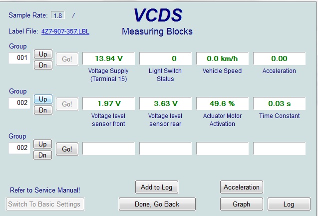

Did you ever get a fix for this? I have been able to adjust my xenons in the past with no problem but this week it won't allow me to store the new position. I too am on KWv3s that are less than 10mm lower than stock.
Here are my readings...

Post by el_ringo » Thu Jan 07, 2010 12:32 pm
I can move the light level with no issue. When I then try and get the computer to store this postion I get the error so then that throws that headlamp warning which is annoying me.
