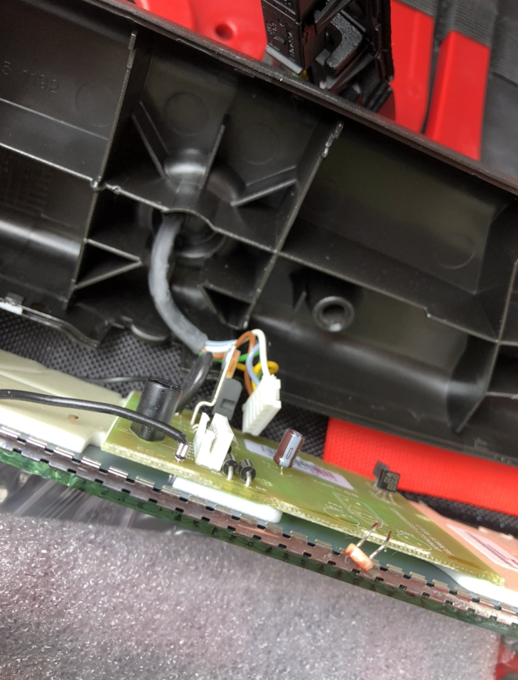

Once the glass retaining trim is off the glass will move forward, you can then access the connection block. Give this block a little wiggle and it will pop out.

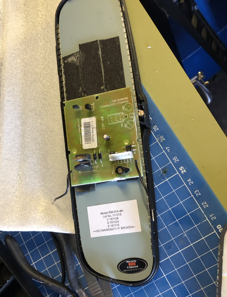

Now you have the mirror away from the housing you’ll need to separate the control board from the duff glass.

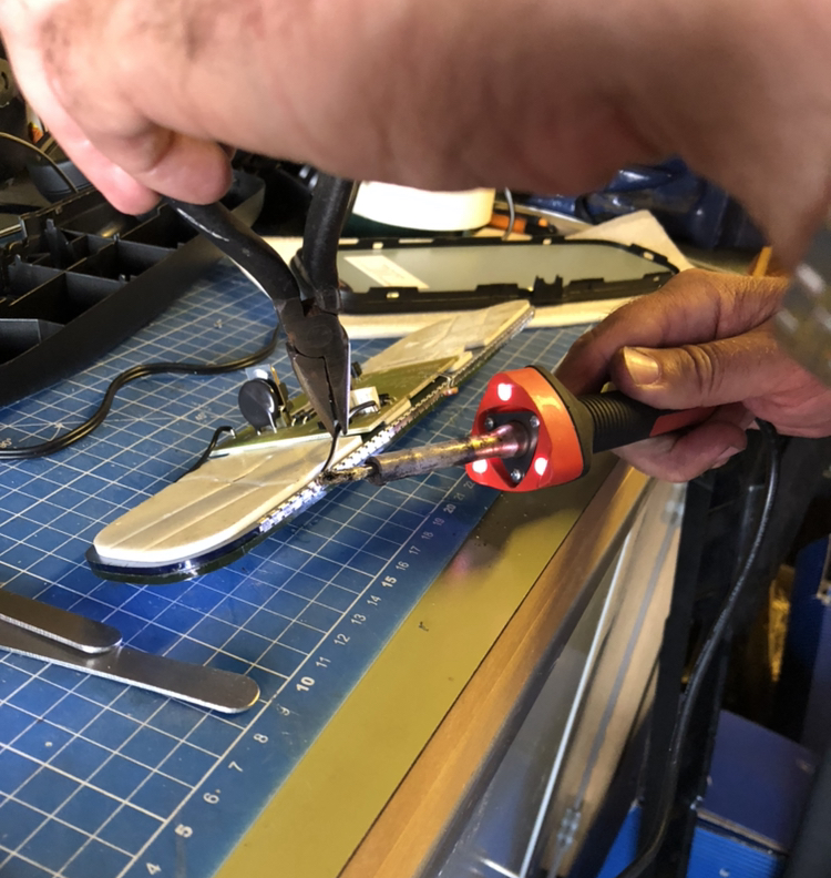

Simply use your soldering iron to heat the existing solder a separate the cable from the glass contact point.

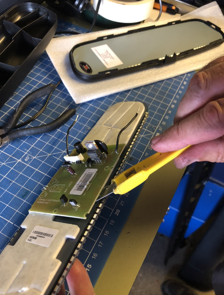

Now gently work the board away from the old glass. You can use a knife or fishing line. Whatever you use TAKE YOUR TIME!

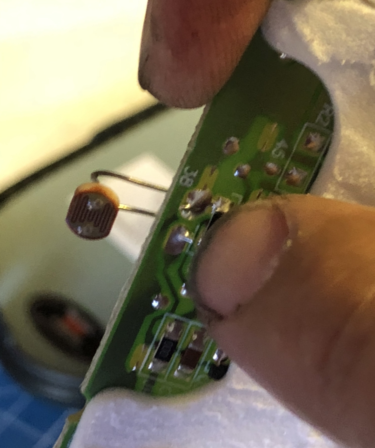

Now John suggested checking the light sensor solder at the board, apparently this can be problematic and is worth checking now. Give the sensor a very light wiggle. There should be no movement in the solder or sensor. If there is you’ll need to clean up this solder and reapply.

Now resolder the boards wire to the new glass connection points.

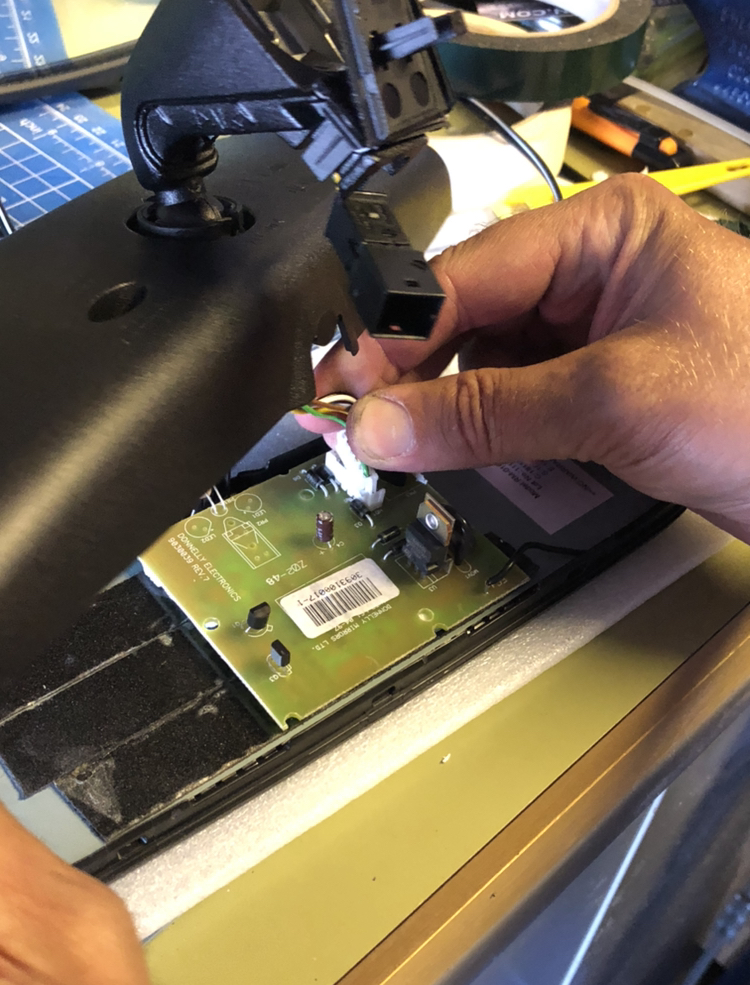

Reconnect the board to the housing, making sure that it goes the right way round.
Reassemble the mirror housing, connect the mirror cables at the windscreen and refit the mirror (this was even harder to refit than remove.

4) when re-soldering the wires back onto the mirror, remember to solder to the top face, not the outside edge, the glass & the metal contact strip is very neat in the plastic housing.
