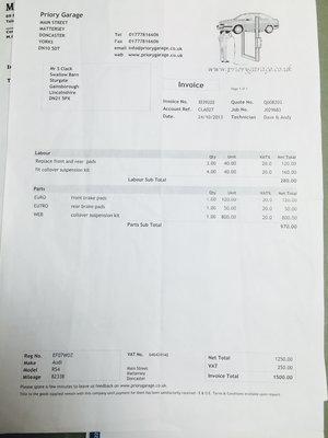

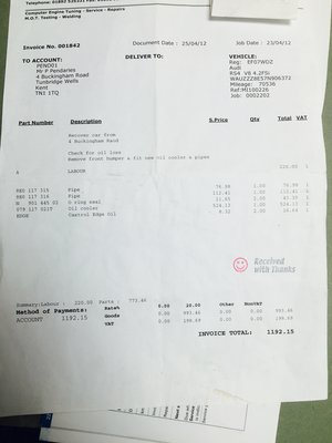

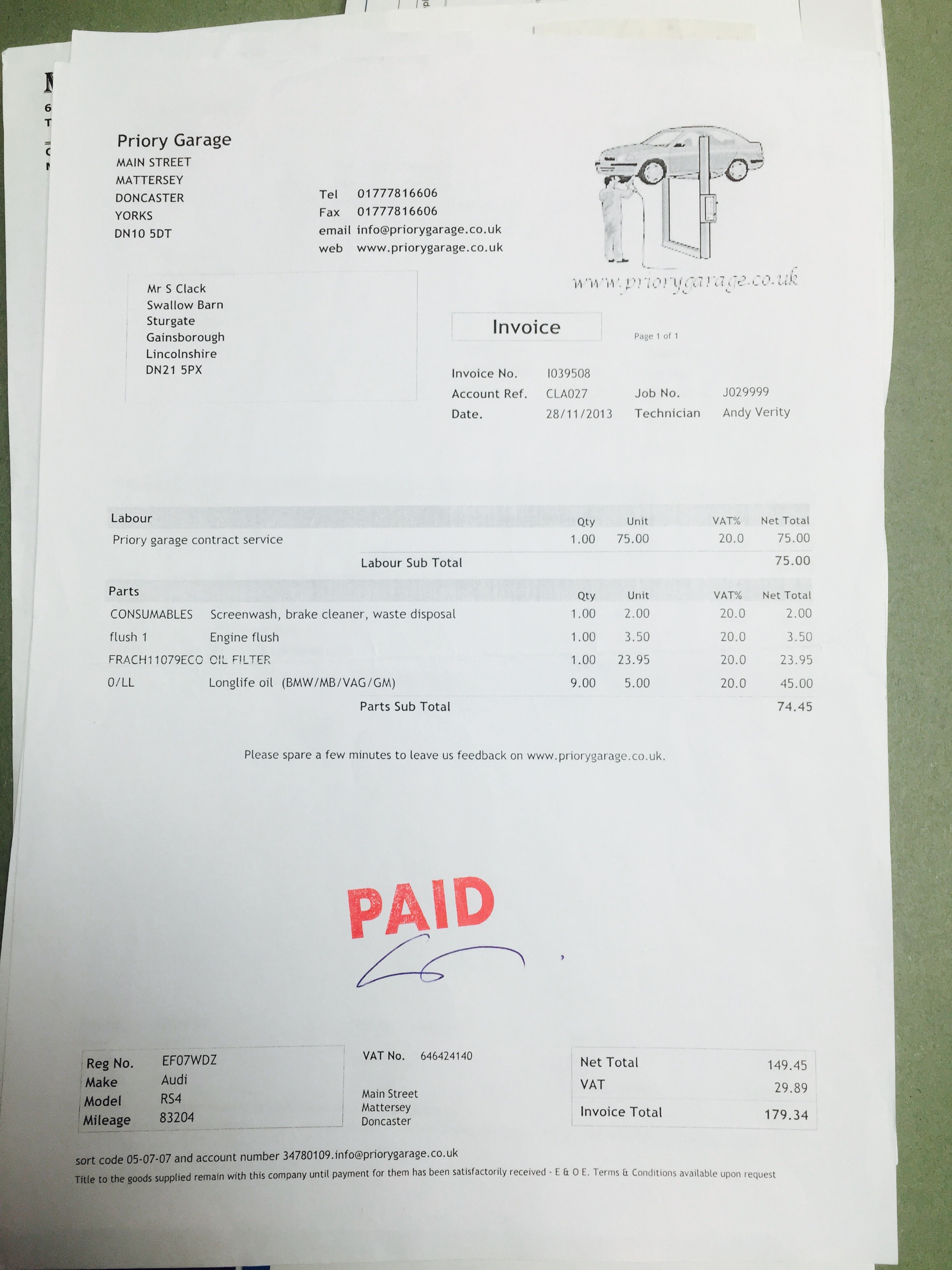

The seller emailed me service history and work carried out which I've attached here, had a look at the Priory Garage Doncaster, online and they don't seem to be an Audi specialist which is worrying me, and labour seems cheap, or perhaps I'm too used to London prices, does anybody know of them? And is there anything else that jumps out at you?
Also what's people thoughts on and RAC check, as you might have guessed I'm not very experienced with knowing about the workings of a car, (just love driving good ones) so keen to get a second pair of eyes on it before I drop £20k.
Thanks All!
Ed
S4WON
Posts: 1775
Re: Do you know this RS4?
Post by S4WON » Sat Aug 01, 2015 11:30 pm
Im always suspicious about handwritten service "stamps"
That one also doesnt have a flat bottom steering wheel which id want
I love the way the stealer says the car has been maintained regardless of cost - he forgot to mention it was carried out at the famous audi specialists - priory garage..
Nah, id avoid.

No way would a main dealer hand write a history entry, there is also no record of a plug change either.
Post by MikeFish » Sun Aug 02, 2015 12:02 am
To me that one looks like it was maintaind on a tight budget... not many 'stamps' and also some are not even main dealers or well known specialists.
