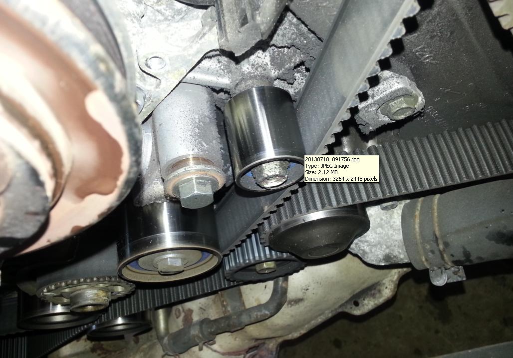

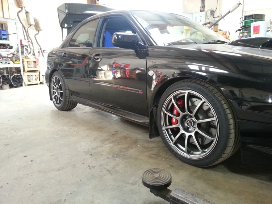

New clutch is in, car is sitting back on the ground again on the raised (if you say so) suspension. Those wheels have got to go, look too small and look too far in, sigh.....
Picture of the tensioner bolt that caused all the engine drama, good job.......
Will see how well my sales of ll the parts I have stripped off Fluffy go before biting the OZ bullet with MORE new tyres too.

Re: Nostalgia attack, can buy back my favourite car I sold
The wheels look good to me. You sure you need to change them?
No they just don't to me. They look too small and too set inside the arches. I need something right in between the too wide gold rotas that were on there and those, filling the arches perfectly like the Superturismos on the 6 ideally.
Agreed Stretch, the wheels don't look the best. You was one lucky boy with that tensioner!
