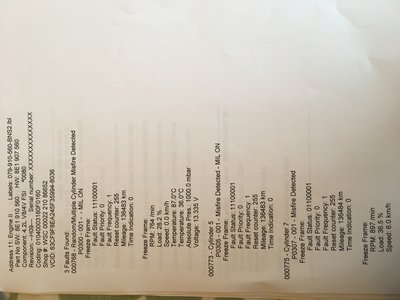

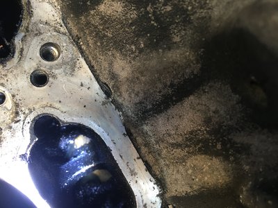

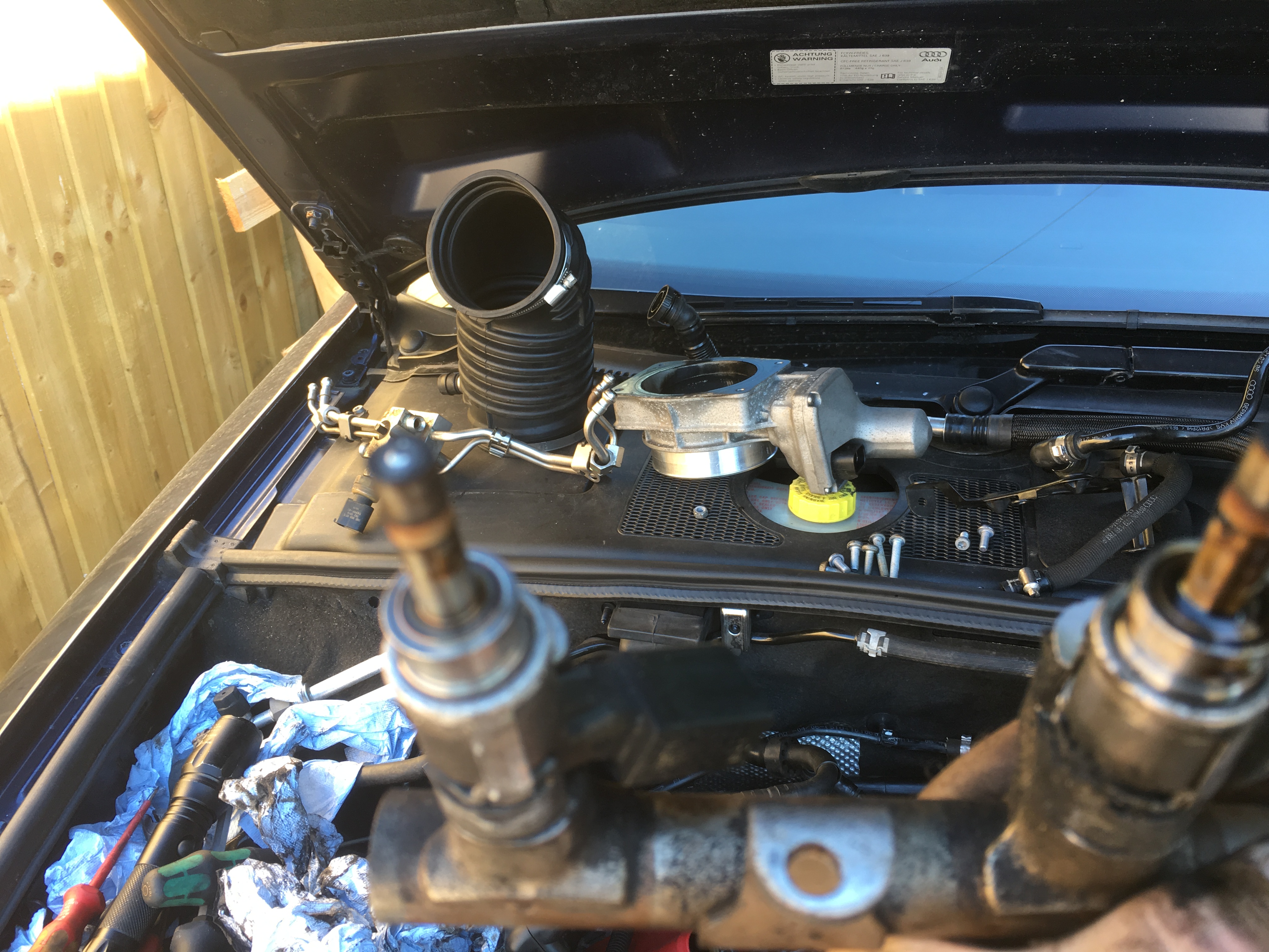

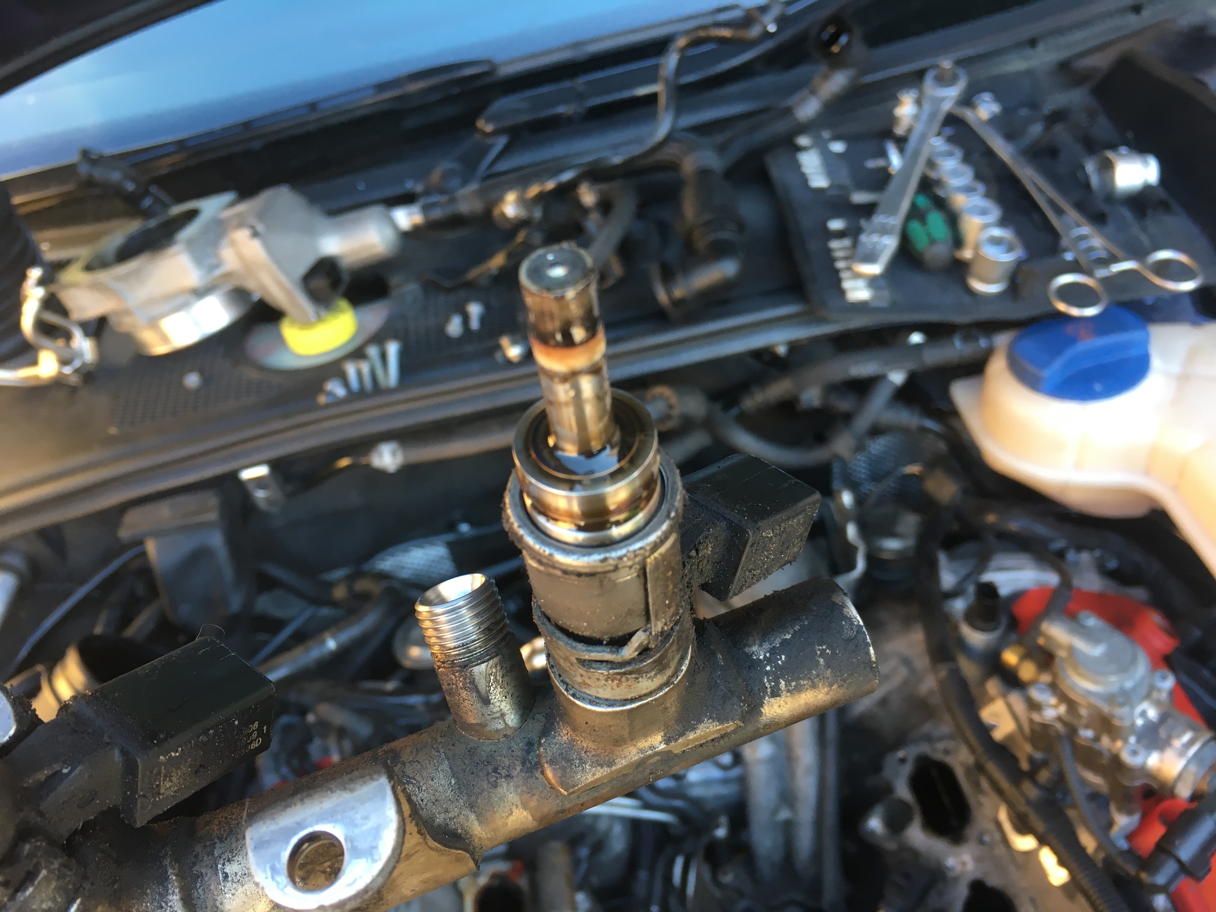

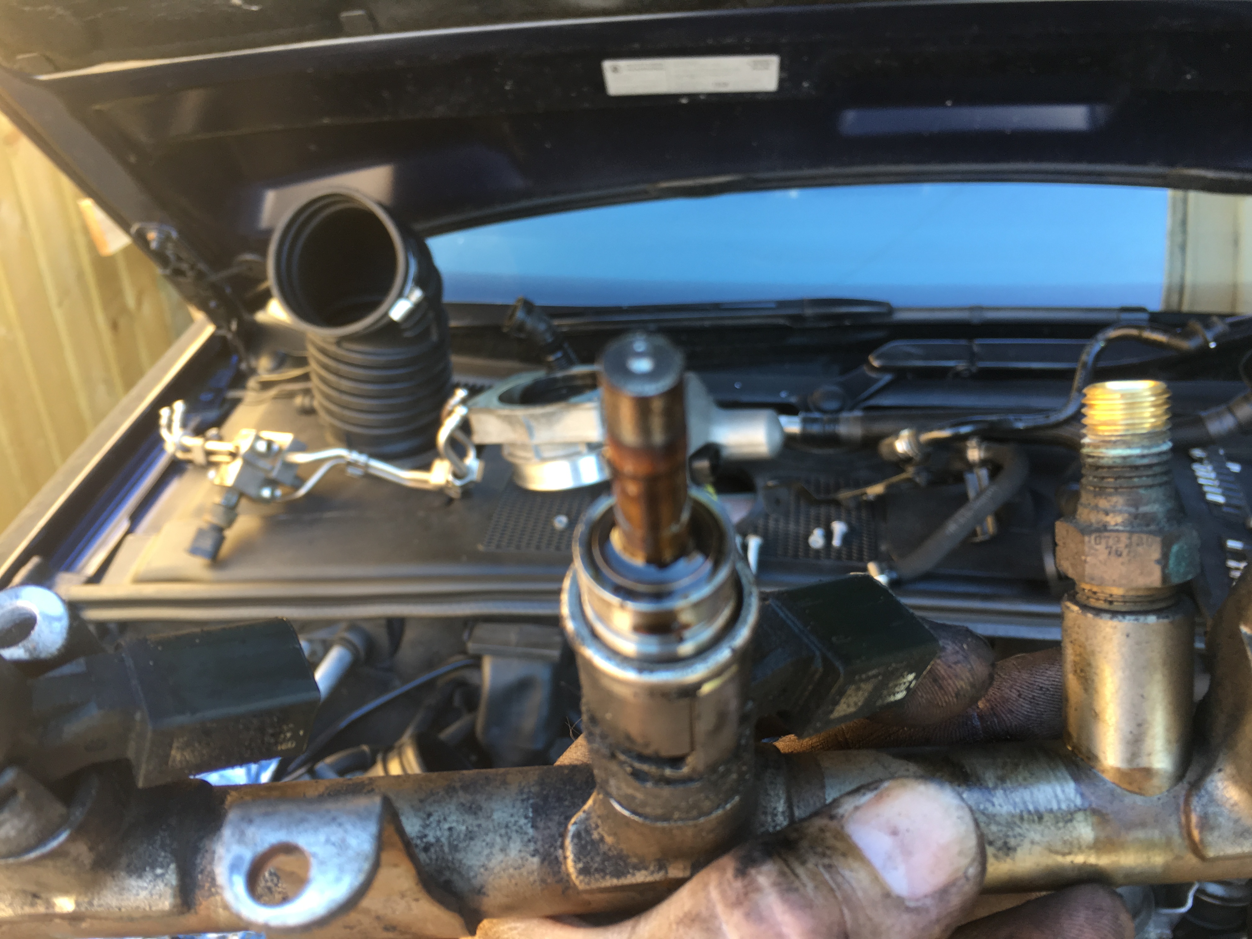

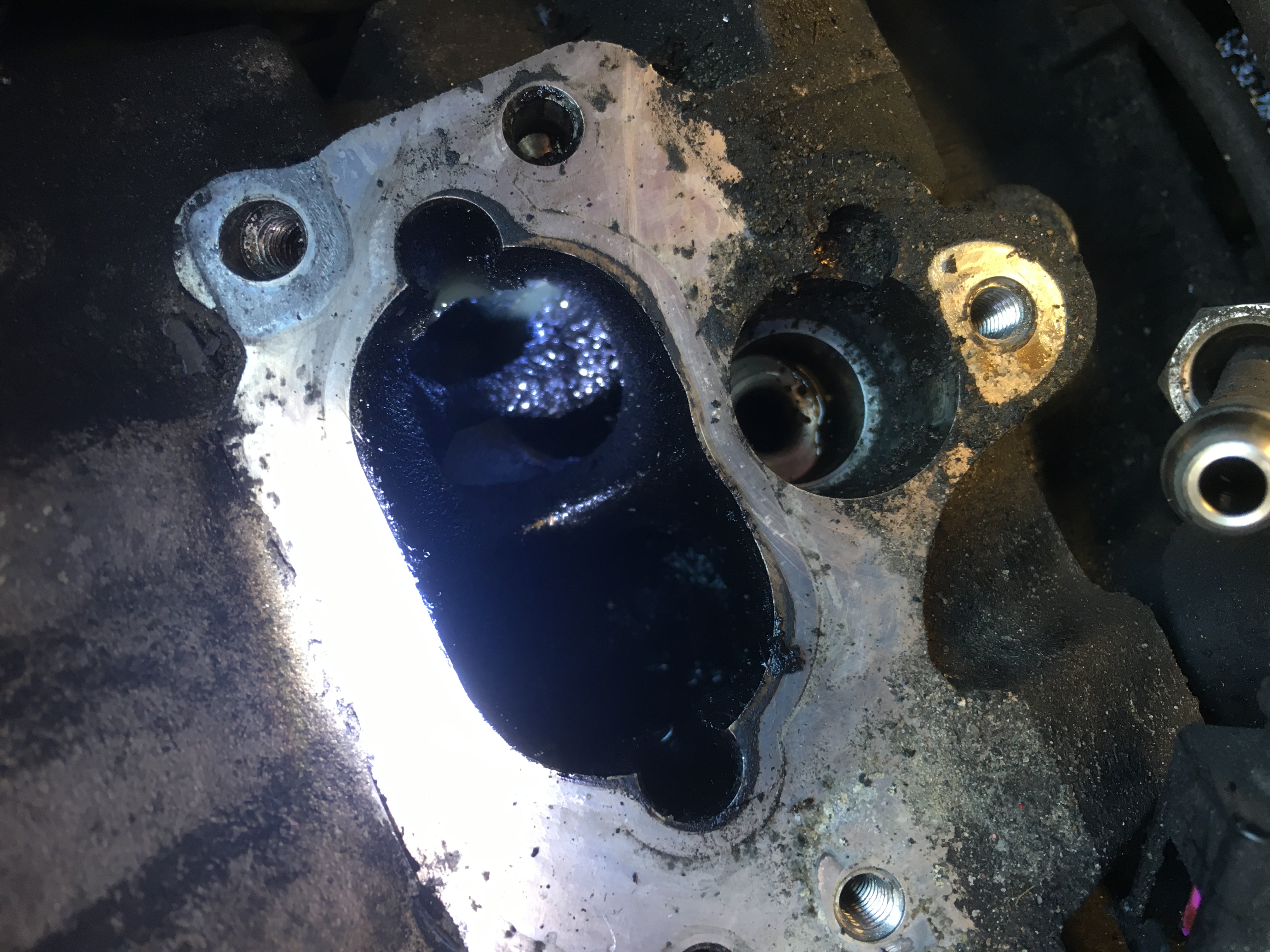

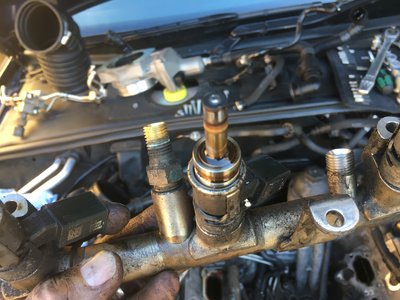

My RS4 B7 is poorly she's running quite rough and on idle she's occasionally hunting. She has been on vag-com and she is missing on cylinders 5 and 7. I've just changed the coil packs and spark plugs on both cylinders but unfortunately it's made no difference
Would love some advise on what to check next.
