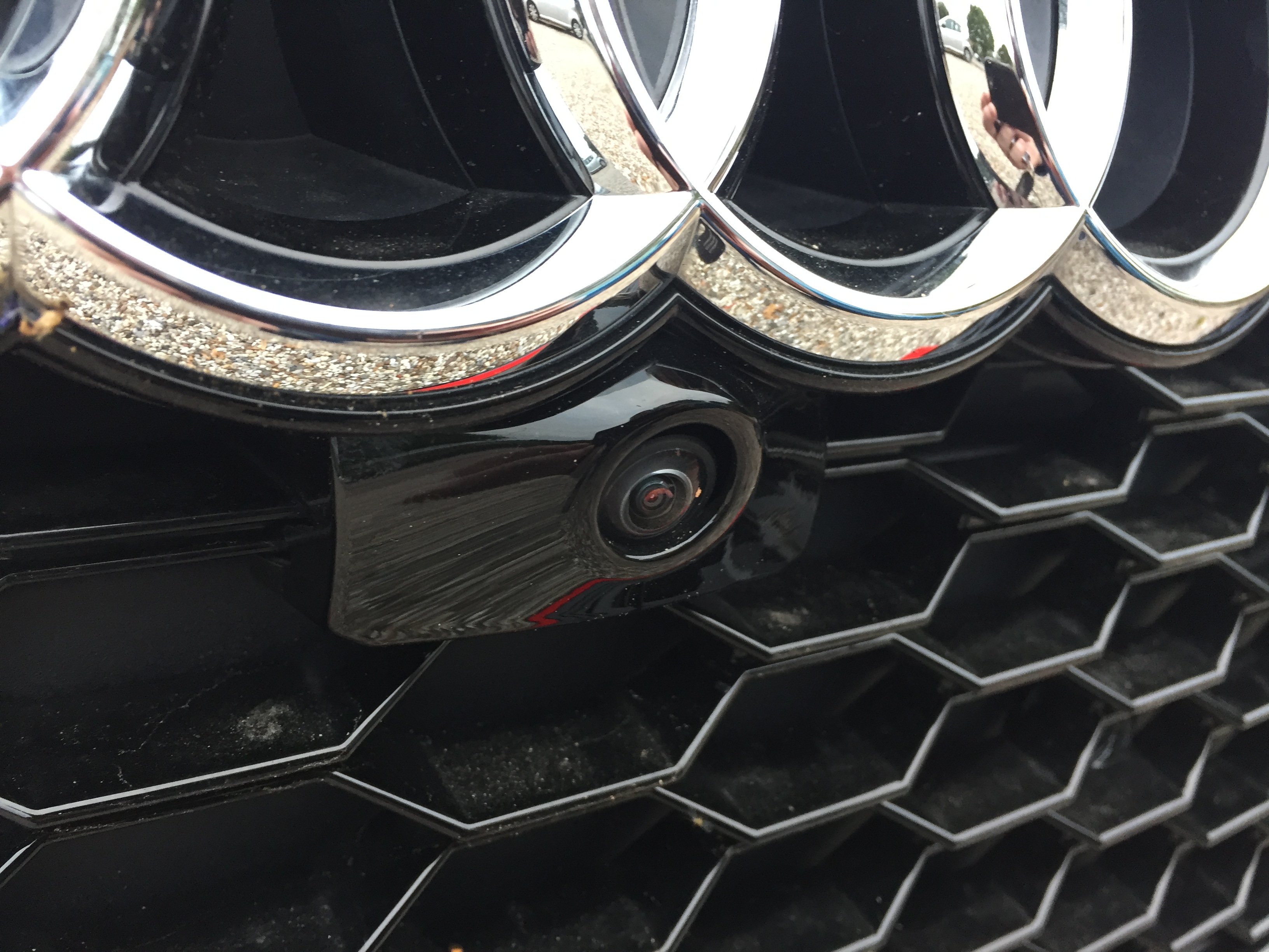

Could someone please post a couple of close up photos of the front camera under the badge if the grill (if you have one) I am retrofitting front and rear cameras and having trouble with the front one.

No one got a front camera? really stuck with this as Audi don't even have the camera cover listed on Ekta, I want to know if the camera cover is part of the grill or separate.

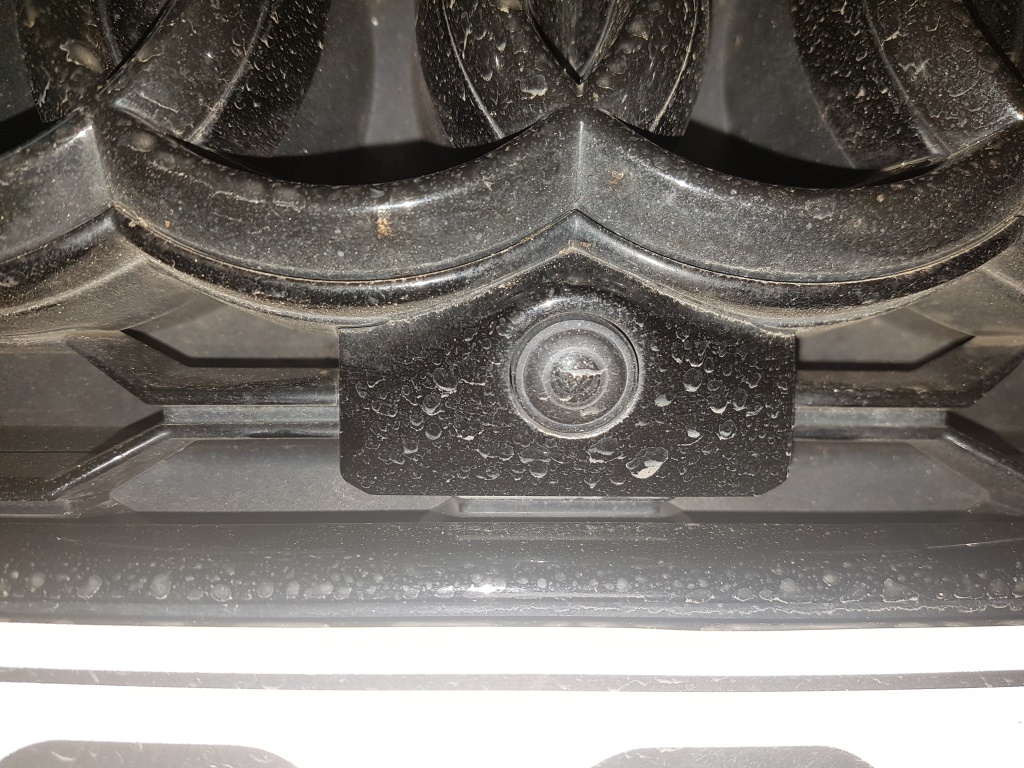

Took these the other day but not sure if they are of any use now...

Thank you that is very helpful, can see it is not part of the grill now, I think it is part of the Audi emblem (4), as you can see from the diagram it doesn't show that partImage

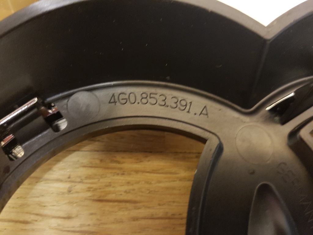

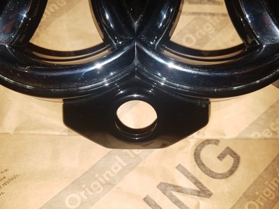

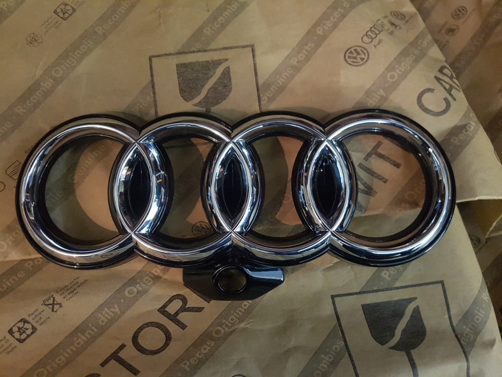

The spare one I have is for pre-facelift which as you can see below comapred to the facelift one on my car, they are clearly different.
Part number for pre-facelift is 4G0 853 391 A
Pre facelift

If I had to hazard a guess, based on the position on the facelift one in the parts list, I'd say the facelift one could very well be the 4G0 853 391 C.
