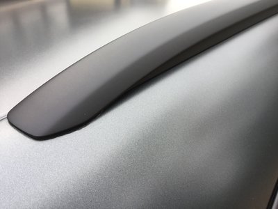

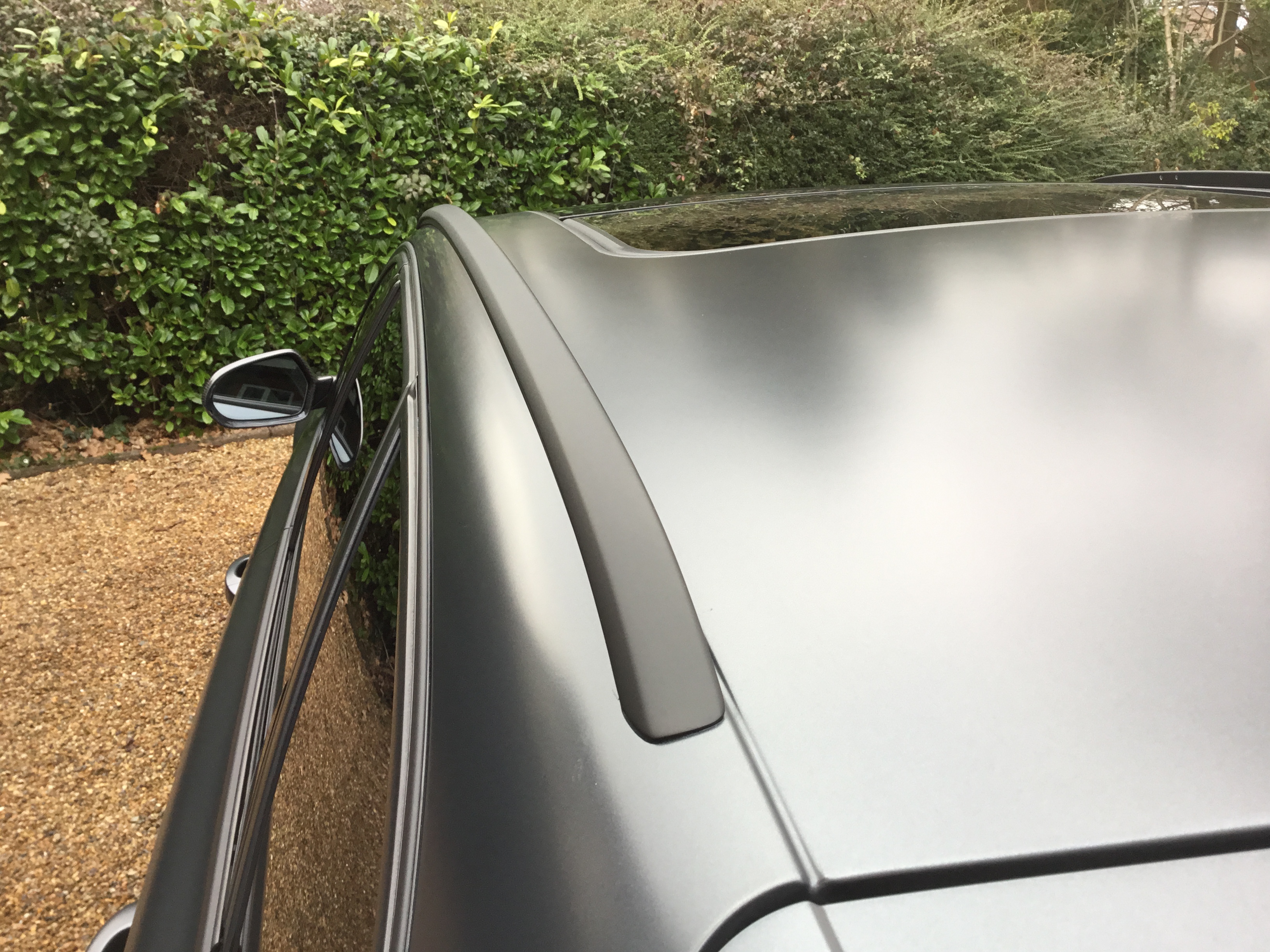

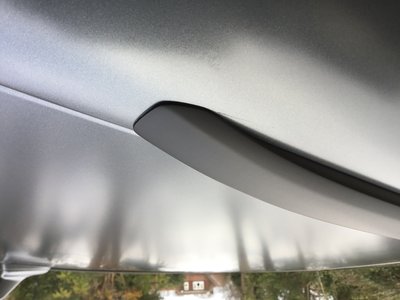

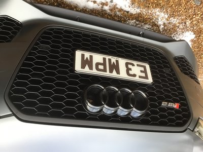

Mate is all very easy to sort for sensible money. Roof bars front grille window surrounds front splitter and side things all wrapped front rings black bought from Audi badges perfect fit same for rear rings and RS6 badge oops nearly forgot same for front `RS6 badge. I'll add a pic of mine so you can see

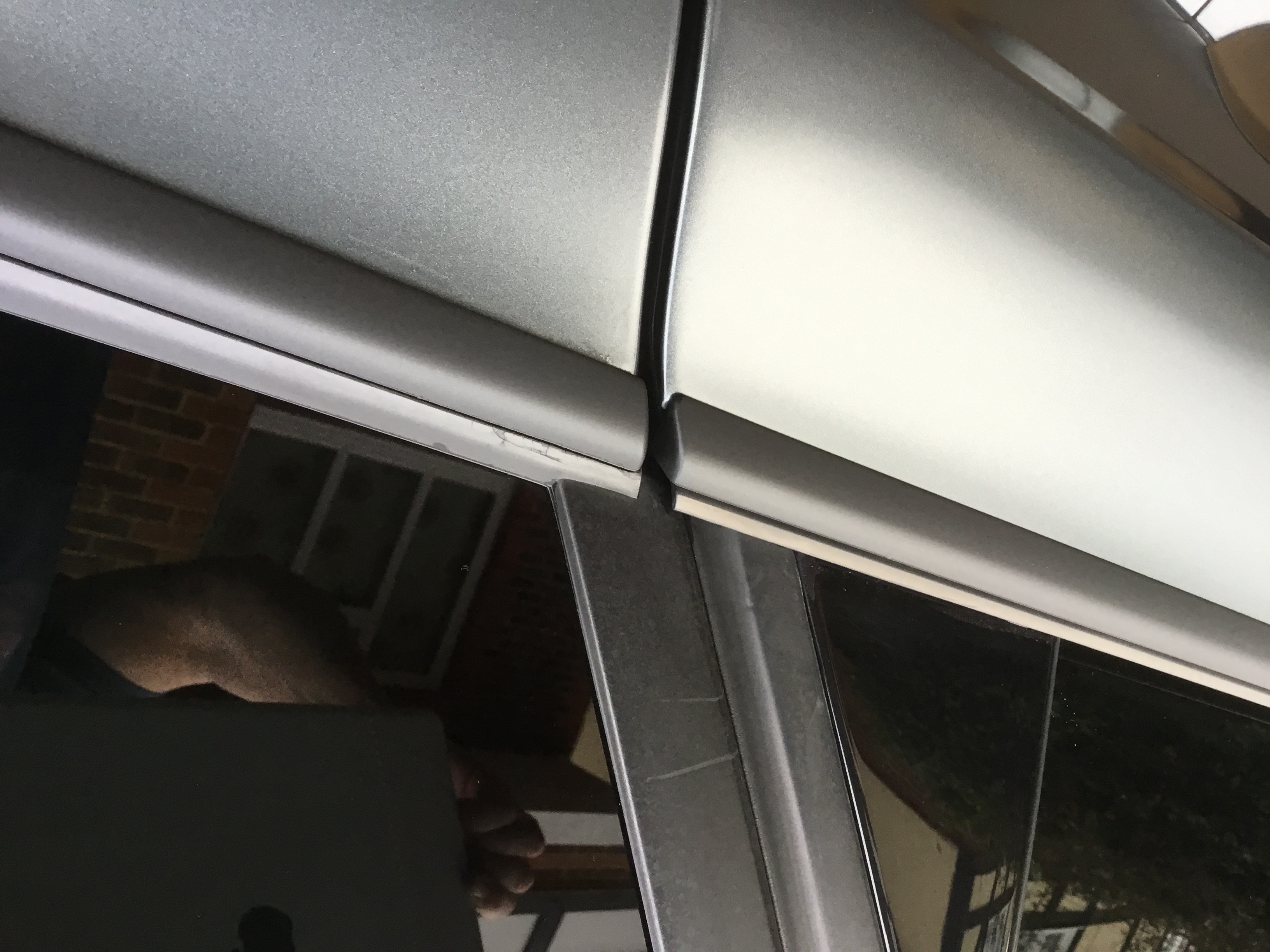

Window trims look like they just clip off so easy to change, but I think they are very expensive to buy. Wrapping or spraying is probably a cheaper option.

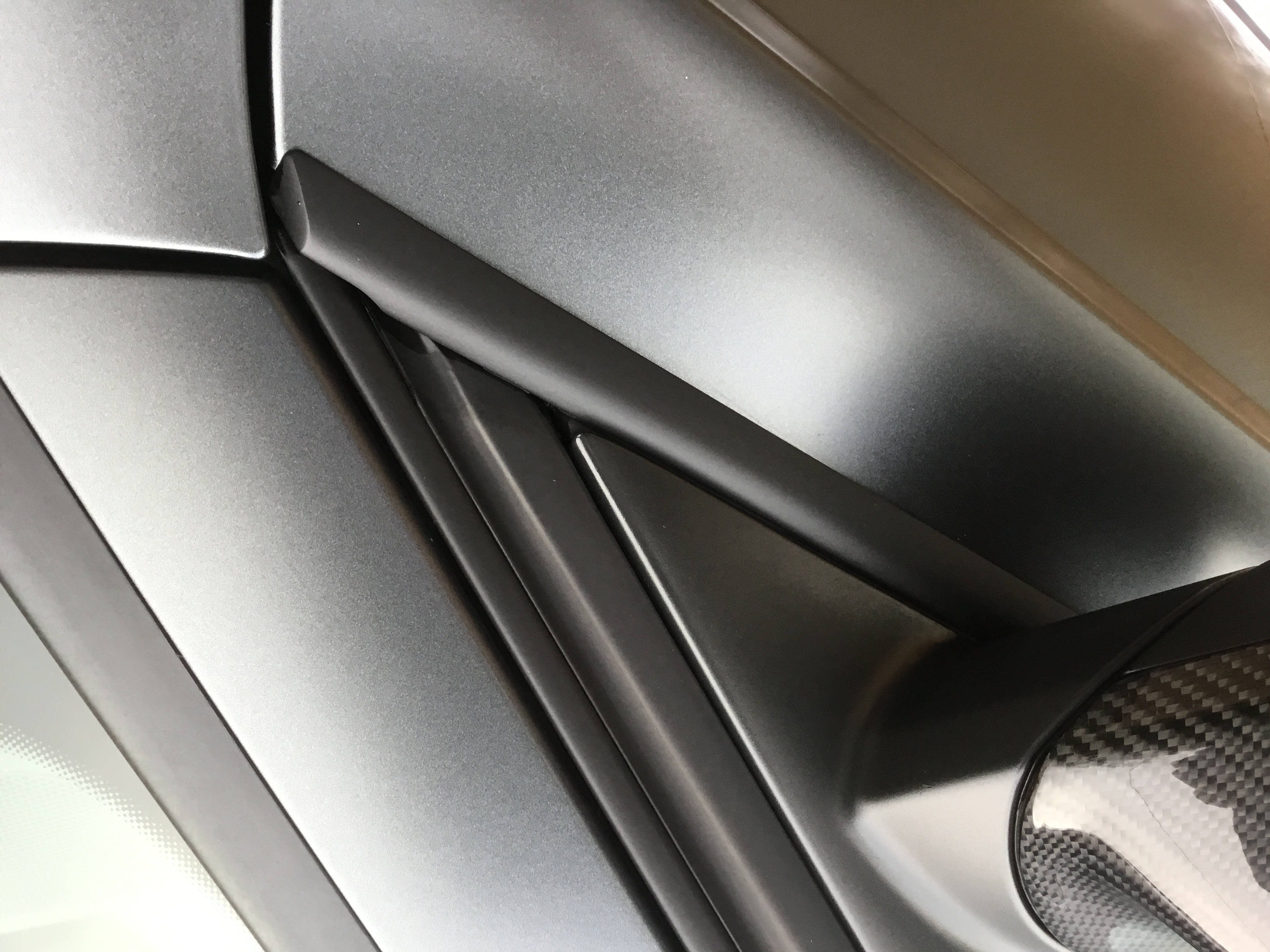

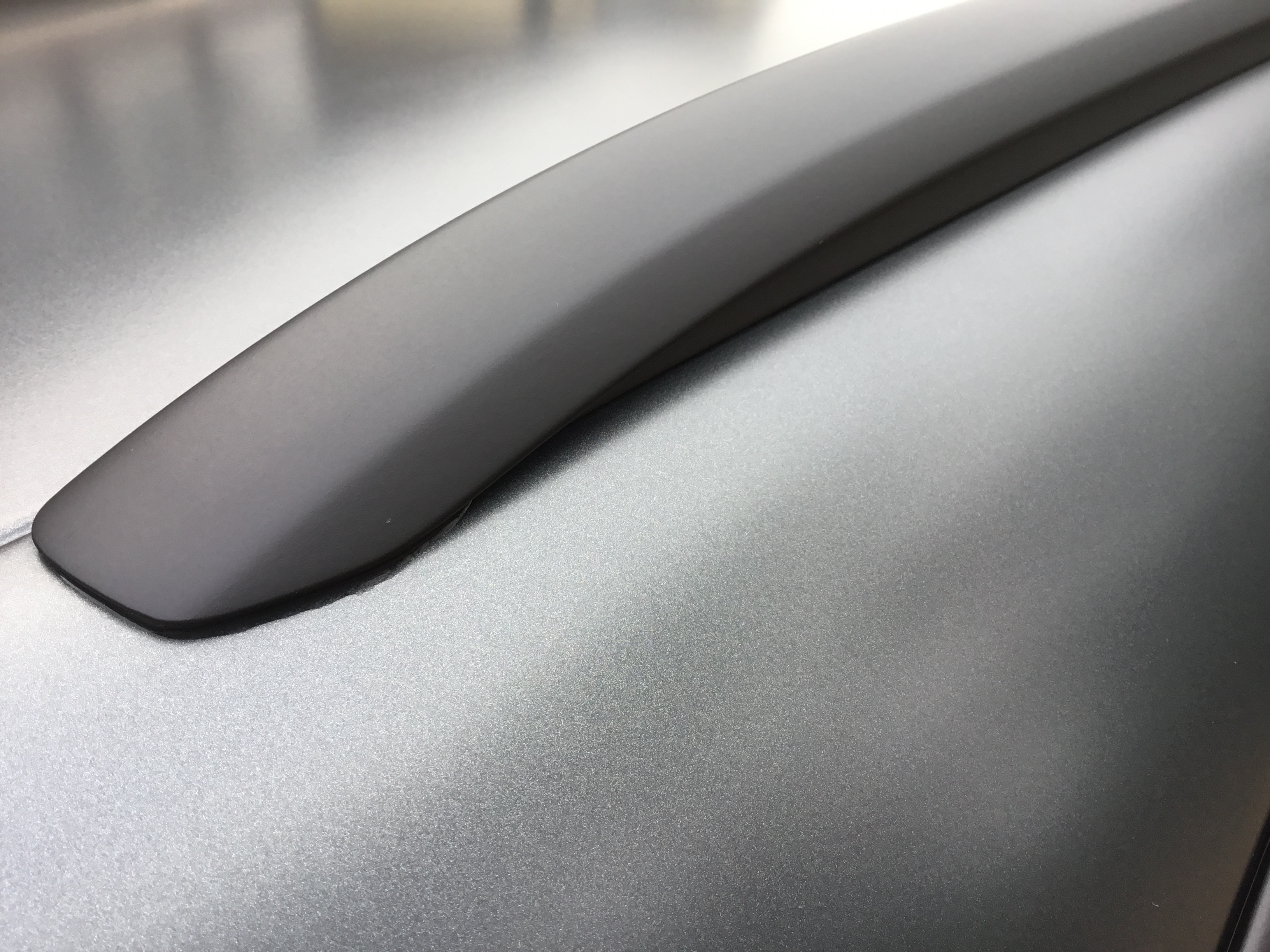

Roof bars wrapped in place along with front grille front splitter window surrounds easy to unclip and wrap. Wrap every time for me much cheaper and when you sell the new owner has the option to remove if they wish. Come and have a look at mine if you're not too far away

I did think the front bumper inserts looked like they might be impossible to wrap tbh and Thought the roof bars especially might not work with a wrap as you could see all the joins..

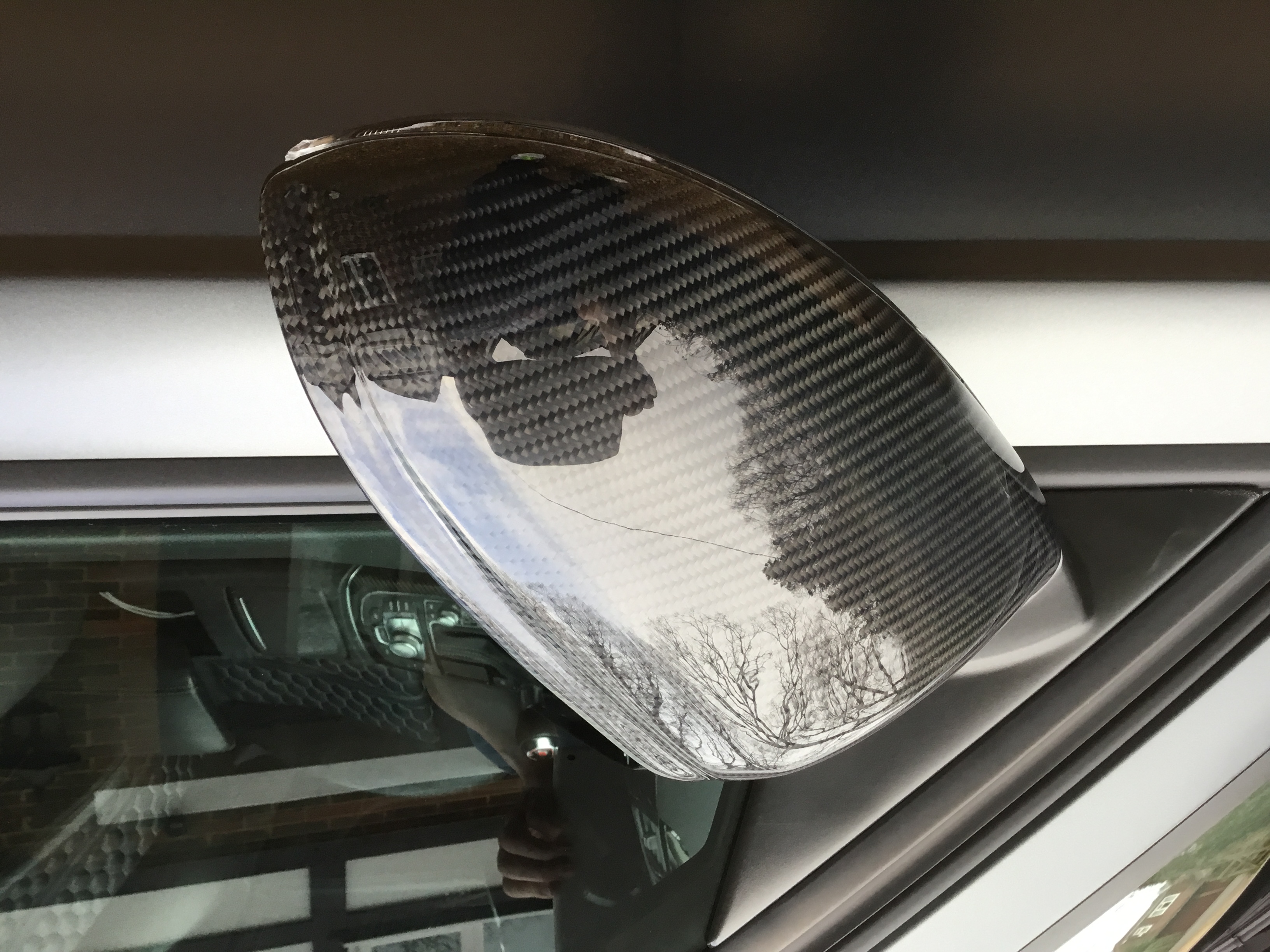

I had my mirrors wrapped on my C6 but this time I bought carbon mirror covers from Raywel designs.i will send you some pics tomorrow. The car needs a wash first

I paid a bit more than £140 but the fit was perfect as they carbon wrap a standard black OEM mirror cover which gives you all the connectors in the correct place

I got some OEM carbon ones for a decent price but the raywell ones look pretty good. They are easy enough to change over. Or you could wrap them. Wouldn't be hard; the B7 ones are hard to wrap but the C7 ones are only half the shell so much easier. Or spray them.
And you can wrap the roof bars with any joints, wouls be quite easy for a pro.

Thanks. Did you also do the side intakes in the front bumper?

No I didn't I forgot they were already gloss black. On the front it's grille surround and front splitter. Plus black Audi rings
Re: Officially on the hunt.....query on black / carbon optics
Why didn't you do the grille and front splitter gloss to match the side flaps?
