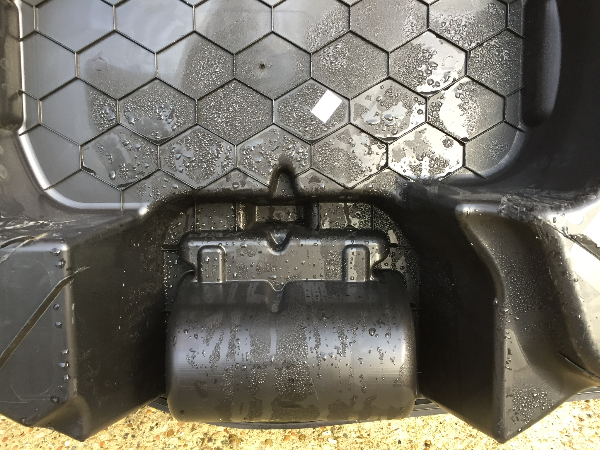

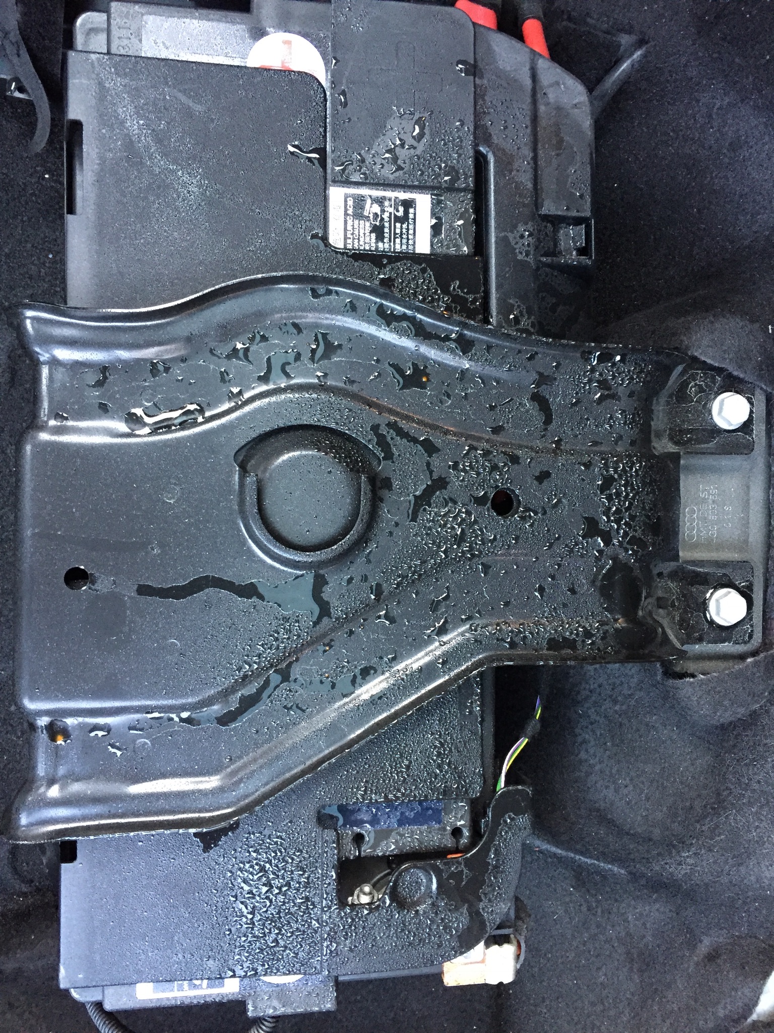

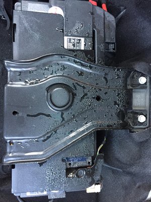

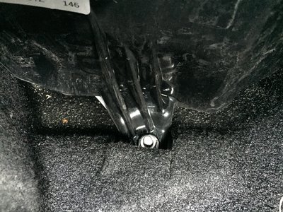

The joys of buying used !!!!! First day I've had since collecting last Saturday to have a good look round. By chance my sons car wouldn't start so I got some jump leads reversed mine up to his removed the plastics boot liner thing only to find the carpet soaked the tool kit full of water and the battery covered in condensation from the water its sitting in.
Any others had this ??? No sign of any water above on the carpet so not sure where it's come from?

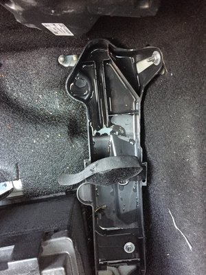

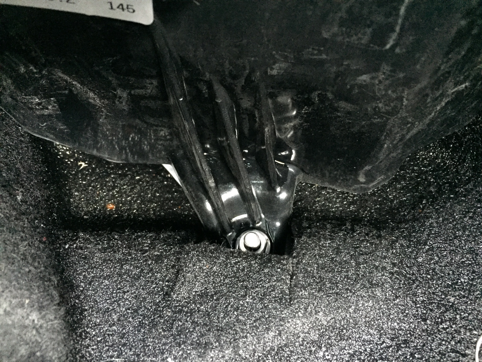

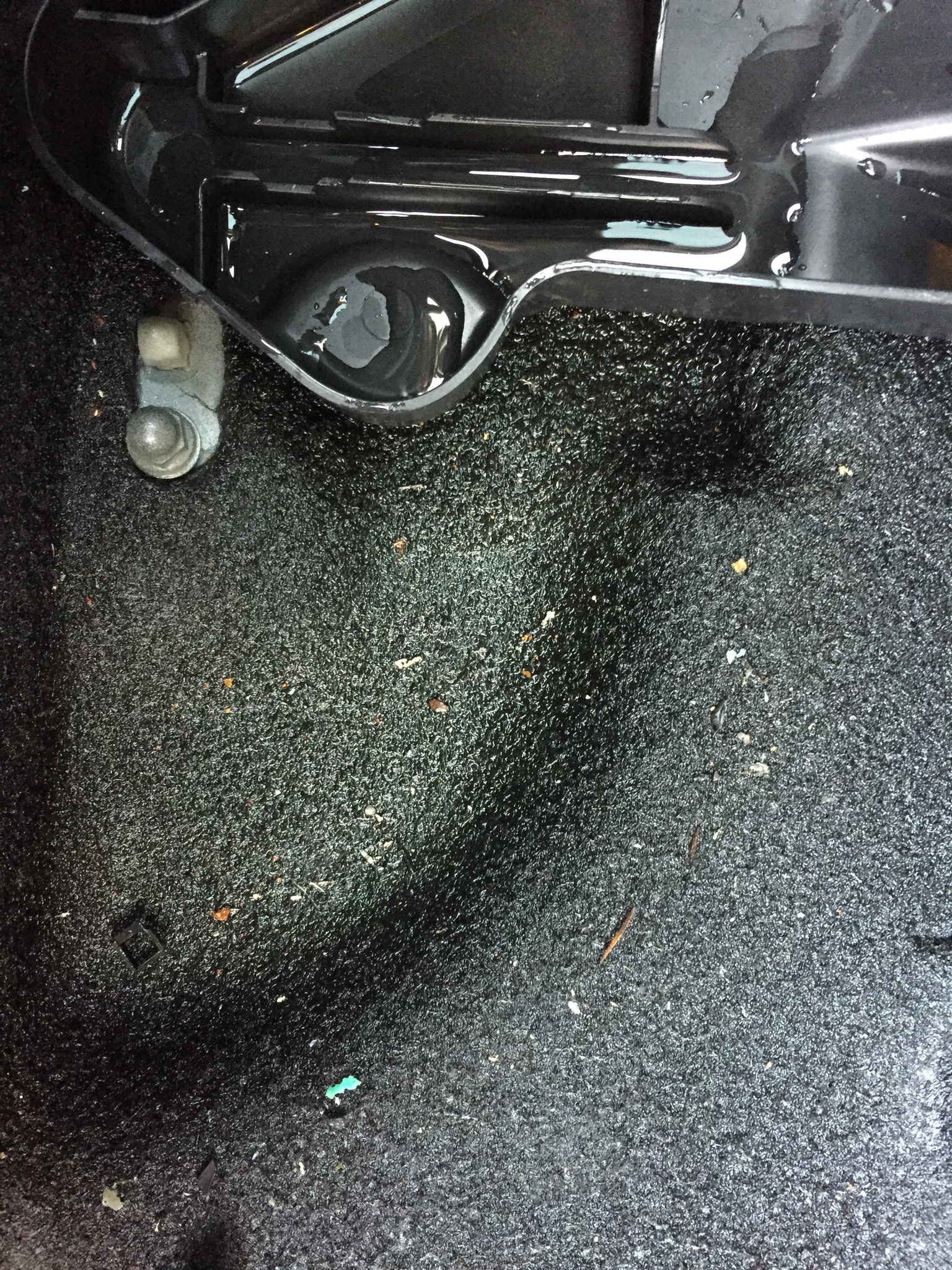

I don't know the answer to that. I took it back to Audi this evening. It's booked in next week to have all the rear stripped out dried/replaced. Then water test. When we lifted more of the carpet in the boot it was actually flooded right across about an inch deep under the battery. They were just about to close when I got there so I said I would start the process to at least get it dry.
It took me over an hour tonight to suck out most of the water with a large syringe with tube attached.
It's very strange as there is no musty smell in the boot the water is clear with no smell but did go slightly frothy when sucked up.
The way the tool tray and jack tray have been filled would suggest it could only have come from above yet everything above is bone dry.
It would appear to be a very recent ingress of water not over a period of time. Baffled !!!!!

Seem to have found the answer. I spoke to the previous owner today. The car had the ROS wing replaced a while back and it appears the light cluster and rubber gaskets haven't been fitted that well. Confirmed after water test today at Audi. Fingers crossed will all be sorted tomorrow and I can finally enjoy the car
