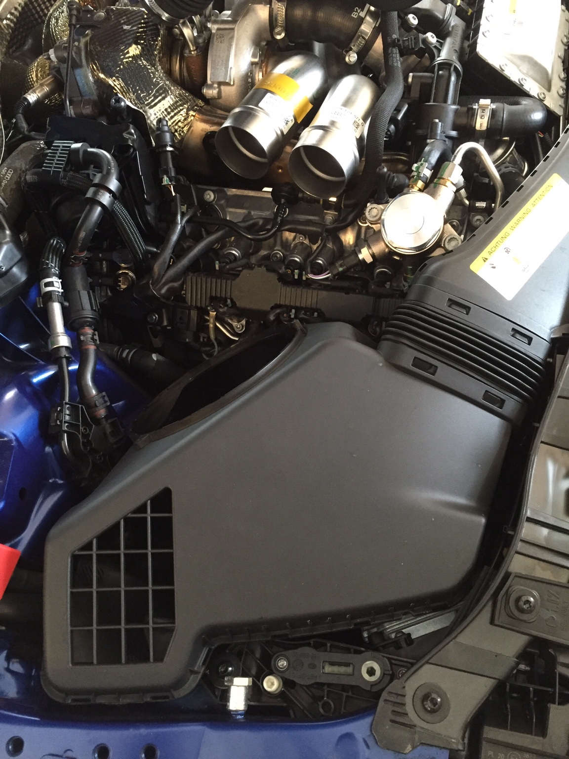

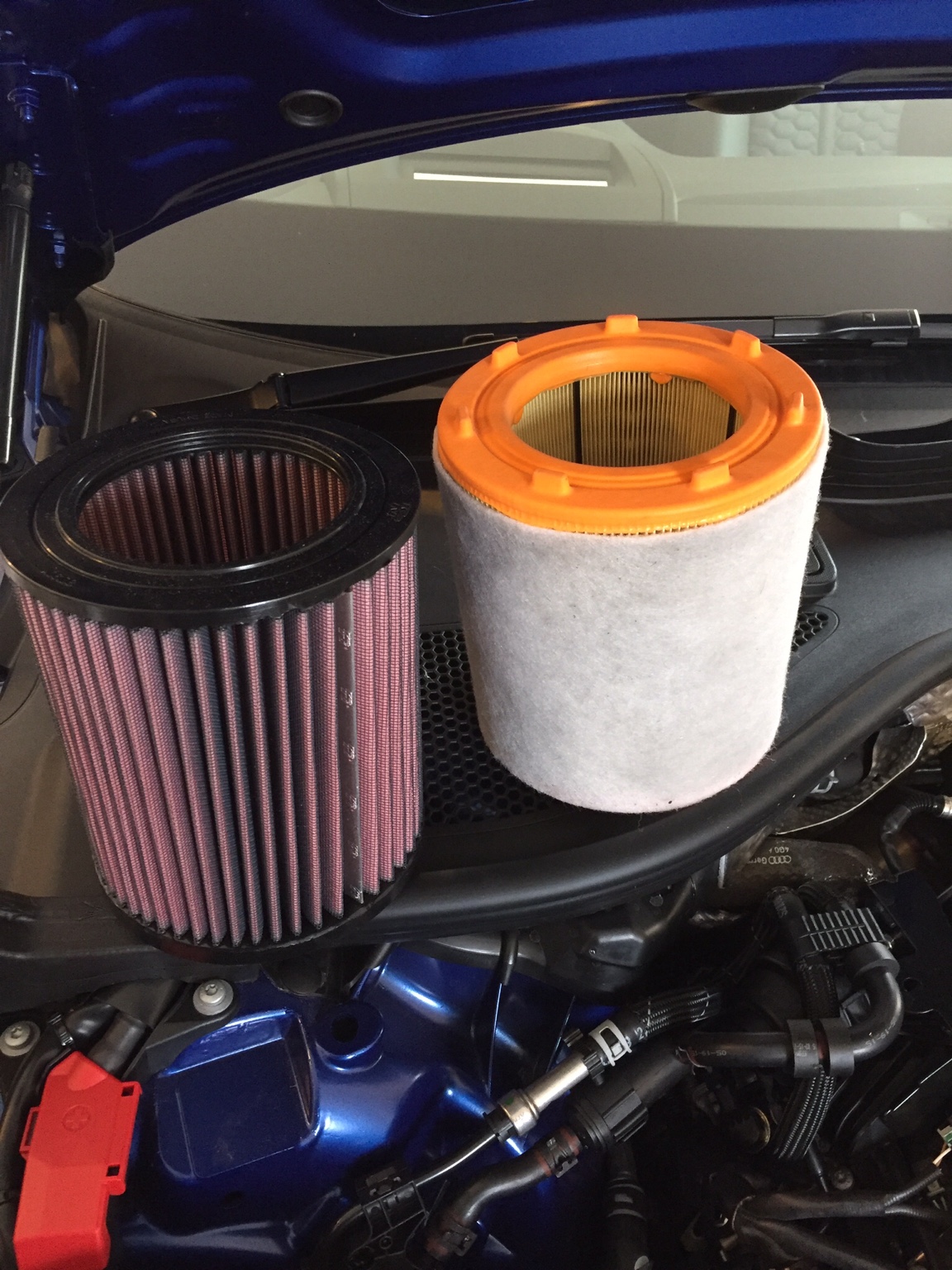

Standard vs K&N filter. Standard has a white foam sleeve which is removable over the paper filter, presume as an extra barrier for water in wet/cold climate. Simple mod is to remove the foam outer sleeve.
Airbox is easy enough to open but quite fiddly to get back together as there are some clips which are hard to get back in as the pipes restrict the movement. Hard to describe but off in a couple of minutes, back on is a different story.
