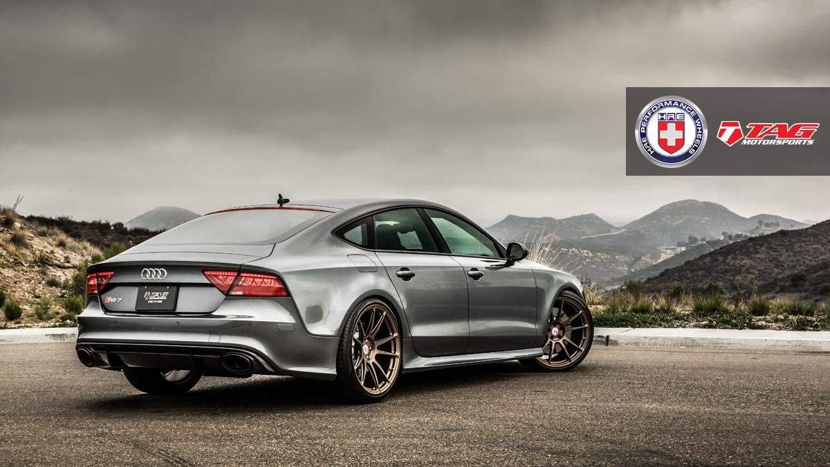

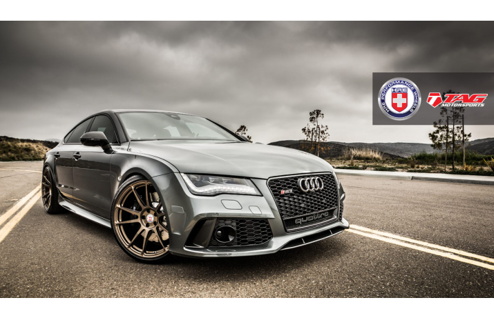

This is the result I am aiming to achieve but for RS6 application :

Love the concave profile of those wheels. As for Audi advice, I would bet their engineers would choose the lighter stronger 20's on smaller tyres for best ride / handling set up, no spacers and factory ride height. But if looks are your priority the cars look meaner with all that tweaked. You pays your money.....
