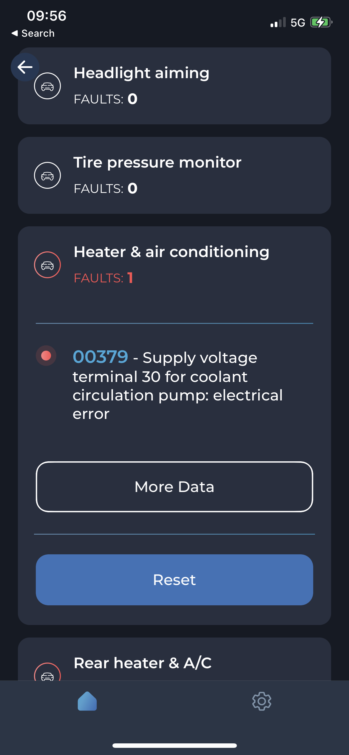

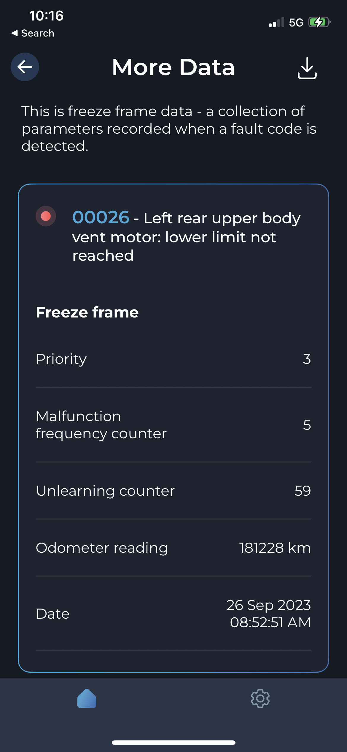

Thanks Morski, where those pipes are? More over I scanned today with carista and got those codes: I think I need a visit to my dealer. Also my front window is foggy when driving in a rainy conditions, only helps when using ac with to defrost window but it’s very cold inside a car
