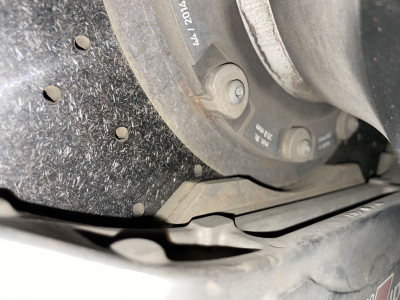

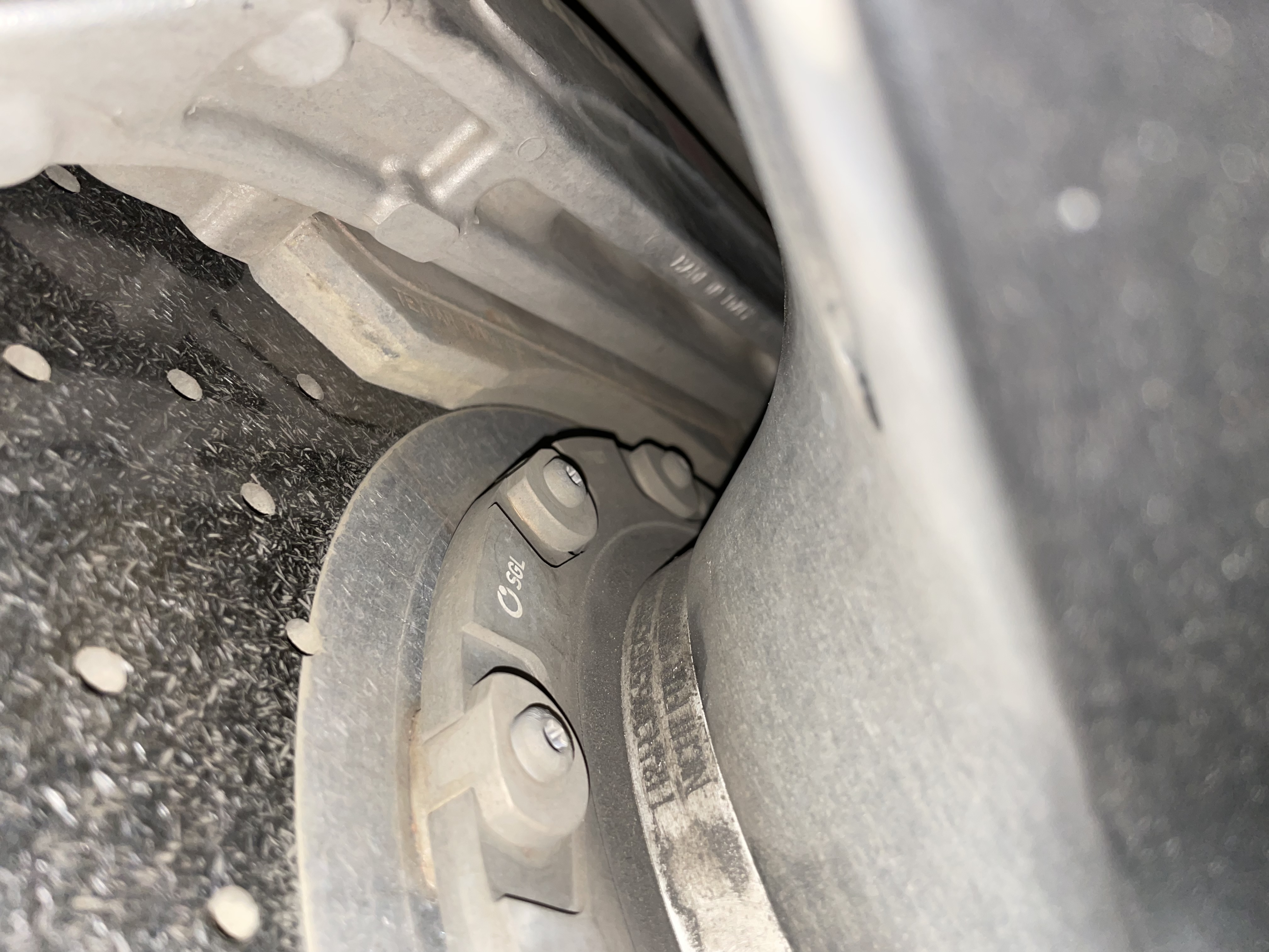

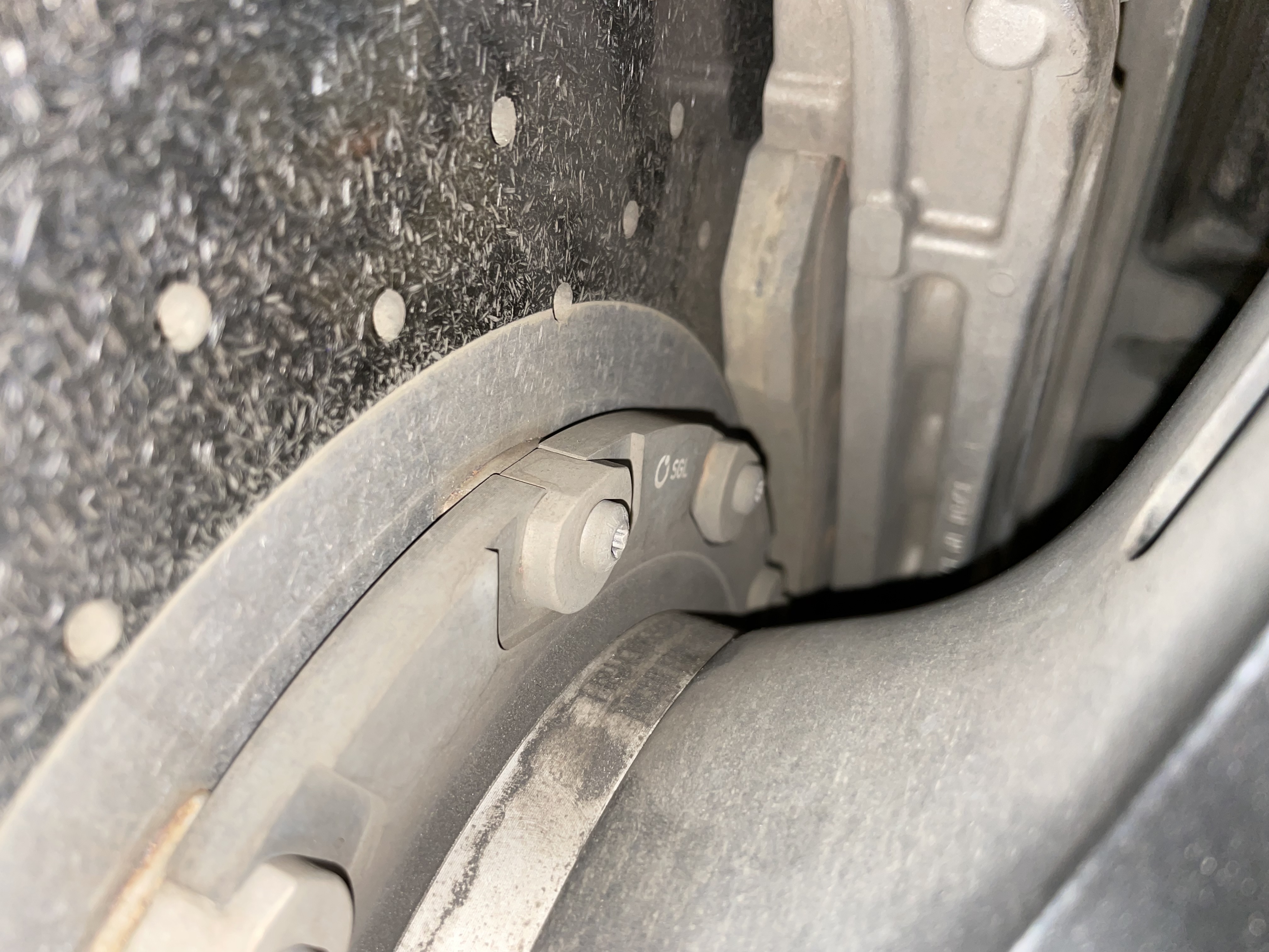

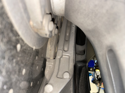

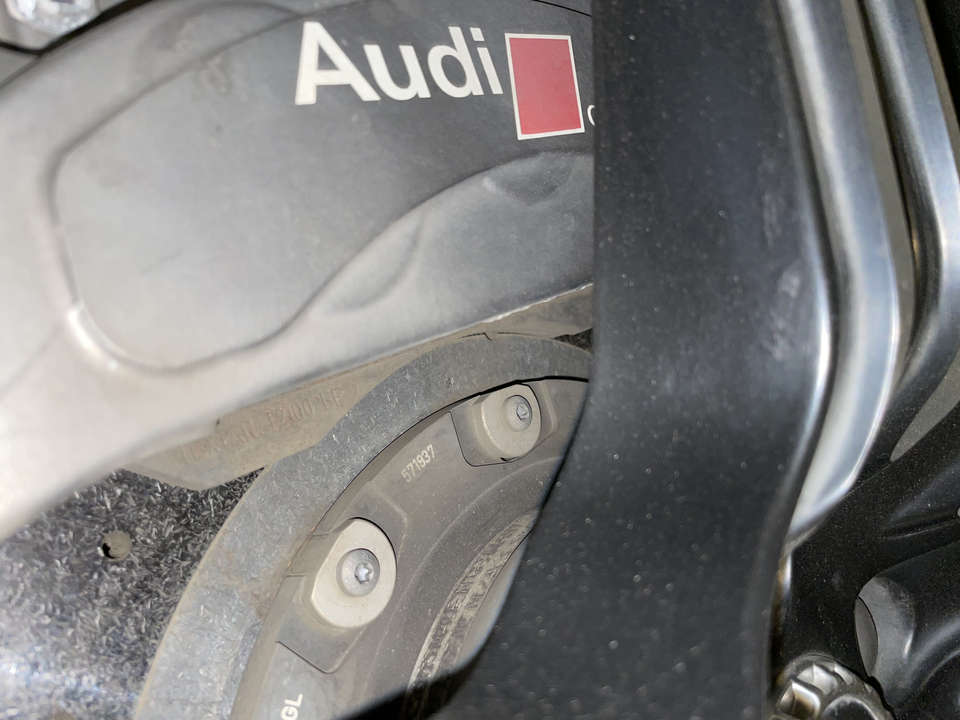

Post by Tadass910 » Thu Jun 03, 2021 11:49 am
Did some photos of my front pads, don’t know if it makes sense, maybe cleaning car and discs plus pads with huge water steam can solve issues, maybe it’s just a dust, because when I brake gently no squeaking at all
morski
Posts: 385
Re: Brake pads
Post by morski » Thu Jun 03, 2021 12:16 pm
Looks like you still have plenty of 'meat' aka pad material left on them so dont need changing yet. Look like about 50% life yet.
So you get no squeal when driving slow?
RS6 Performance Ascari blue, Carbon Ceramics, Akrapovic, H&R Anti Roll bars
